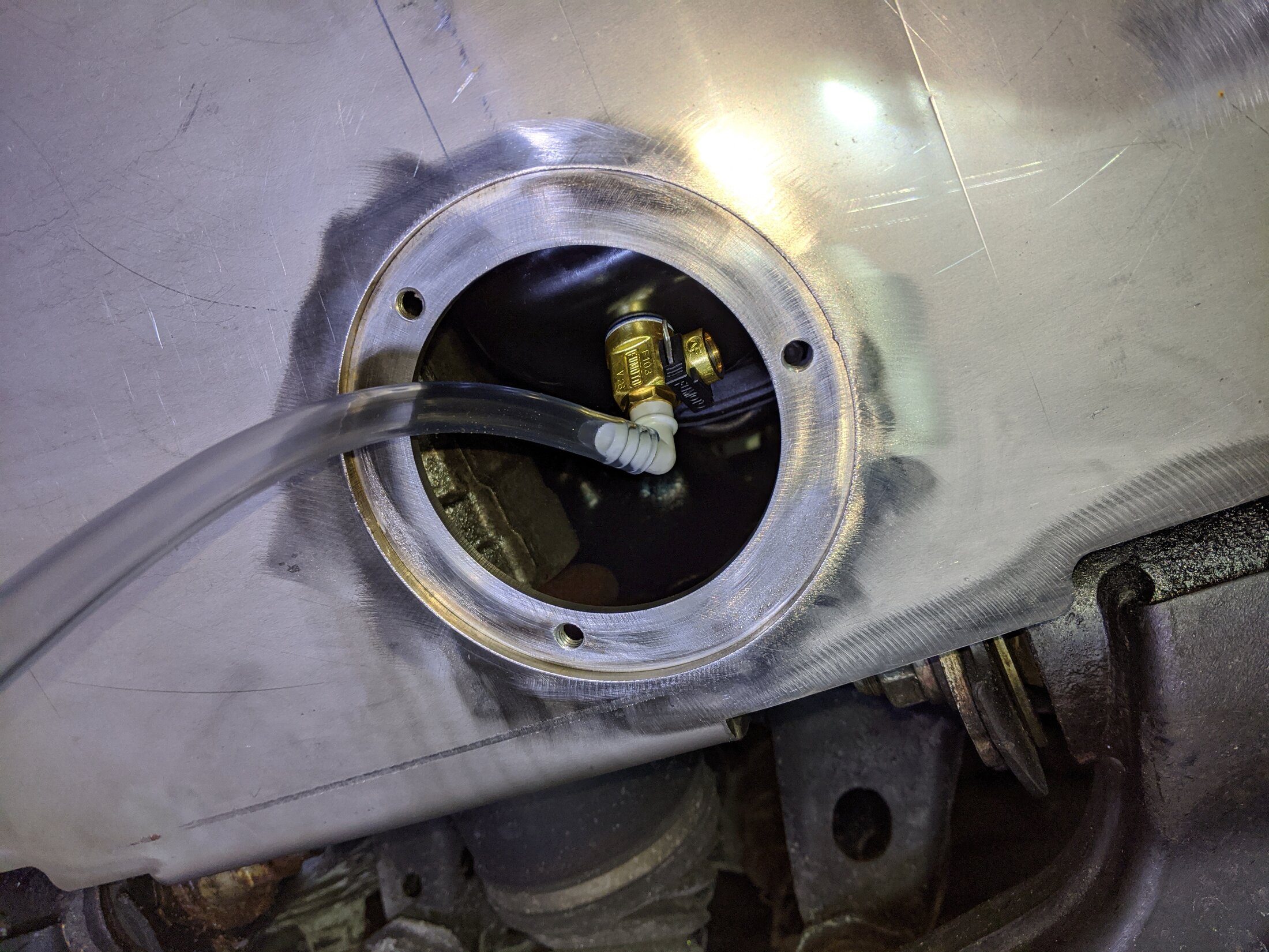

Looking to change the oil and filter, was going to switch to the Fumoto valve ... how difficult or involved is this gonna be with BudBuilt skids? Gonna have to drop, or can I get away with working in a tight space?
Pre install it is best to have something in place to direct oil flow downward as opposed to rearward flow. I used a plastic file folder curled to fit inside the skid opening, after new valve install this won't be necessary.

Get valve F103S
Then get the hose kit with the right angle fitting
Works perfectly with the access cover in the BB skid

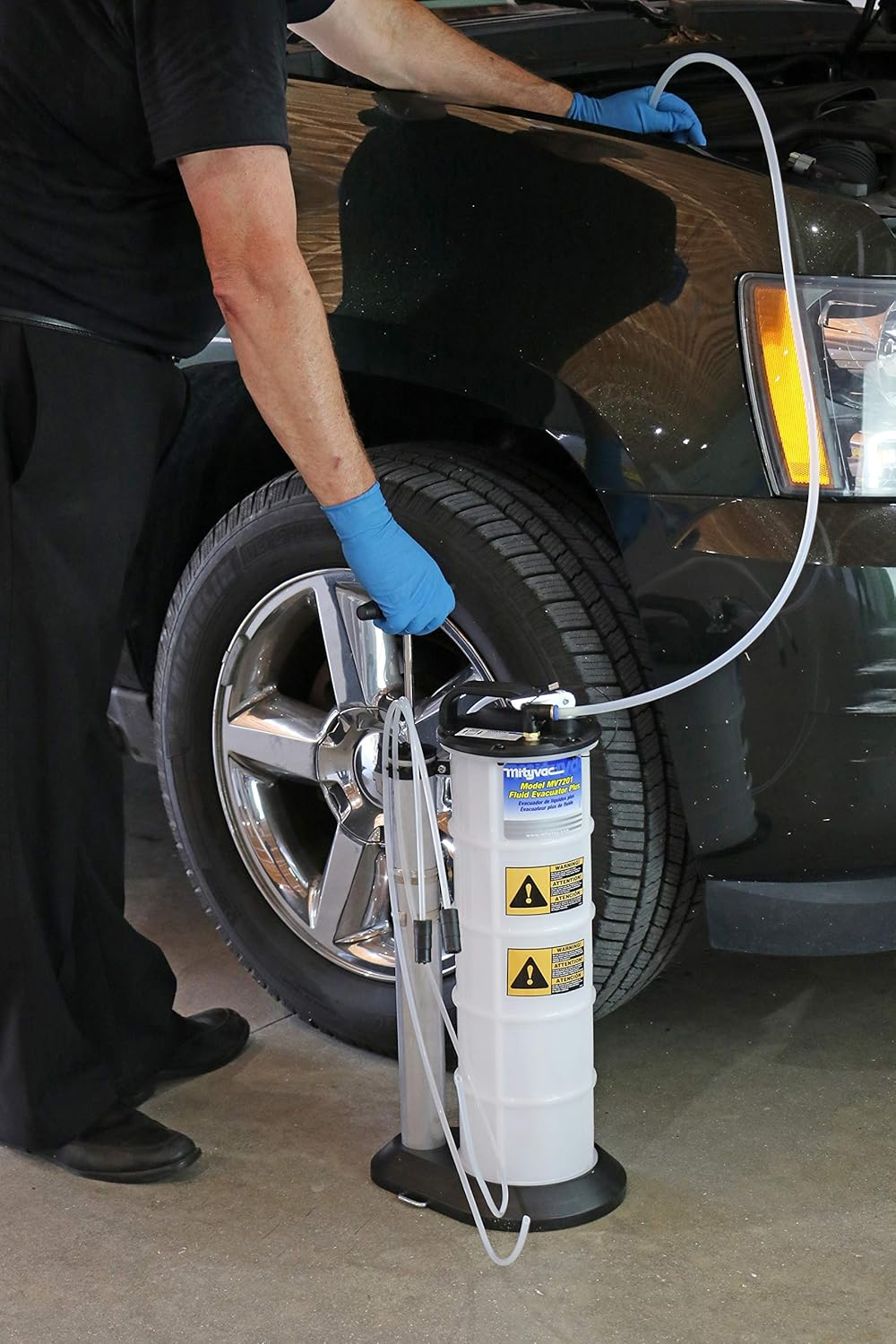

This is my favorite "drain valve:"
(Obviously not my pic...)
Available on Amazon: MityVac 7201 2.3 Gallon Fluid Evacuator
I have absolutely zero worry about an oil pan drain valve accidentally opening ;)
It removes every last drop of oil from the oil pan through the dip stick tube. The definition of easy-peasy.
HTH
Dumb question, does the suction needed to extract oil put stress on any engine seals?
No more than draining the oil through the drain plug. In other words, no, absolutely no stress on any engine seals.
The suction tube goes into the oil in the oil pan, then sucks until there is no oil left. All negative pressure is held in the collection chamber which is part of the extractor itself - no negative pressure is generated within the engine.
