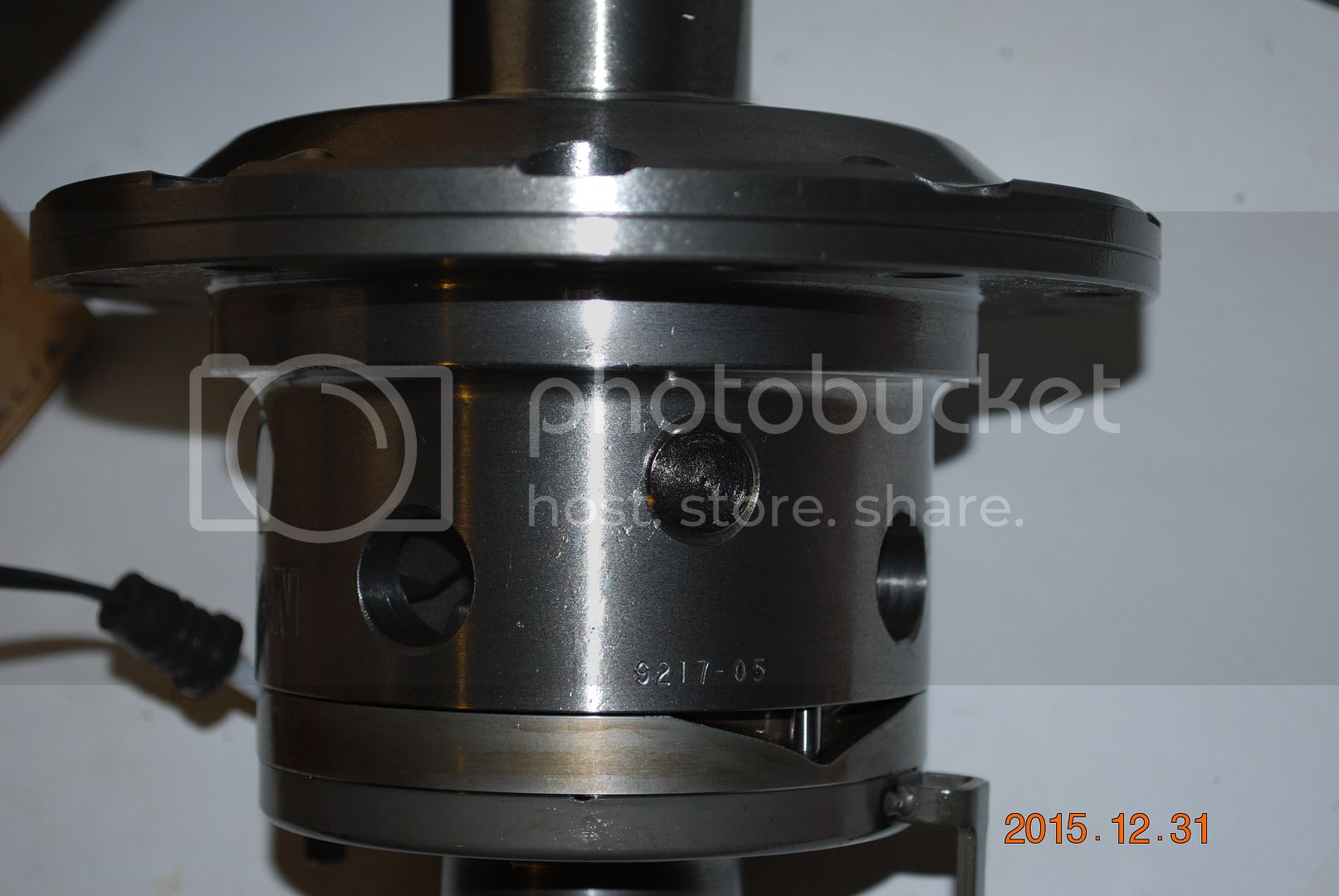

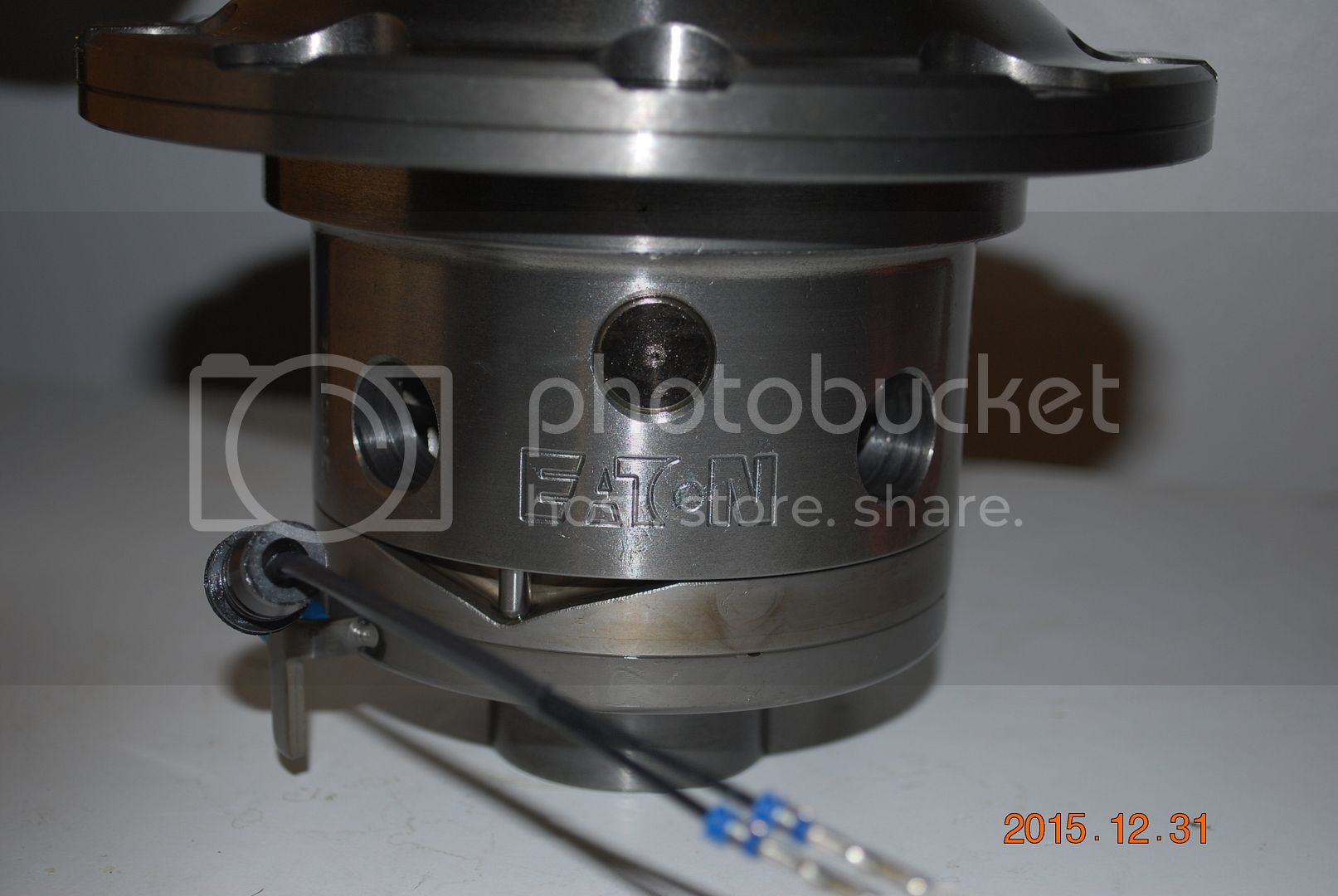

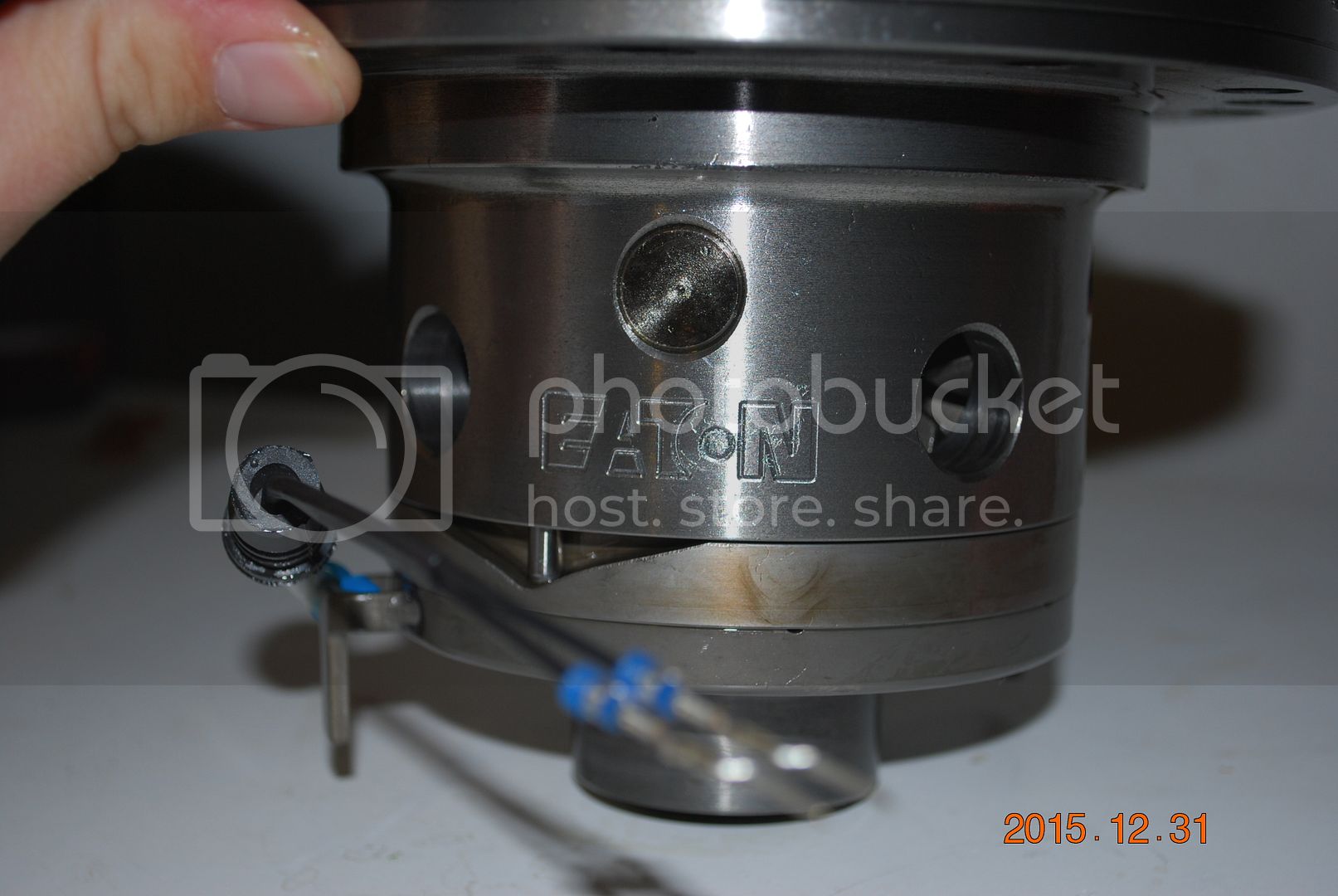

Dang...It's not even installed and I already love this thing! The machine work is great and it has a substantial "heft" to it. I realize it's a solid hunk of steel, but I'm quite shocked at how heavy and robust this locker is! :cool:

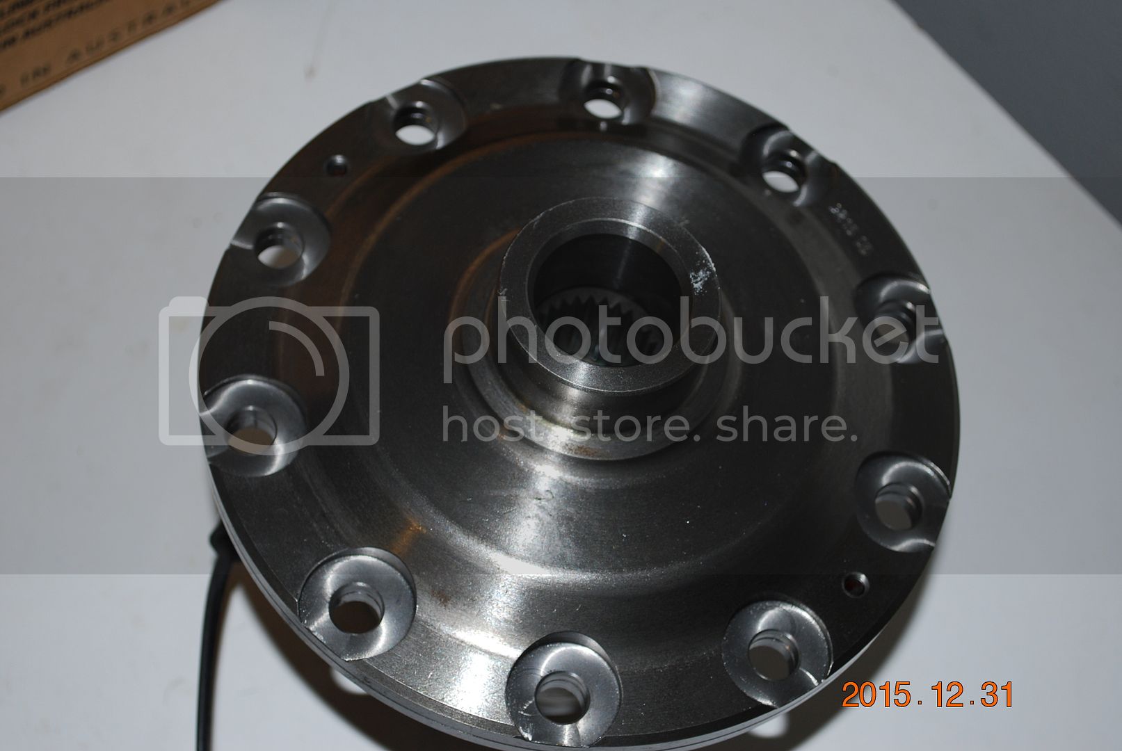

Whelp...I did it! After a couple years of trying to figure out the best configuration for adding traction to my unlocked 1994 80 series, I settled with a Lokka in the rear and just ordered a Harrop/Eaton for the front. I'm unofficially calling this setup "downunda locked" because I had to source both units from OZ.
I tried a couple of times (maybe 3) to score a locked front axle off various vehicles, but for a variety of reasons could not make it happen. Then I started to think "why the hell am I swapping out a perfectly good low mileage and well cared for axle for something of unknown condition"?
This led me to the ARB vs TJM vs Eaton debate and the simplicity (no air line...no compressors) and stellar reviews of the Eaton left me with only one choice and one problem.
The problem was that although I contacted every stateside distributor I could find, their prices were so high...I couldn't justify them over the TJM/ARB, but still didn't want a friggin air compressor in my rig. In short, I contacted a friend from AUS who scooped one up for me and with the US to AUD currency conversion in my favor, it ended up being roughly the same price as the air lockers.
