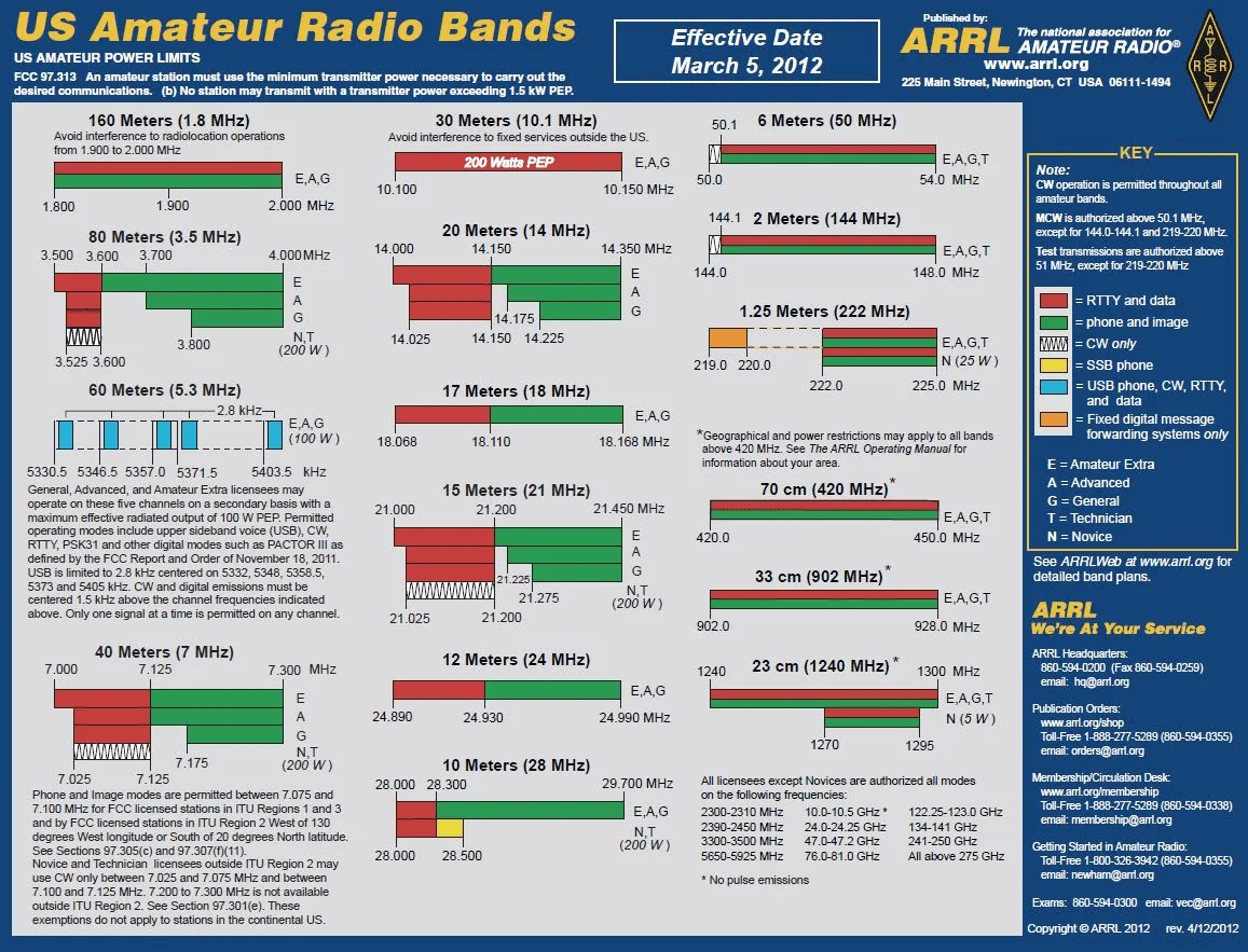

Also good call on HAM frequencies. I did not remember that 2m HAM ends at 148.00:

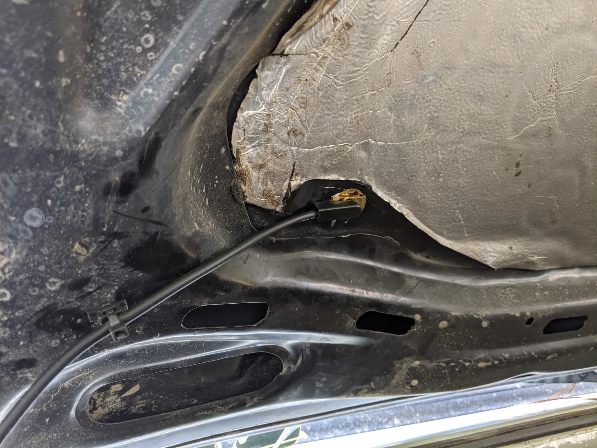

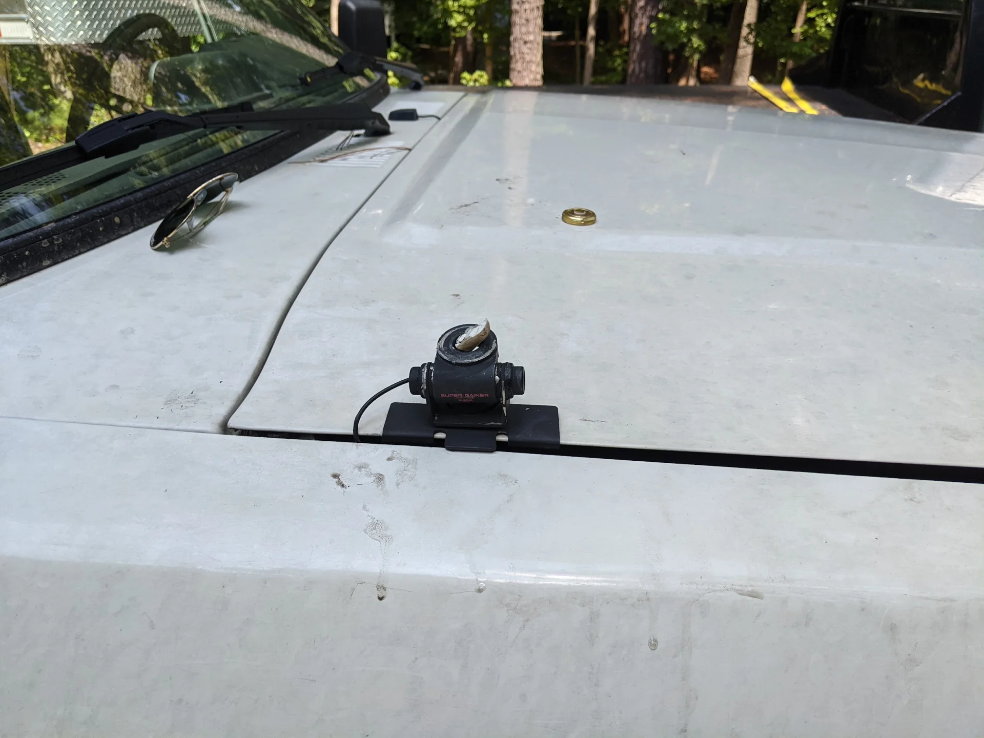

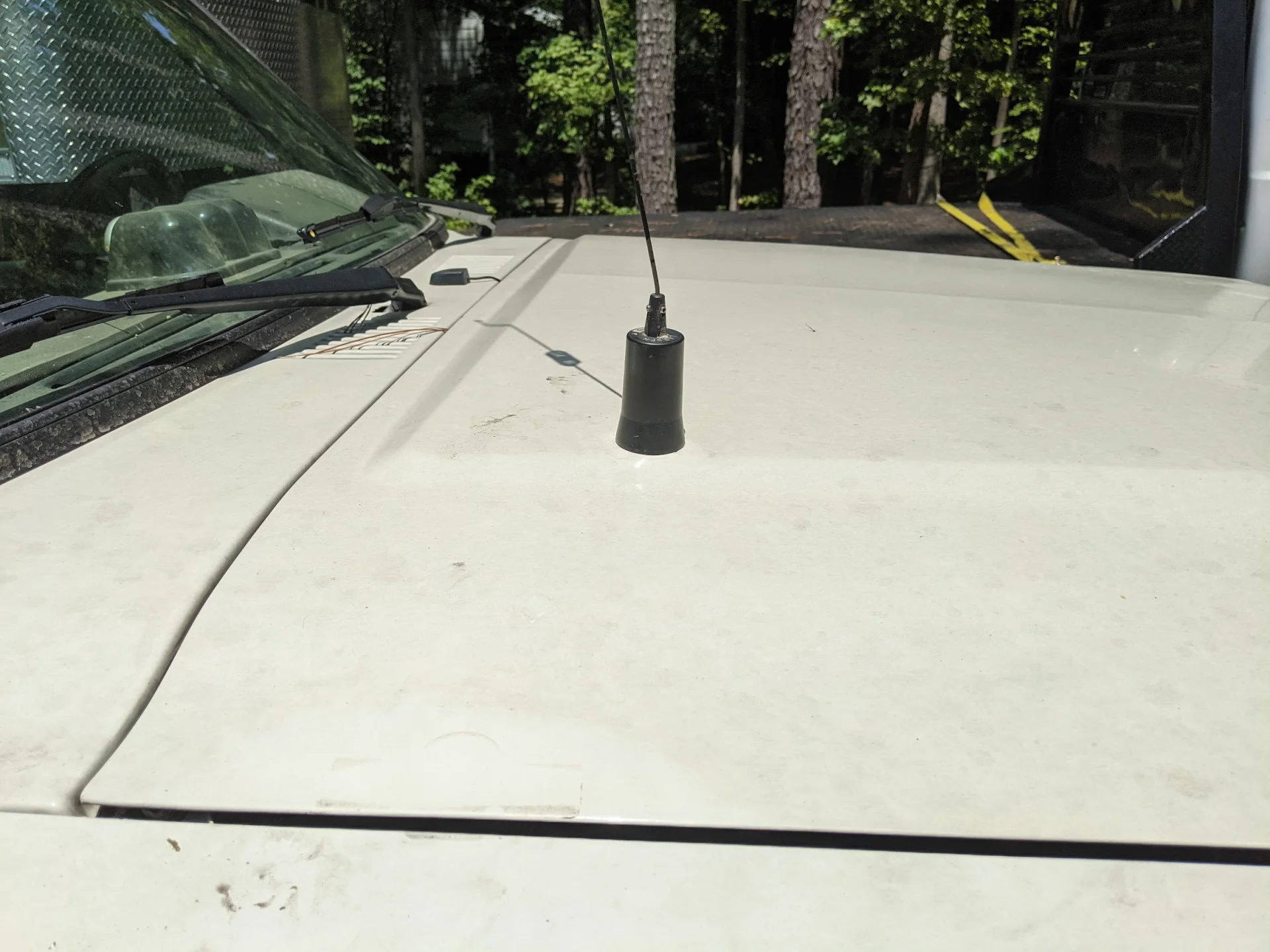

Quick antenna project. I had moved my antenna from the hatch to the edge of the hood last year because I felt like it, and I somehow ripped it off the truck at CMCC this year. No clue when it happened, but it was completely ripped off and somehow didn't damage any of the sheetmetal around it.
Found this new style that surface-mounts to sheetmetal, so I stuck it on the hood. Should be harder to rip off of this spot. Just drill a 3/4" ish hole, slot the lower half of the NMO mount through the hole, and the outer half screws on to clamp it onto the sheetmetal. Seems sturdy, we'll see how well it works.
