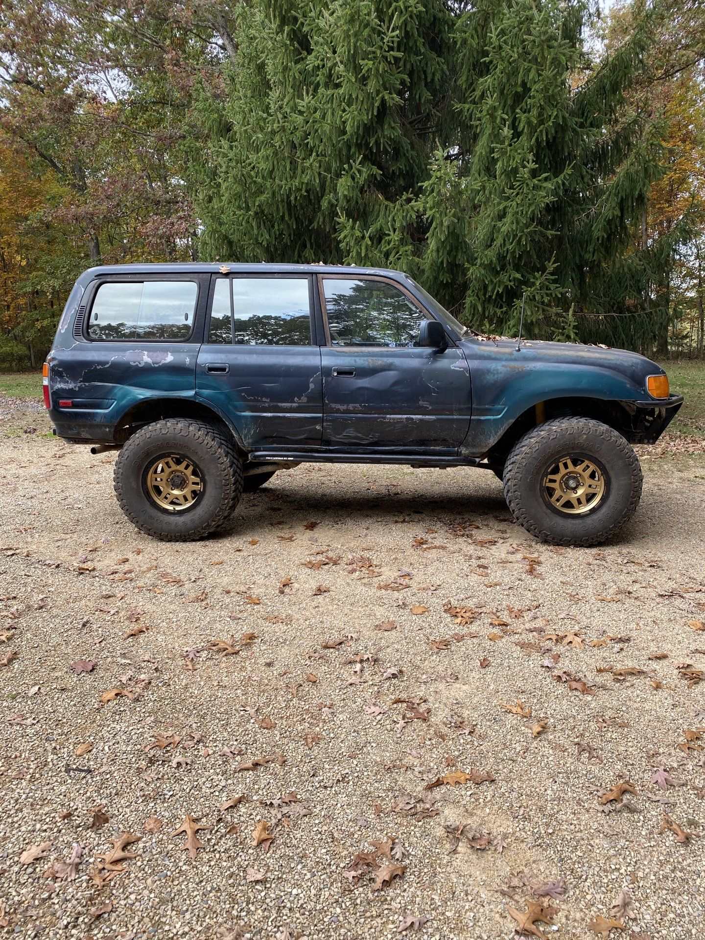

How much trimming did 40's require? Got any photo to detail the scope of fitting 40's?
Not much, don't have pictures but it was the lip of the front and rear of the rear wheel well to make it flush with the lining for about 6 inches from the bottom edge. The front I stretched forward and cut the front clip out in about 12" and up about 4".

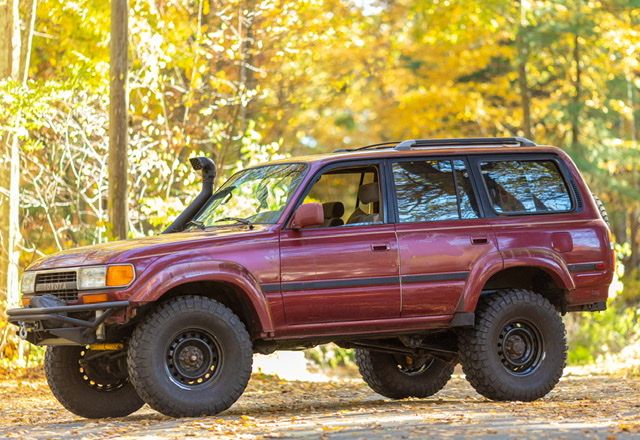

Finally get to contribute to this thread
Just picked up some used BFG K02s 37x12.5R17 and FJ Cruiser Steelies
1994 FZJ80
OME Heavy 3” lift (850J / 863J)
Stock Gears
No spacers
Haven‘t taken it off-road yet, so I am sure other mods will be required
I’m still using the acorn style lugs from my stock wheels which I am not sure is correct. Need to research this more.

what size are your tires?
1994 FZJ80
Stock Gears
No spacers
Acorn lug nuts on those steel wheels should be correct.
Nice backdrop for the photos!

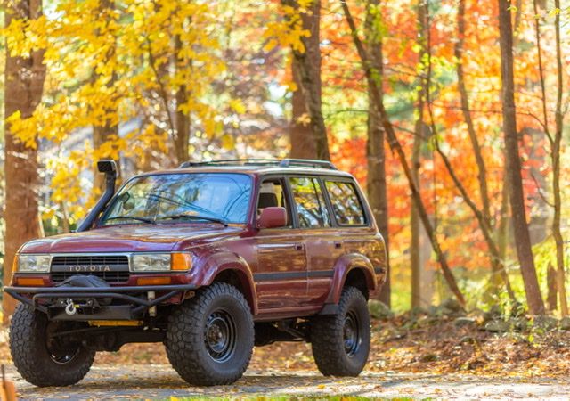

1994 FZJ80
Stock Gears
No spacers
Get sliders sooner than later. You only have to bend the rocker panel once by coming down hard on a rock and the doors will never seal right again.
