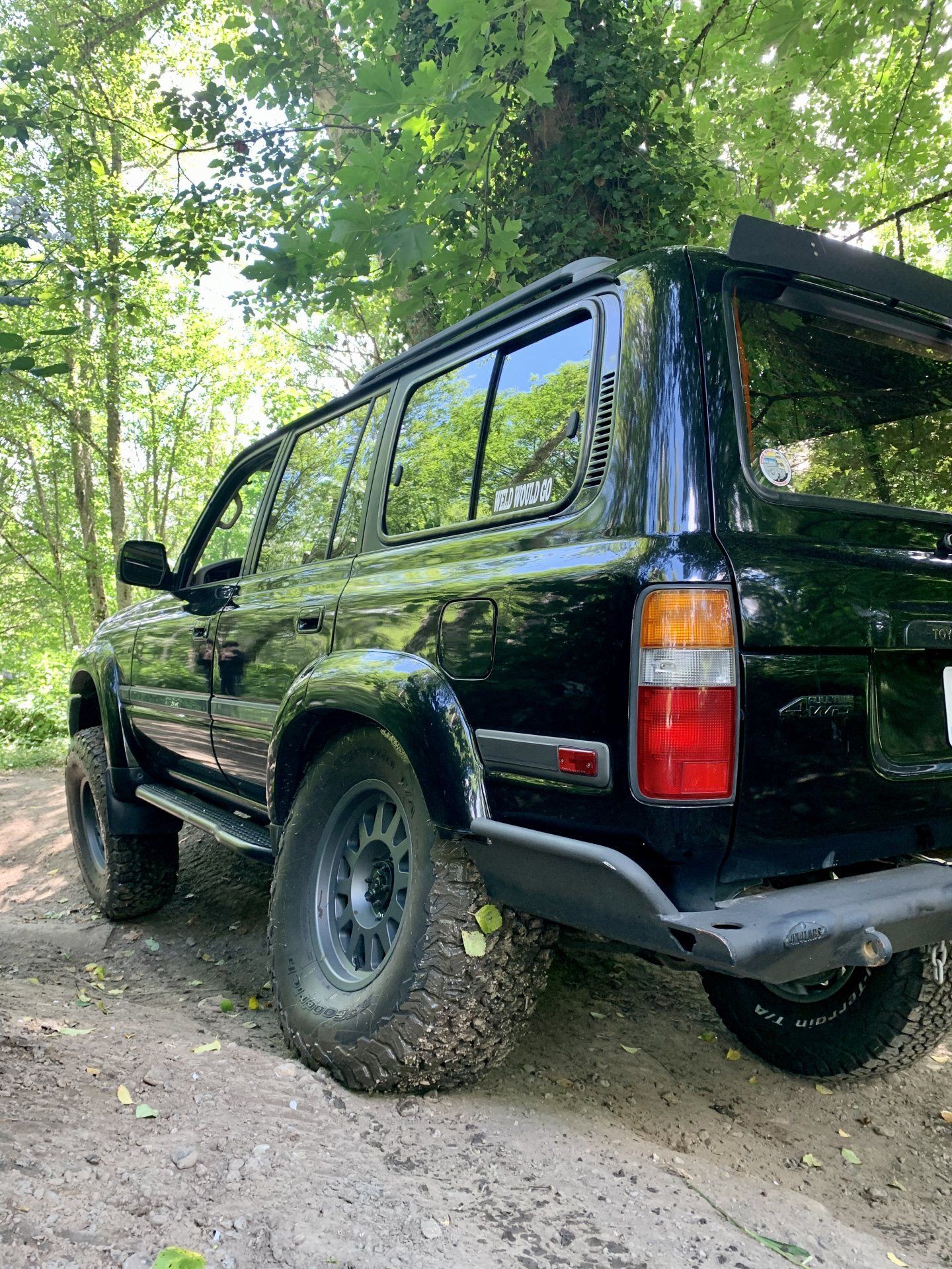

3” Icon, 17”x8.5” Method w/37”x12.5 BFG’s
Rubs on full stuff but not enough to worry about right now.

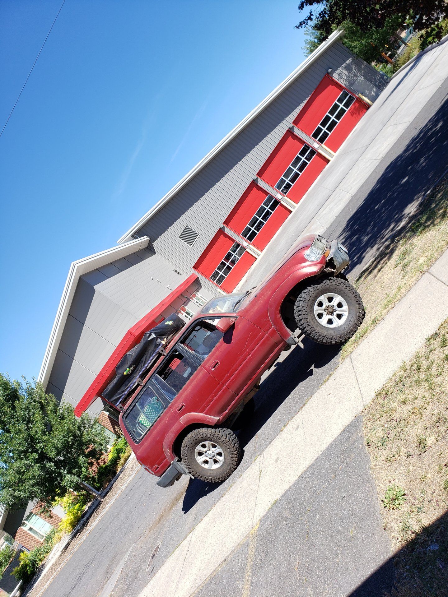

:lol: pic 2, is that a MT bumper that the wing flexed into that corner? I got the exact same dent while running my MT bumper.
Yeah, surprised it happened.
