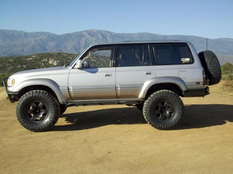

not a sexy shot but...
year: 1993
lift: OME-j front and back, unknown small spacer up front
shocks: racho 9k adjustables
spacing: looks like 1.25" of add'l spacing between hubs and rims
mods: (new since this pic) caster correction - the arms are nearly level now, noticable difference in handling improvement
wheels: 17" tundra/sequioa rims
tires: 37 x 12.5 x 17 KM2's, but taller since rim is narrower than most 12" tire rims
attachment.php
i need: front bumpstop extensions, as it will rub on drops with speed, or sharp turns under load into ditches.

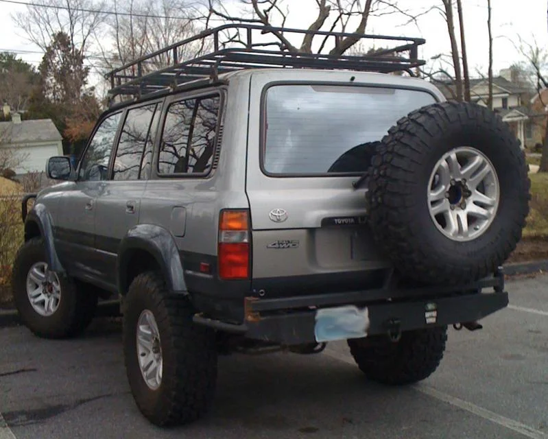

Year - 95
Lift - FOR Gen II (3.5")
Shocks - FOR Gen II
Bumpstops- 2" drops
Body Lift - None
Trimming - Rear quarters (for tube bumper)
Tires- 37x12.5x16 Trxus
Rims- Stock
Spacers- 1"
attachment.php
That front driver side tire is now retired and going along for a sight seeing ride on the back of my rig.
