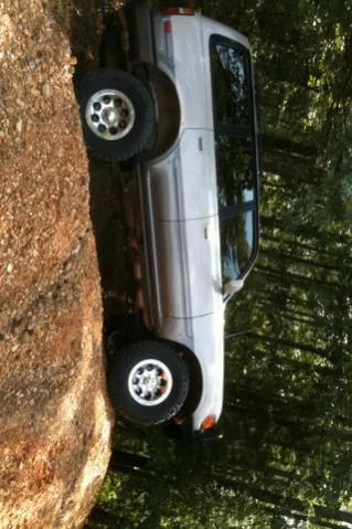

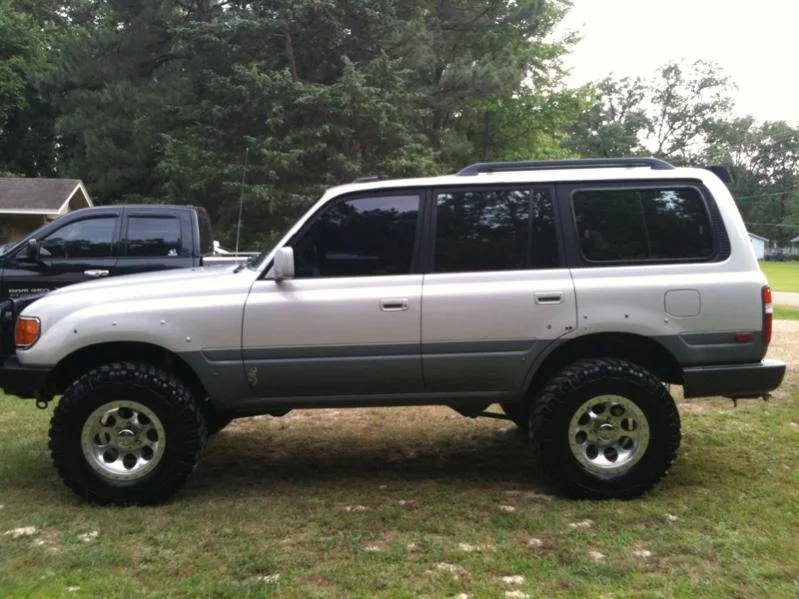

wanted to share a pic now that im done trimming the fenders and quarters. Ironman TOYO24B front springs, Stock rear springs.
i finally had to concede the point and drop the rear bumpstops just a bit. with the BS and the side lugs on these rockers i just couldnt clear the quarters on straight compression. articulating it was ok. i ripped off my stock bumps on my second trail ride. and got into a my pass door on a night ride the following weekend. my sliders are laying the back of the truck. good place for those. i have since replaced my bumpstops with energy suspension progressive bumps. much better than the abrupt hit of the stock bumps.

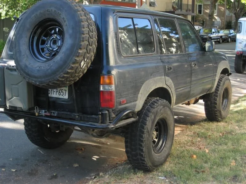

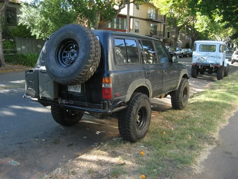

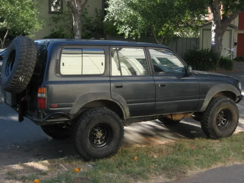

Just got these mounted up on the 4wp 4" backspaced steelies.
The 37x12.5x16.5 military MT measure about 36.5 unloaded on my tape measure. these put the ground to door measure at 24"clearance without that rocker interfering.
i did some stuffing of front and rear to measure the shock lengths im gonna need...............and very minimal clipping of fenders with 4" backspace (were talking millimeters) ---so should be some easy trimming without any need to get into the inner fender hump. Im running OME 2.5med w/30mm MAF spacers up front and slee 10mm ones in rear. Im pretty light (5100lbs on my old 33.5s.) These puppies are heavy tho!
Is it me or do they look small???

Man, I've been thinking about those wheels, glad you posted this. The 4" backspacing looks right on. Been really tempted now that the military BFG Baja's are out in surplus.

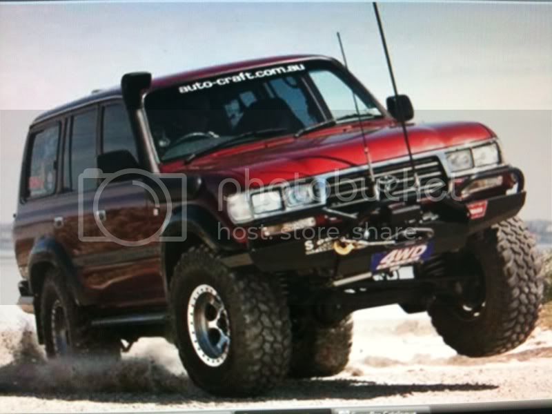

ROOBY
1995
37 x 12.5/17 PRo Comp Xterrains and Muds.
17 x 9 Pro Comp rims and Allied Rockathons.
4.56 diff gears and 20% lower t case gears.
Slinky long travel 3"lift
40mm bump spacers
moved front control arms forward 12mm
made some room with a mash hammer neatly.

One of my most favorite, well-designed 80 series rigs out there...
Nice work Darren..
Thanks, It was a neat truck, and a step toward the changes for the next one, which Im looking forward to building.
This is one of my fav shots of ROOBY, a 8500# truck, on 37's, chucking sand out the back on boost, in high range from all 4 wheels, thats just what that truck was, point and shoot, and fun to drive.
