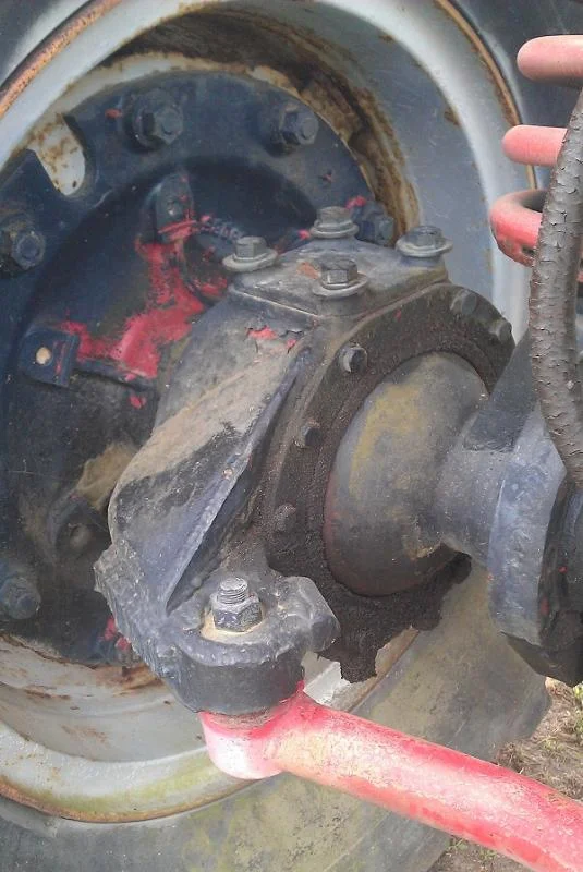

the 37's looking tiny against an older gen GraveDigger with 60+" tires...
oh, and biggest birf's i've ever seen.

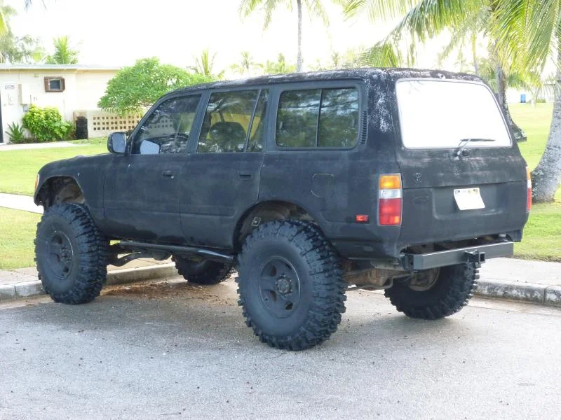

in the process of retiring the old pickup from weekend wheeler, retiring the cruiser from DD status to fulltime wheeler, and getting used to DD a 3rd gen runner(feels like driving a pogo stick compared to my smooth, heavy 80, but easier on the wallet).
test fitting my 37x12.50/17 pitbull radial rockers on 17x8 soft 8s 3.5" custom backspacing. ironman 2" front springs/stock rears. hitting the trail next weekend:
pulling off the front fenders for minimal trimming. rears quarters will get the lip trimmed. bumpers trimmed/removed. we dont have huge rocks, but really tight trails and off camber climbs where the low COG will come in handy. im okay with this thing becoming a raisin, its not very clean to start with. job moved me out of town so i havent been able to chop the roof yet, coming soon though. headed to the badlands for the first time in August. should be a fun time.

That's sick.

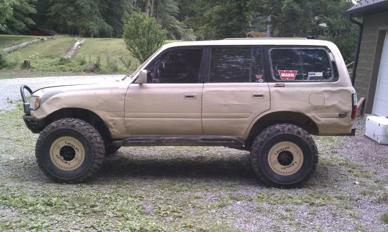

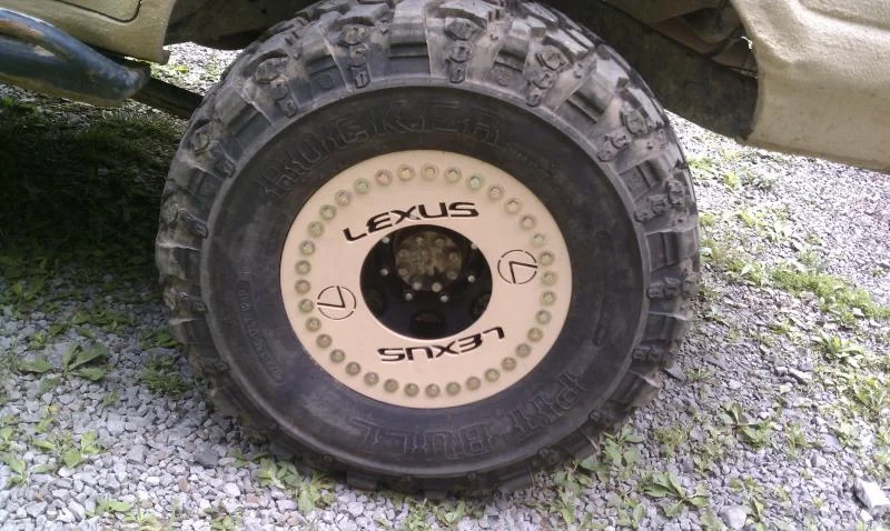

37x13.50 bias rockers on 17x9s
Holy awesome lexus!!
I was just up in your neck o' the woods climbing on Summersville Lake. Wish I woulda known there is badass lexus just down the road.

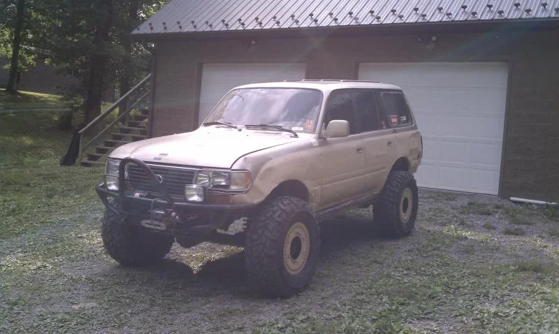

WSPASTORBRYAN...Thanks!!! ive been trimming my fenders/quarters and modifiying my inner fenders after work so i will have some new pics to post up soon. im so close to stuffing these tires on stock bumpstops. 4" BS would make this easier but id rather have the width. I still have about a 1/2 inch till im on bumps front or rear. just a little more modding is necessary.
testing wheelwell fit as im trimming:
the front ive trimmed a good inch or more and pie cut the inner fender and beat it up to match the new opening. the rear ive cut considerably and i have to tack the inner quarter to the outer again and smooth things out. the i still have more smoothing out to do on all the wheel wells, im just trimming a little at a time so i only take whats needed.
The rear is just easier to fold the whole thing over. At least that's what I did - seemed if I was going to do all the work, was going to get as much room as possible for anything that might come in the future. Be careful welding that area, a little burn through can cause a big fire (personal experience).
