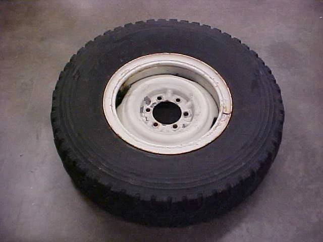

1. Remove wheel from vehicle
2. Remove any access air from tire (important)
3. Mark where the valve stem is on the tire for reference. Take a good look at how the ring looks seated against the wheel. It needs to look the same when you put it back on.

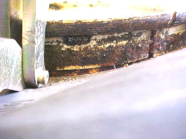

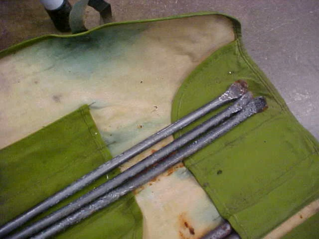

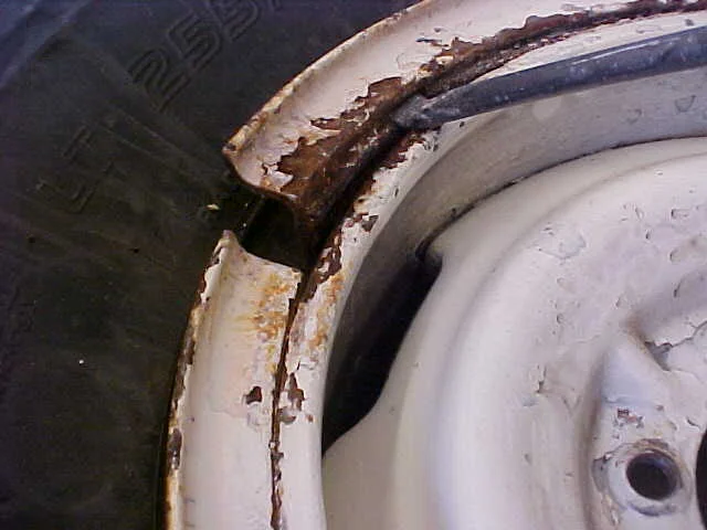

4A. With tire removed and fully deflated find an indent on the ring where it meets the wheel. Stick your claw bar in the indent and hammer it a bit so it digs in. Use the wheel as leverage and pry the ring up and away from the tire/wheel.
4B. If you have Tyre Plyers you may need to use them if when you put the tire together last you did so when the paint wasn’t fully cured as well as if the rim has some rust because this will prevent the ring from easily coming off with a claw bar…basicly breaking the seal that has been created by paint or rust.

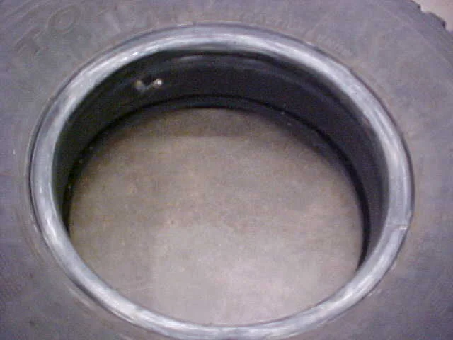

8. Remove tire flap (a protective rubber ring the sits between the wheel and tube) If its there. Sometimes it isn't.

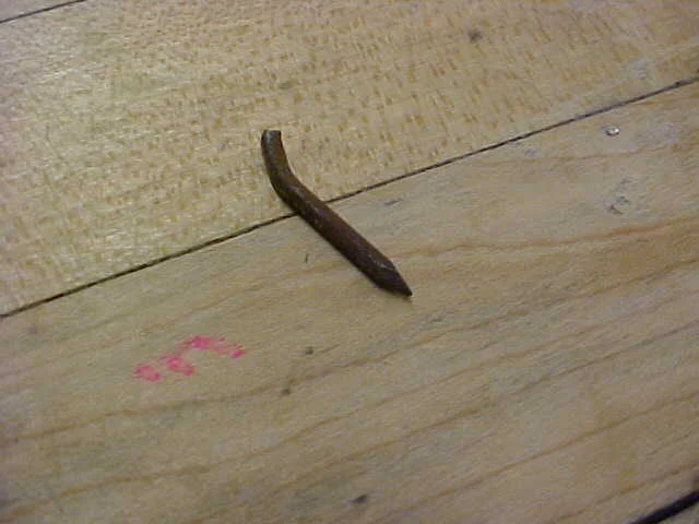

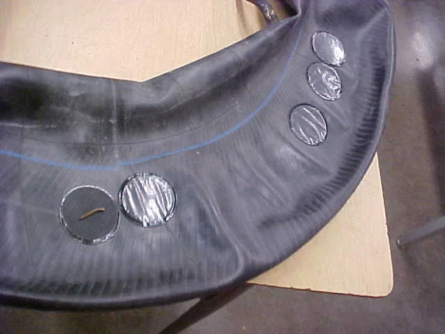

9. Remove tube air it up and spray soapy water on it. Find the leak. Patch using the scraper and vulcanizing fluid.
I found this in mine:

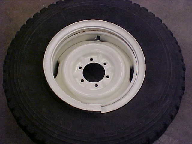

14.Now place the ring on the wheel. For reference start putting the ring on 180 degrees from where the valve stem is. Basically opposite side of the wheel. You want the split part of the ring opposite the valve stem. Force one side of the ring down into the groove once it catches start tapping the ring around the wheel until you have gone all the way around.
15.IMPORTANT VERIFY THAT THE RING IS IN THE GROOVE ALL THE WAY AROUND TAP ON THE OUTSIDE OF THE RING TO MAKE SURE ITS SEATED.

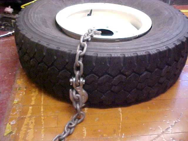

16. Time to air it back up. This is where people get hurt if you haven't done it right. Tire shops use tire cages to air up split rings. You can do several things while airing it up. Wrap heavy chain around the wheel like a figured 8 making sure both sides are wrapped...my chain isnt quite long enoght to wrap in an 8...a single chain is better then none at all. You could also place it under your vehicle while airing up. Worst case when airing it up aim it away from you.

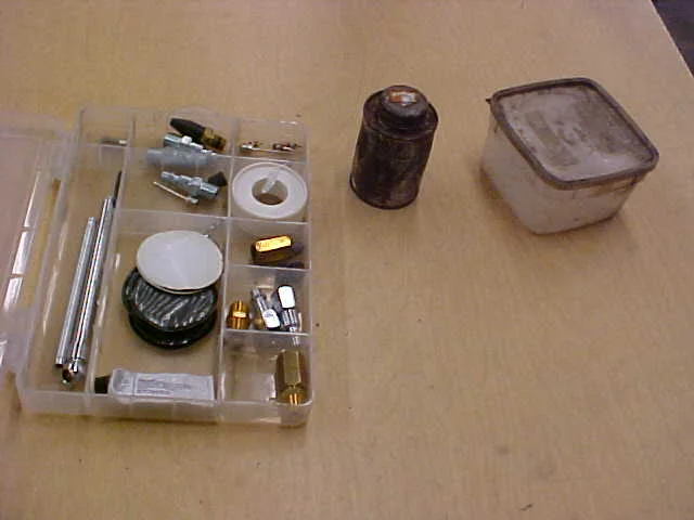

This is my kit for repairs
patches, rubber cement (tin) and animal fat (old truckers tip)
animal fat around the bead will make for a nice sticky seal...to prevent rusting on the bead area and help not having paint stick...i dont usually use it...put..i thought i'd throw that out there to those who may want to use it :)

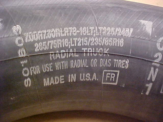

make sure the tubes have tr150 valves (see here: http://www.transamericanrubber.com/i...es/valves4.gif )..theybend nicely and are not too long not too short, the valve on the tube needs to be "off center" not "on center" as i remember my tubes were 750r16's
MAKE SURE YOU USE RADIAL TUBES AND FLAPS WITH RADIAL TIRES AND BIAS TUBES AND FLAPS WITH BIAS TIRES
