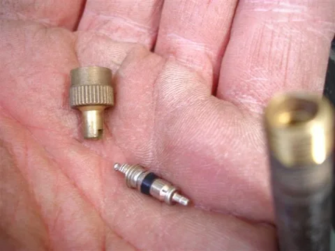

Remove the offending wheel and remove the valve to allow all the air to escape easily:
(All my valve caps have heads for valve-removal.)
