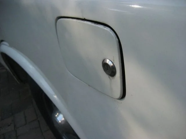

Charles; here are pix of the problem; ended up getting a locking fuel door to solve the problem thanks again to Ige :)
the locking gas cap can be used and will fit the filler neck but then you cannot close the door; it is quite a bit wider than the aftermarket autozone I have on..........pix show the interference with the fuel door; you can see the size difference;
maybe the ones that Marshall has found won't have the problem or maybe it is only on my 74:confused: any comments??
I wonder if the filler neck on mine was pushed to the inside of the truck enough (there is some slop if the bolts are loosened) to make it clear as it looks like it must be really close!

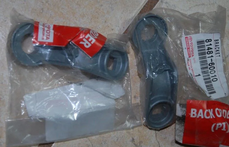

Question - can I mount those w/ my PTO winch?
I think so. I have a pair mounted on the bumper of the '45LV right now next to the winch. I have not looked at the FJ55 to see if it is possible though.
As long as there is a bumper bolt there you should be good and I'm 99% sure there is one on the outboard side of the '55 bumper.
I have a spare set of these mounts if you are interested.
