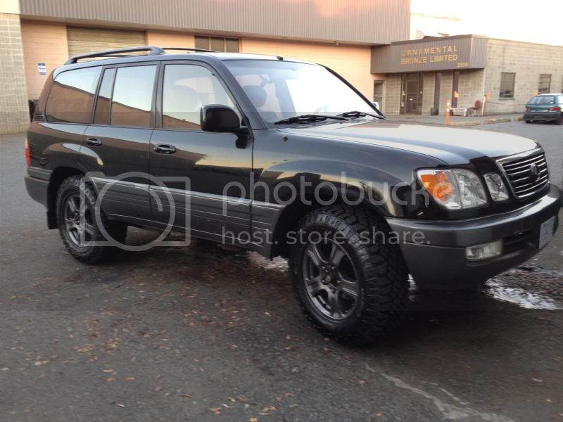

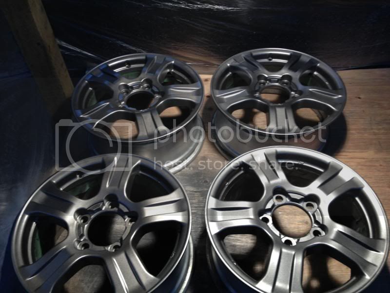

Not long after getting the truck I ditched the step rails, picked up some tundra rims off craigslist, rattle canned them and mounted duratracs.
I didn't have to drive off pavement for very long before deciding that some rocker protection was in order. I went out to see Jason at Cruisin' Offroad who set me up with some sliders.

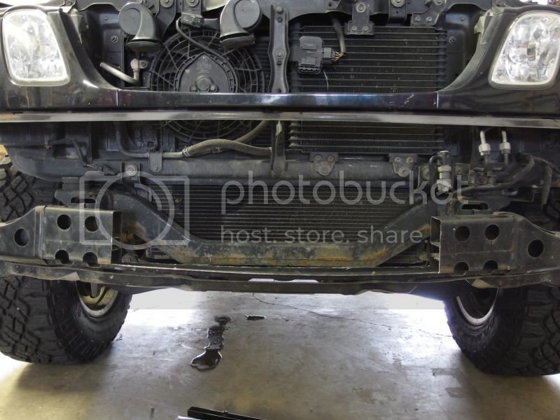

While I was there I mentioned that I would love to have a hidden winch installed. Jason took a look and some quick measurements and thought it was easily doable. I planned to run it by my wife and get some more money together, thinking I'd be back out to see him in April. It took an extra five months.
Last wednesday I popped across the border, picked up the winch and go out to CO's shop around 10am.

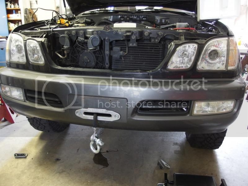

We figure that the whole thing weighs in around 90lbs. I'm hoping to run the AHC until one of us dies so I really wanted to avoid an aftermarket bumper.
I can't say enough good things about Jason and the work that he does. I showed up, hung out for an hour, went for a bike ride and the mount was basically done when I got back. All from scratch. I'm so happy about this that I can't stop gaping at it. My passengers like it too.

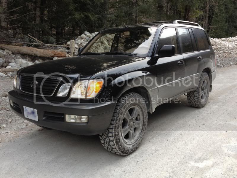

How do you like the 18s off road?
Awesome job on the front winch mount. That is really really nice! You can get some front recovery points and splice a thimble onto the end of your rope and that would be a great little lightweight setup. Looking at it now almost makes me regret my front bumper purchase....hadn't seen a winch integrated this nicely into the OEM front bumper until now.
Looking good. Nice job on the hidden winch! You really do need a thimble though, either one that you have to thread on like Fireball posted, or a Factor 55 Prolink or FlatLink. It's way too easy to trash your winch line with it running under the bumper like that.
Love the look of that integrated winch! If you get a chance, could you shoot a couple pics from the bottom - I'd like to see how Jason reinforced the mount.
The 18's have been fine for me but I'm not a hardcore wheelist. 16's and more rubber would certainly be better. I only swapped out the aftermarket 16" rims that were on it because I couldn't handle their chrome blingyness. The goodyears have pretty soft sidewalls and I haven't run them any lower than 18psi so far. But so far so good.
Thanks for the recovery point link, fireball. Those are definitely something for the list. Agreed on the need for a thimble. I had been checking out the Prolink and if my crappy pioneer receiver hadn't just fried itself I'd have one on the way. Priorities...
This is the only other photo I have handy. The main plate extends out and back under the frame rails where it is attached with the factory recovery bolts. A third bolt secures the upright section on the inside of each rail which you can see in the pic of the tray before the winch is mounted.
