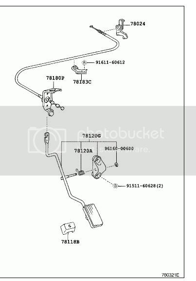

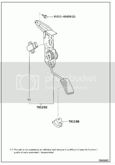

Here is 2 deferent accelerator pedal 100 series may have in USA.
1st one. Regular accelerator pedal with cable going to throttle body. This pedal should work for hand throttle.
2nd one. It is wire driven pedal. So it wont work. What year it started to appear on LC 100?

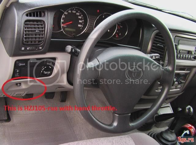

Here is HZJ105 Pedal which looks the same to USA 100 series non electric pedal.

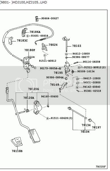

This is the diagram for 105 hand throttle. It seem that if to get Cable and Bracket it should fit into USA 100 series non electric pedal.
This is the OEM Hand Throttle installed in HZJ105. However you wont have special hole to install it like 105 or 80 has.
You will have to install like this or get new lower bezel (I can get it but it will be expensive to ship across the pond as it is bulky and awkward shape)

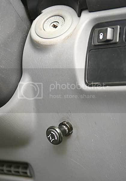

My 2001 is definitely cable operated. I took a couple pics.
This is lower portion:
This is up higher where the cable goes through the firewall:
