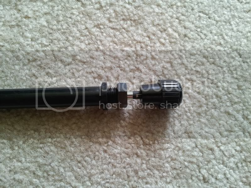

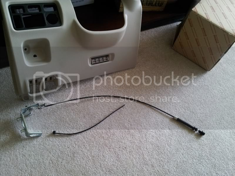

Cable+Nut+Knob

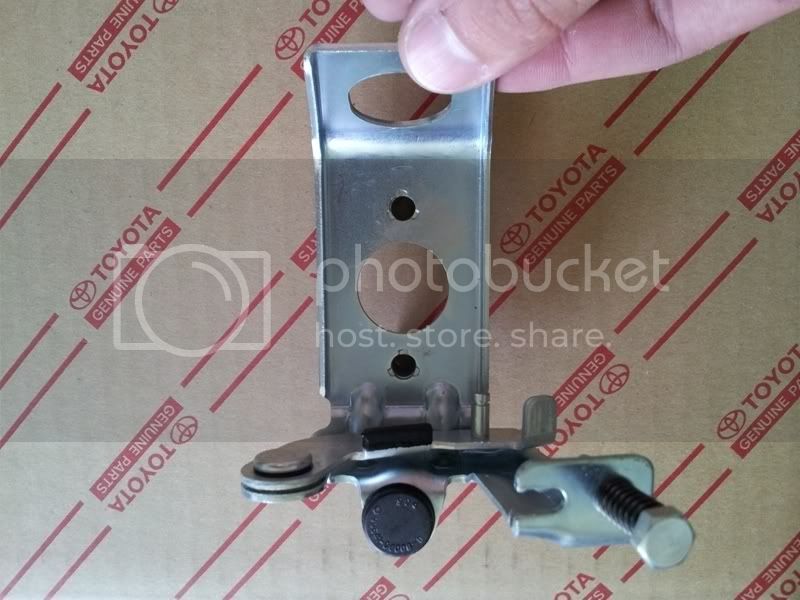

Bracket 78407
Video:

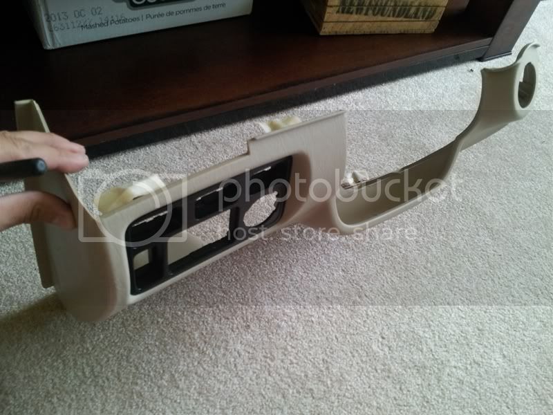

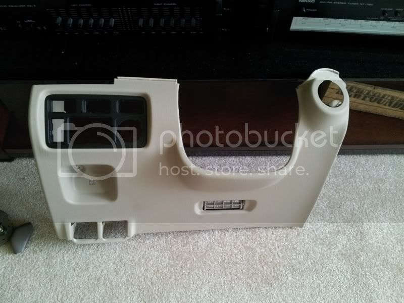

I think it will work according to what i got and pictures i have seen of original 100 series bracket.
Can you guys tell be if you think this bracket will fit and is your bezel look like the one i got?
The under dash trim looks very similar except my LX has some slits beneath the ignition switch. I think these holes are for the auto temperature (interior temp sensor). I'd be happy to test fit it for you =)
Hi Yan, haven't yet received the throttle, so nothing new there. However, I examined the bezel on my LX and it looks like it will work. Basically the same as hoser's...

Is your LX bezel the same color as the one i got? Ivory

So the hand throttle bezel doesn't have the opening/slits (and presumably the mounting bosses for the sensor)... where will you guys relocate that sensor?

Looking like this is going to work...spent some time on this last night. Just waiting until Akella can get me a lower bezel before I tear this apart and install it. Yan, are you able to get the lower bezel in the gray color? If you can't, I will look at installing it in the next week or so.

PANEL, INSTRUMENT PANEL FINISH, LOWER LH, STONE,TRIM1#,NO.2

There is another hole in the corner just above the hole for the cable. What is it for?
Also do you or can you supply the C clip that locks the cable onto the bracket?
