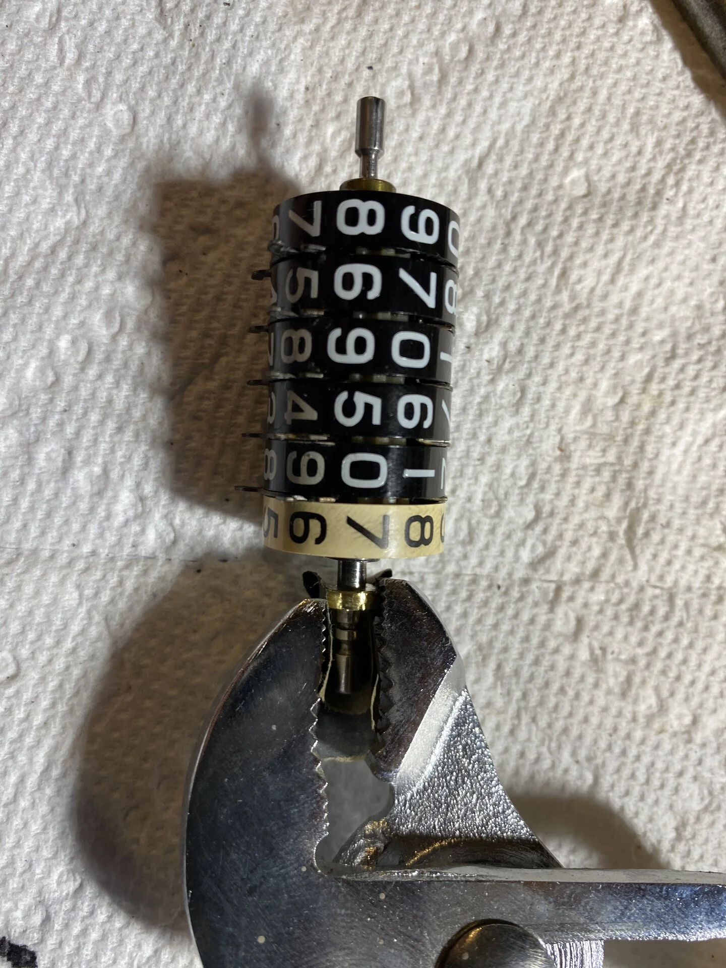

Hello, I was taking apart my odometer to try and clean and grease the dials/rod the odometer rides on. I got to the point of taking the numbers/gears off the rod but am now stuck. It appears on both ends there is a brass bushing pressed on. In the videos I’ve seen there is one side that has a bushing and one side that doesn’t. On my odometer it seems the easiest way would be to remove the bushing on the side where the tenths are recorded but I’m not sure. I’m unable to find any advice on what to do next any help would be greatly appreciated.

Thanks to everyone who chime in with tips. I Managed to get the brass bushing off the tenths side by using some CRC Electronic Cleaner and then heating up the tips of my pliers with a torch and grabbing the bushing melting the gummed up grease that the electrical cleaner couldn’t get. After about an hour of working with it I got the bushing off by holding onto it with pliers twisting and pulling upwards at the same time. Now the fun stuff taking apart the actual odometer. Will post some pics when I’m done.
I was able to fully take apart, clean the odometer and grease the internals and tested to make sure the odometer rolled over after putting the cluster back together. Works well however I have 2 different issues now my 30 amp (77 FJ40) ammeter doesn’t work anymore before taking the cluster apart it worked great. Are there any fuses for the ammeter or possible things to check? My second issue is now when I use my horn the lights for both turn signals and highbeam indicator illuminate on the dash. I replaced the stocks bulbs with LEDS from super bright LEDS that’s the only thing that I can think of causing that issue.
Pic1: Cluster taken apart and odometer taken apart for cleaning.
Pic2: Grease that gummed up the odometer and had turned into basically glue.
Pic3: How I lubricated the odometer internals with dielectric grease before reassembly. Slight coat on the metal wheel, plastic gear and inside of each wheel. Greased the rod the assembly moves on as well.
