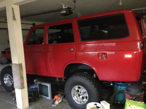

Fitz, I was in your shoes 2 years ago.I bought my Fj and rust was everywhere.I worked night and day for 100 hours to get a handle on it only to start a fire in the headliner and burn it down ( pics on my build tread).I was deflated to say the least.I ended up buying a whole donor truck and then had 2 trucks in pieces all over, overwhelmed to say the least.I was going to give up.A good friend gave me some good advise,he said get your work space clean and organized and then work on you rig for only 1 hour each night when you get off no more.Do small steps cut a small area of rust out maybe clean a rattle can some brackets anything and before you know it you will see progress and the troublesome areas that seemed to a disaster with not hope. This is what I stuck to a even put a couple of 8 hr weekends into it when possible. This truly brought the fun back into it for me. 2 years later:
nice post, Mark. Cheelout Fitz, I been there a hundred times. you're doin fine. the nice thing about steel is, you can always weld more on.....add 2" to the width of the D pillar panels.....
