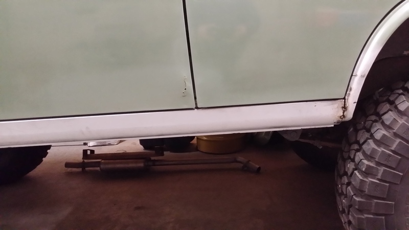

Last night i decided that since the rocker was mostly welded in, but not fully and before i go any farther with my body mounts ect. Figured now would be a good time to see if my body lines match up.
Well, i dont have the bad picture of it NOT lining up. When i did the patch panel to my rear wheel well corner it screwed up any factory hint of where the rocker needed to be placed in the back. When i cut the patch panel it looked to be correct and matched the body lines so i went off of that. Well it was a 1/2 inch to high! :bang:
Front door would close, rear door was hitting at the bottom door opening (my patch panel) The body line gap to the bottom of the door was a 1/2 inch too high as well.
So i took BobM's advice and completely cut my rocker out again! :doh:
After some measuring between the driver and passenger sides, and seeing how high i was on the rear part of the rocker, i cut the patch panel seam and lowered everything half an inch. I then went back and tack welded everything together and refitted the doors. Body lines are near perfect now. The rocker just needs to come outwards about a 1/4 inch and i'll be perfect with the rocker! Then im back where i was!
Some pictures of the doors bolted up after tacking the rocker back in place.
Spent about 45 mins just trying to get the rear door to align properly (dang sagging hinges!!!!) Midgainc will have a customer if hes still around when im ready. Bad news is when putting my front door on, i realized i have the common bottom hinge door split. :crybaby: So more work there later.
Sorry long winded, Have a good day guys!
