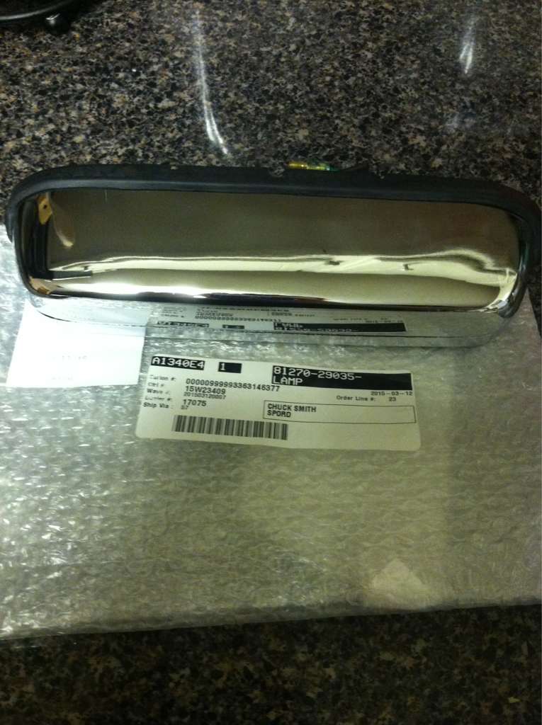

After hearing that fj40 turn signals are the same besides the bases which are swappable. So i went ahead and order 2 new turn signals from toyota. 50 bucks a pop with no shipping for those curious ($40 my cost). So i tore apart one lamp today to see what I'll be getting into swapping the base.
There's the break down.
I'll have OE numbers when they come in as well as a side by side comparison.

Got the new turn signals in, took some pictures of old versus new side by side. Also took a side profile to show to comparison of the bases (which will be swapped.)
Not sure why the pictures got turned all weird, tried to fix it but it went back.
Instead of swapping bases, can you just machine the 40 base down to get it to sit level on the 55 fender?
I tried to cut mine down, but the bases are made different, other than just the angle. The locating pin is in a different spot, which you could cut off. Somebody with skills could make it work.
