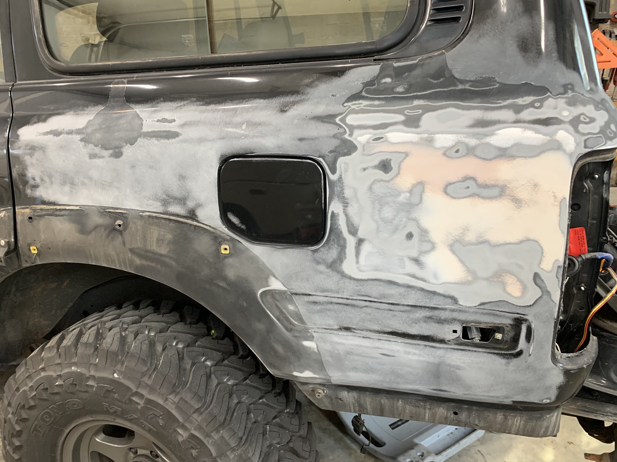

Passenger side = good - just needs paint correction:

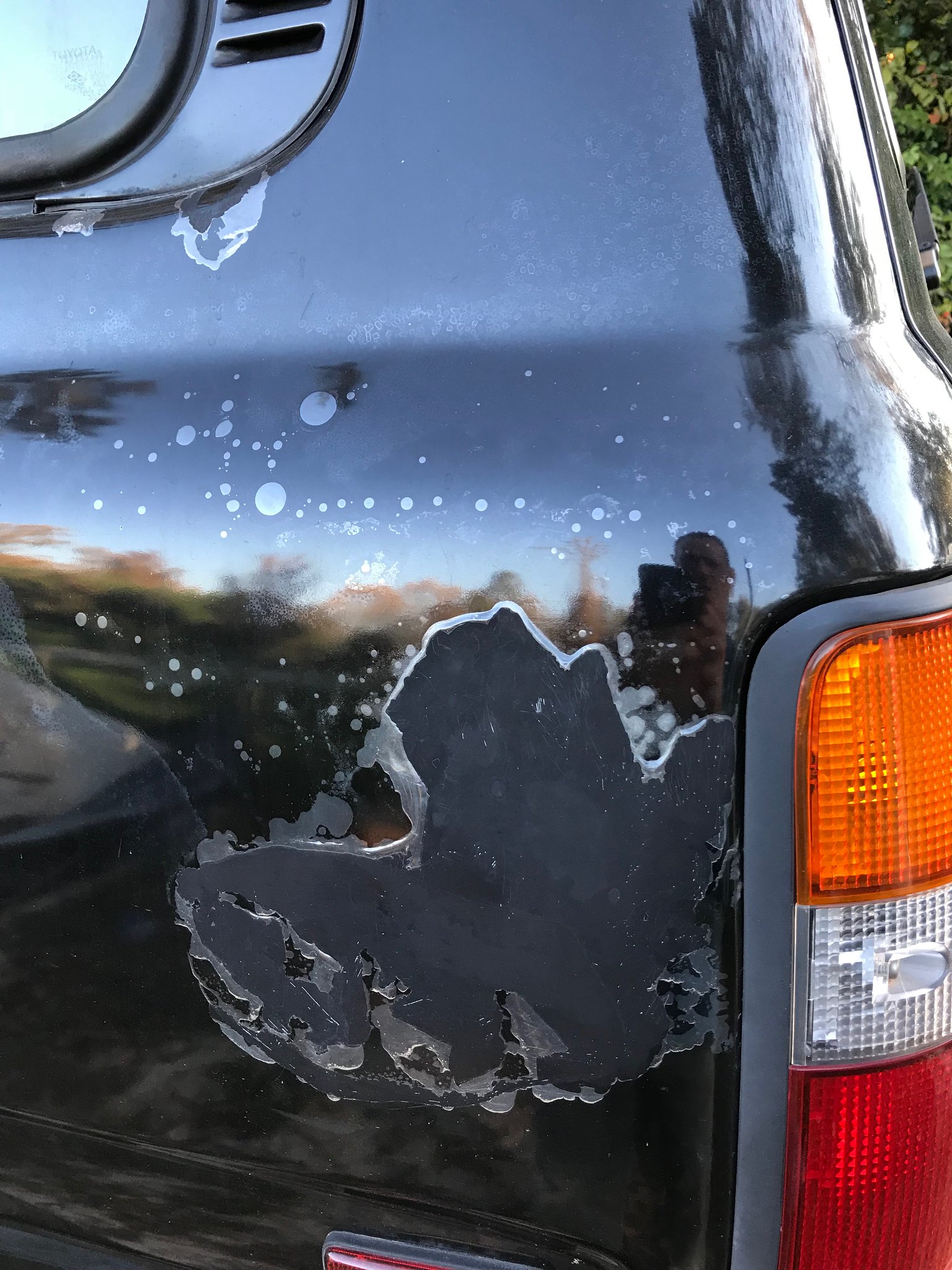

Driver's side = Bad! Have a look:
So, the first question is: Should I paint the whole truck which would allow me to do to BC / CC or just paint the bad areas (i.e. the Driver's side and hood)?
If I just paint the bad areas, I assume I should do single stage to match the rest of the paint?

—Quite frankly, I disagree with the above poster - I’d go single stage & do the roof.—
The single stage mainly to feather into the good paint as the pic looks on the PS. Then you’re back on solid paint.

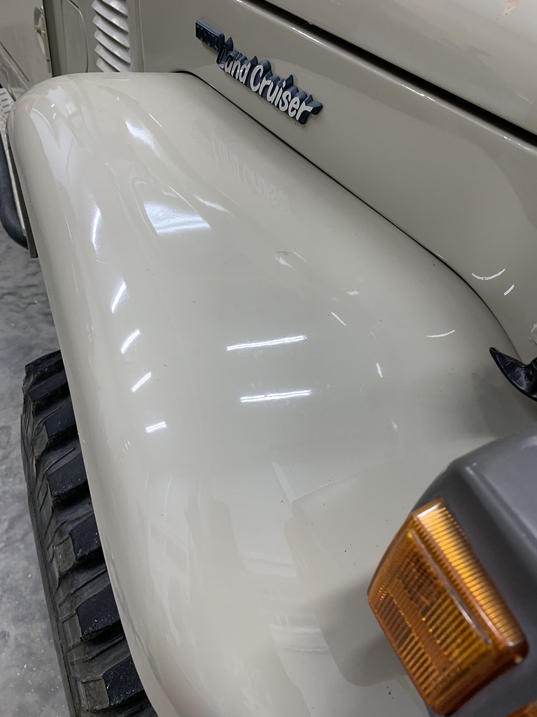

-Not the easiest to get nowdays, but acrylic enamel holds a shine & is extremely ‘pinstripe resistant’. Hard, shiney, low maintenance paint.
I shot this stuff on a new set of fenders and half doors on my 40 - with some wet sanding and buffing I was able to achieve good results I think (note they could use washing!) - This says acrylic urethane - is that the same as acrylic enamel or no?

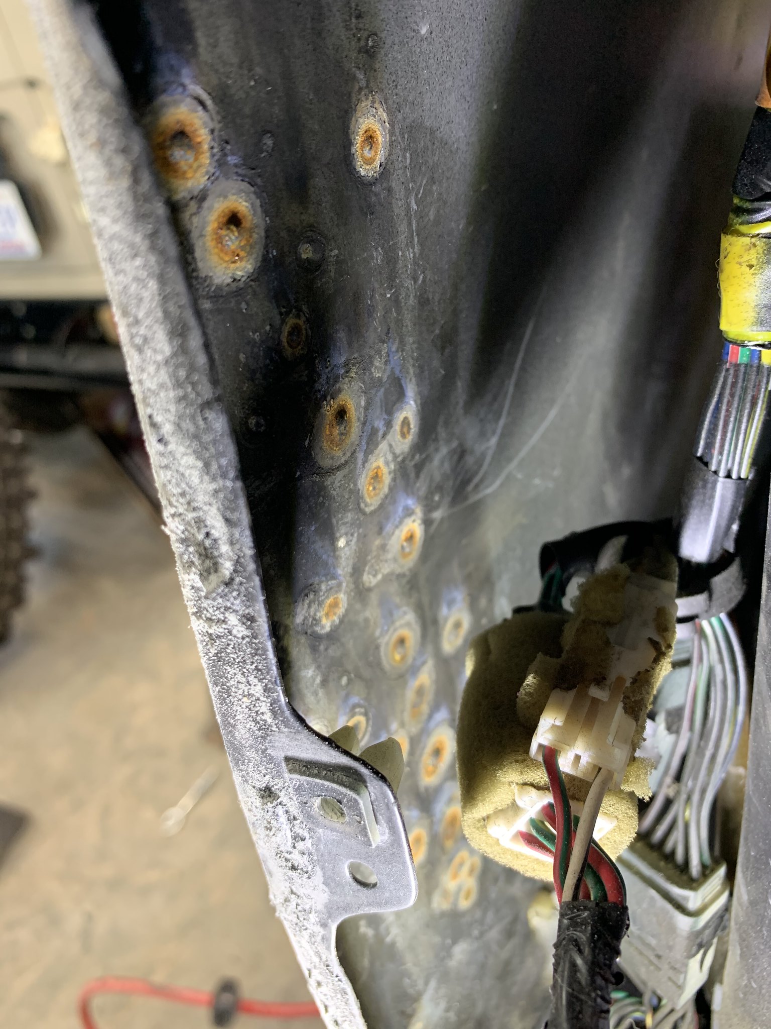

Oh, I forgot to add - I simply covered the glass moonroof by opening it & closed a fresh sheet of butcher paper I begged from the grocery store in it - no tape or anything for the welding stage / spot primer.
I say that as sparks melt into glass, but bounce off plastic - so save yourself “pockmarks” in the moonroof while welding by either using aluminum foil or butcherpaper.

Ok folks - here's an update and some questions... I now see why the driver's side was repainted (at least in part). Found lots of bondo near rear tail light - in one place I'd estimate it is ~1/8 - 1/4" thick. There are several weld spots visible on the inside of the panel (and the start of rust) that don't make sense to me. Here are my questions thus far:
1) are the welds where they used studs to pull the dent out or did this thing get shot with a shotgun??? Doesn't make sense that they would use studs when such easy access to the panel is achieved by removal of rear tail light.
2) Would you sand to bare metal in this area and refill? What would be the advantage(s) of doing so?
3) I've already cut into metal (sanded with DA and 120 to see what I have) - how quickly do I need to seal this with primer and can I use rattle can stuff until I'm ready to paint for real?
4) Given what you're seeing here, would you take the whole driver's side to bare metal or scuff and paint? I'm thinking of de-flaring so might wind up painting the whole truck (though I was trying to avoid).
