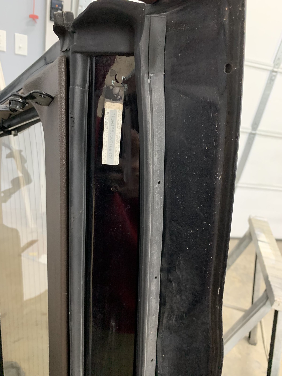

Made more progress today - got most everything taped up that I could without making it immobile. Need to roll it out and clean up before I'm ready to shoot paint.
That said, here are more questions... Are these jambs supposed to be shiny? I don't think this is overspray since these parts of the truck have original paint but it is surely rough / not shiny.

Seems the parts that are rough are just areas that would see water run off, maybe just a build up of water and grime? Also, my vote on color is black. Whenever my customers ask me what I recommend to use for straight black, I always recommend Mazda code NN. At least in my Valspar line, it’s just black and binder and looks killer in single stage. Black with Gold emblems is, in my opinion, the best looking 80 out there.
