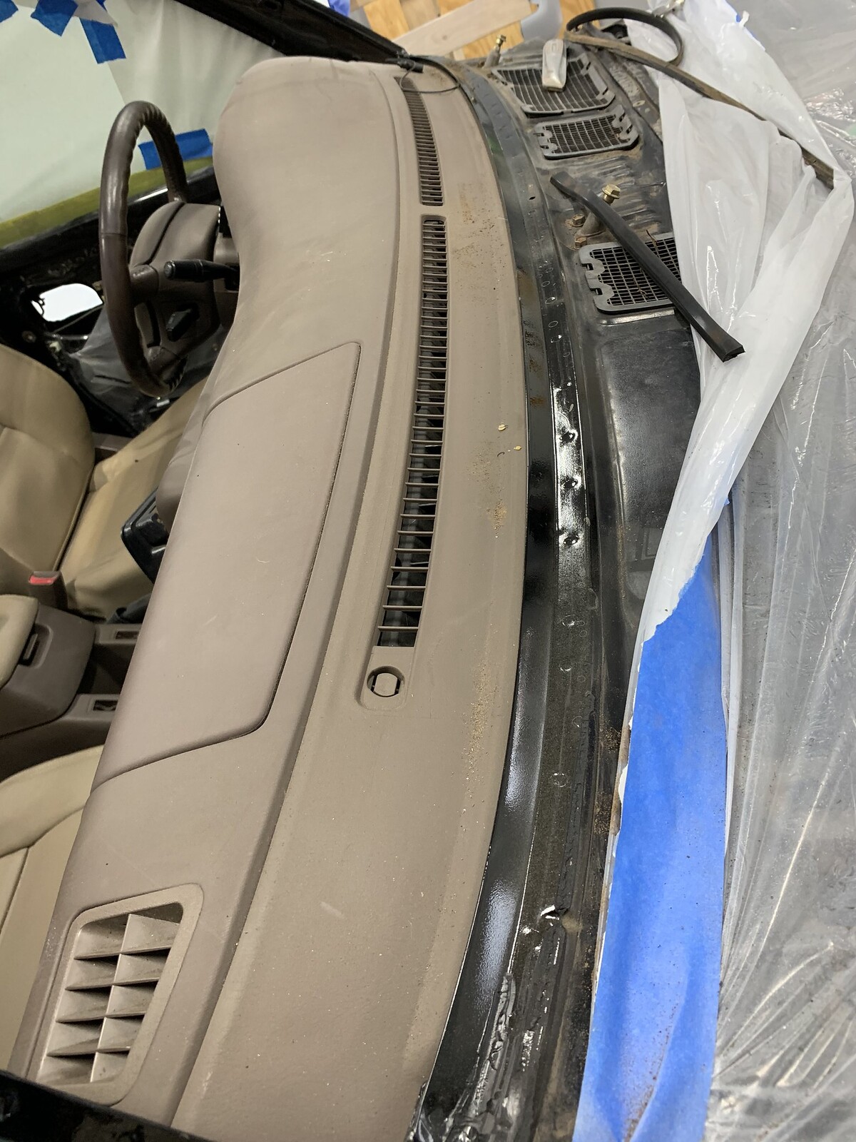

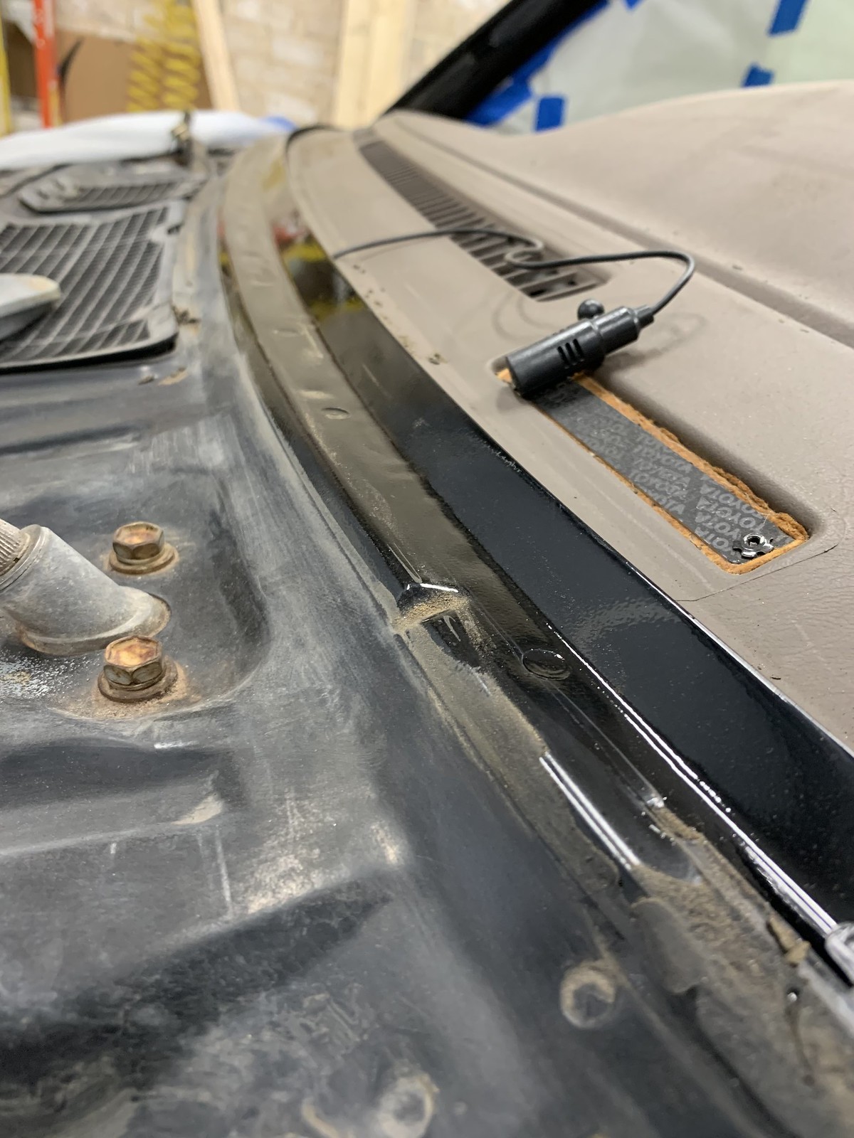

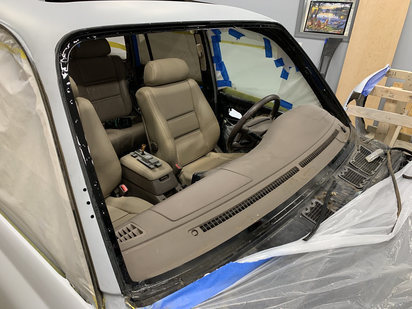

The whole thought of rust hiding behind that windshield gasket was going to keep me up at night so I cowboy'ed up and pulled it. The good news is there's not a spec of rust anywhere. The bad news is I now have to get it reinstalled. So, here are the questions...
1) Can this be done with a helper as DIY? I read the FSM and it seems reasonably straight forward but it's not something I want to screw up
2) The sealant used (apparently from the factory) is stuck pretty good to the body - is there a solvent or some other method of removal besides scraping it with a non-marring scraper?

Subaru has some interesting colors on their new vehicles. Their is a green color that they have I thought would look incredible on a 80. I think you could install a windshield yourself If u wanted. Use the rope method. Will need someone to apply pressure to the glass as you go. I would do it after paint is done though. Also, tape up your hvac intake ducts to keep as much dust as possible out

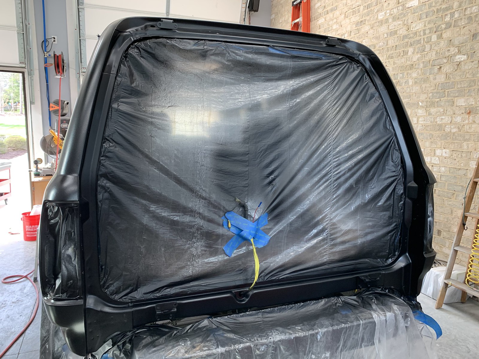

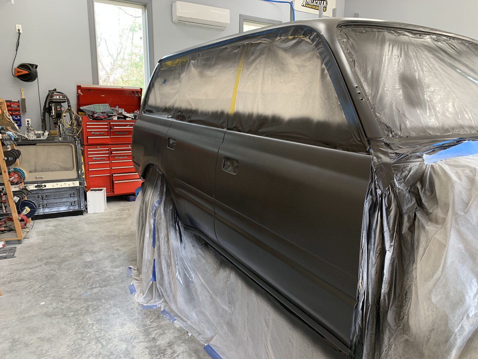

Well, I do not, I repeat, do not, recommend block sanding epoxy... It just rolls up in little rubber like balls and clogs your paper. That said, I had no choice - the topcoat window is 72 hours and there was no way I was going to make that with all the COVID planning going on at work. Also, I didn't use enough acetone to reduce the epoxy so it laid in more like monster liner vs. flat. So, I've spent the whole weekend wet sanding the whole truck... by hand.... in 400 grit.
Sometime this week the guy from the paint store is going to come over and help me lay down the final coats - two coats of sealer, two coats of color and as many coats of clear as my gallon will cover.

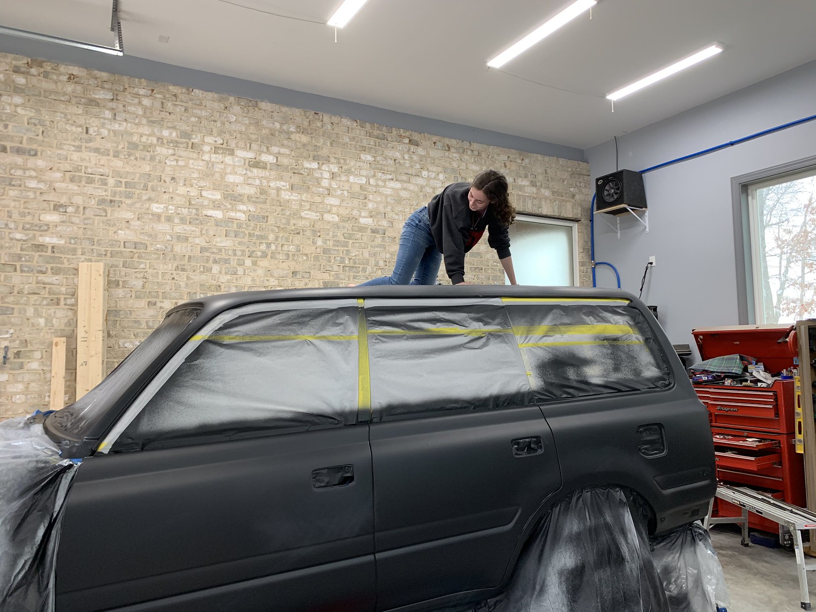

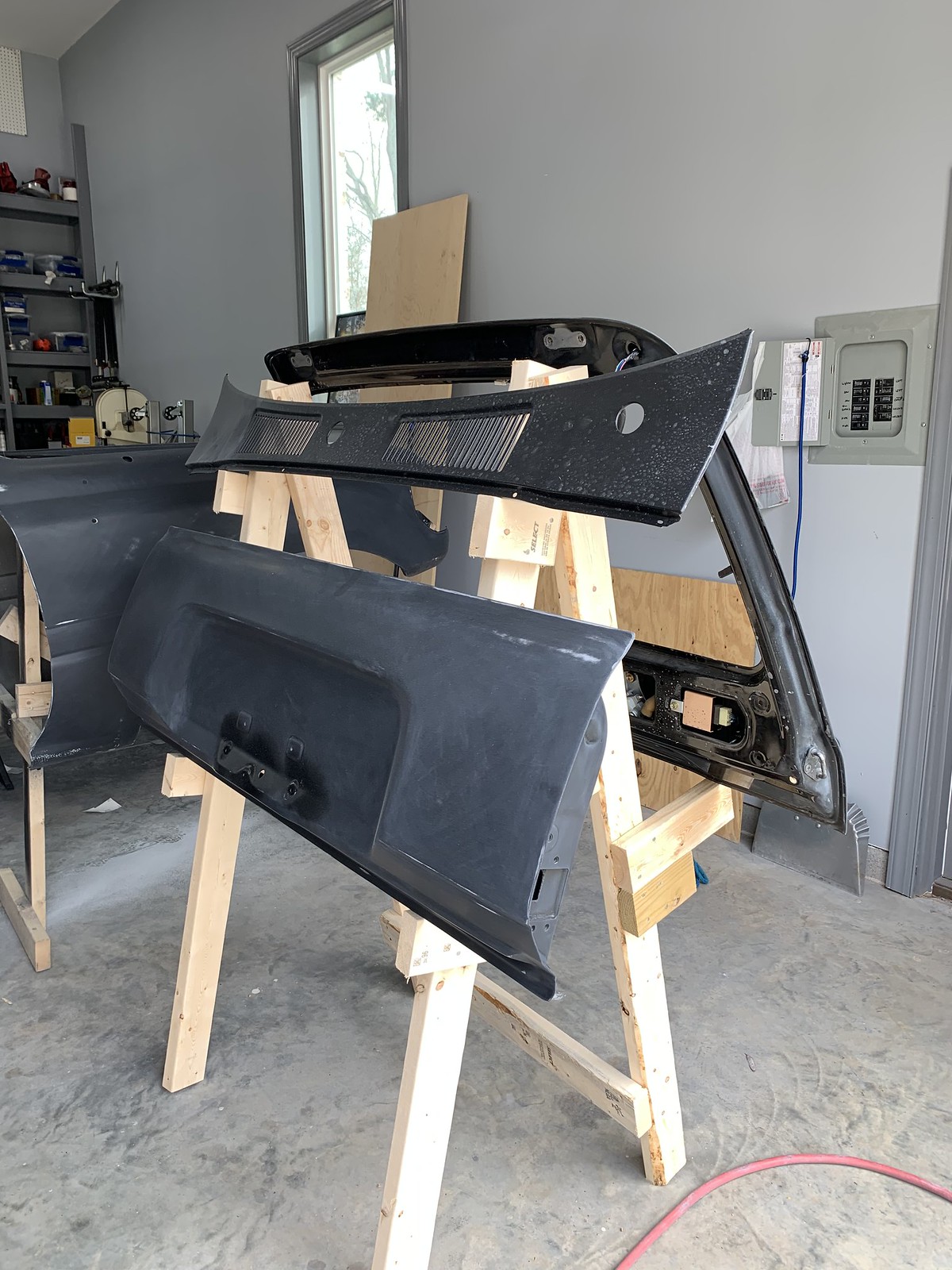

Oldest was home from college so got her involved... Having a 100 lbs daughter comes in handy when sanding the roof. Also built a rick for the hatch, tailgate, etc. - still got a bit more sanding / cleaning to do!

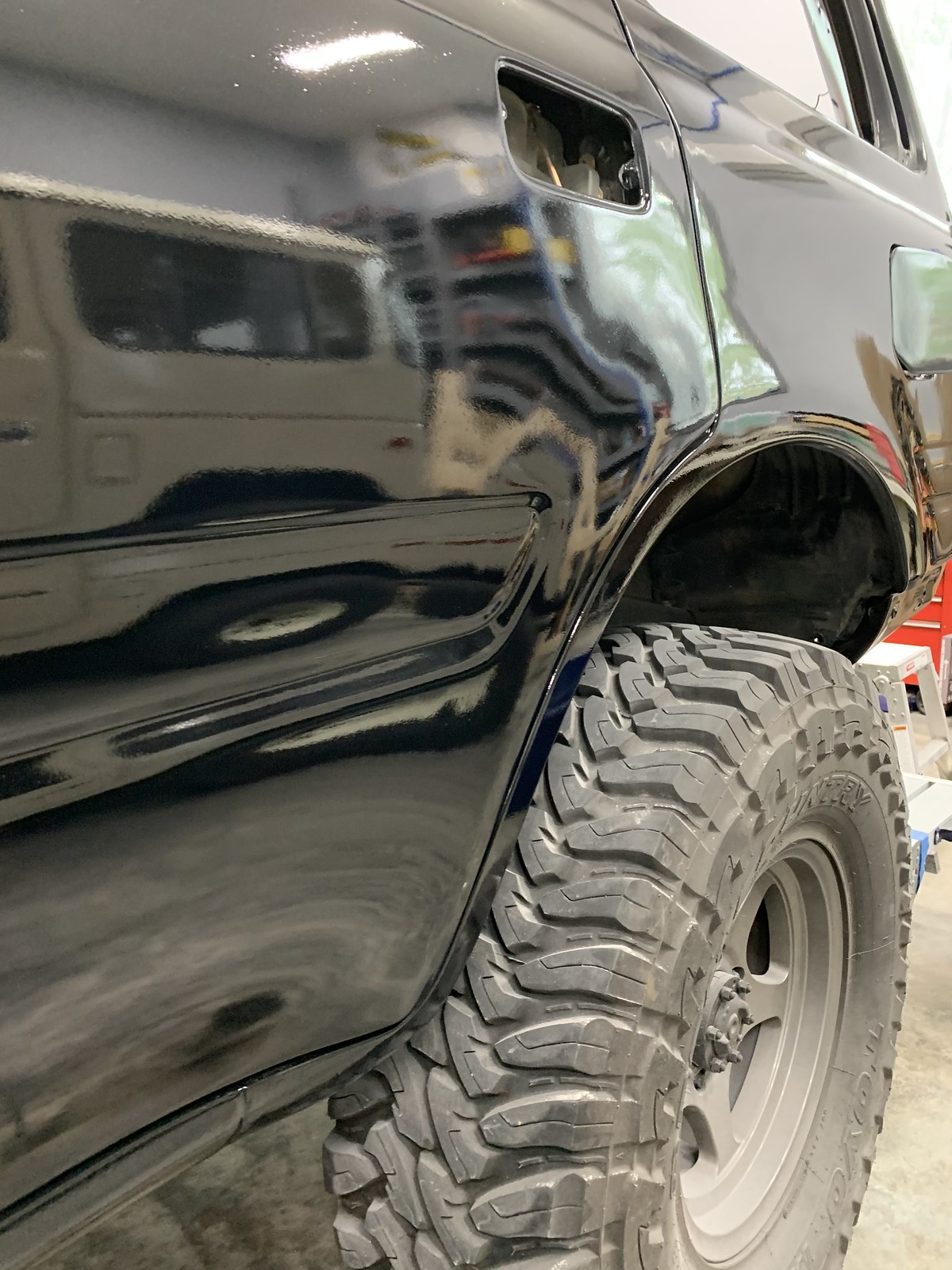

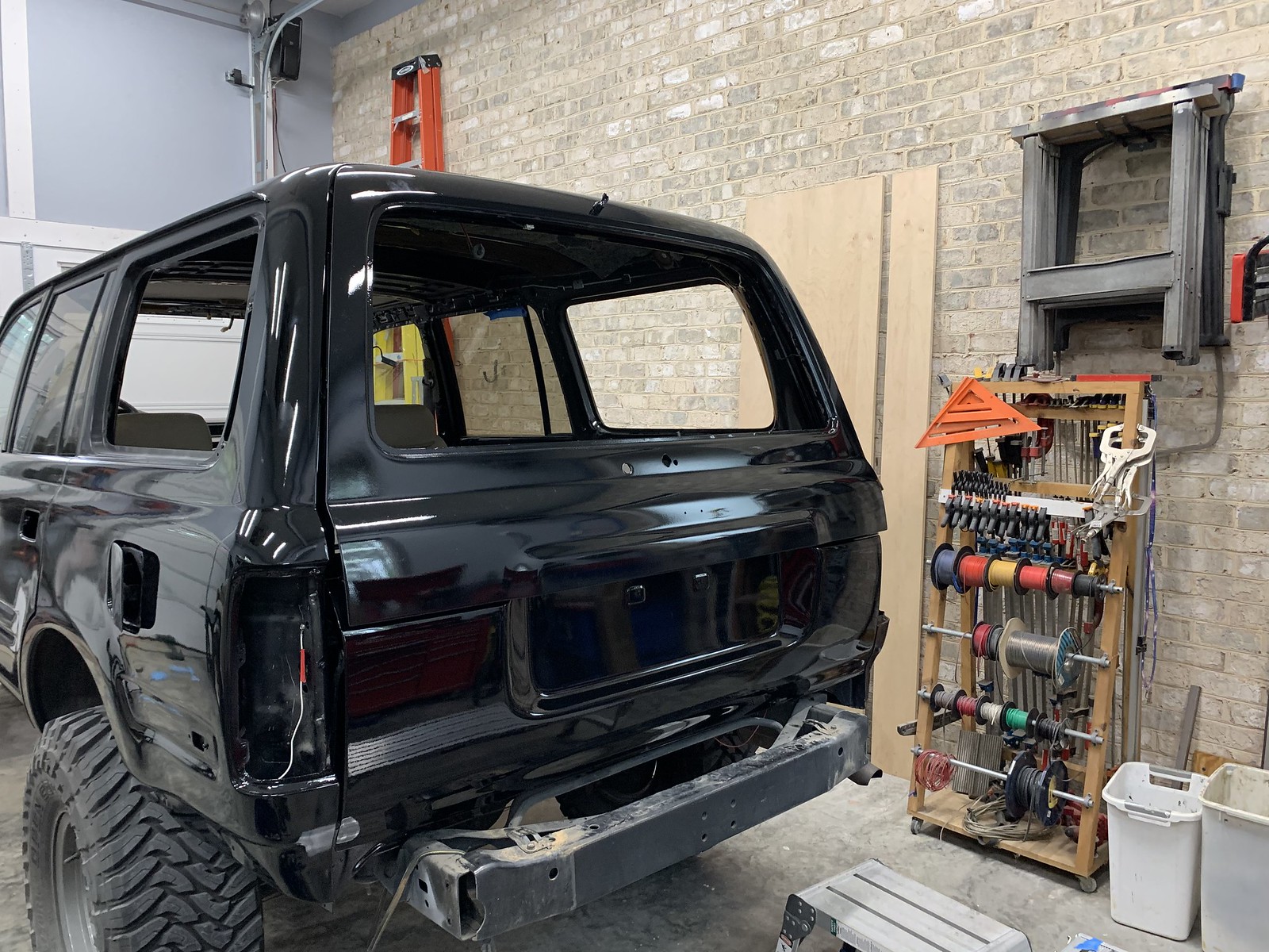

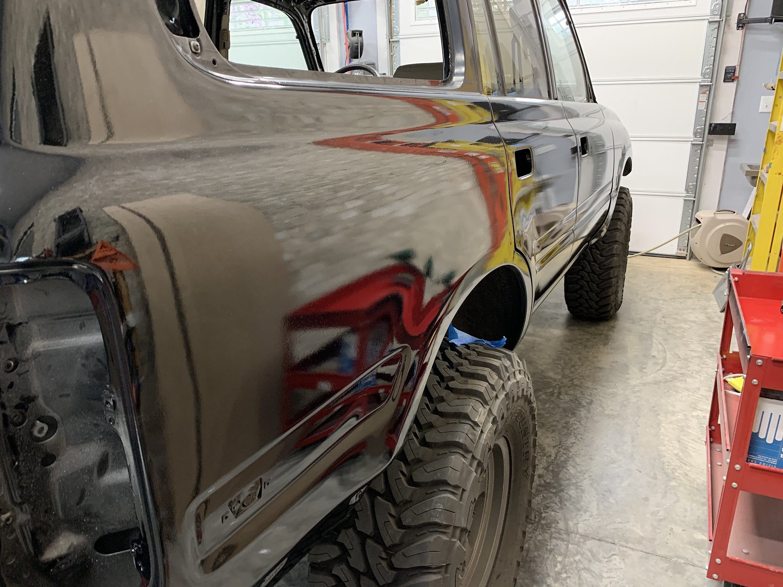

Well, finished the paint at 1am Saturday morning... except for the hood. Had some trash blow up from the floor into the sealer so had to sand that down and will re-seal, base and clear tonight maybe. I think my bodywork looks pretty good all things considered. Got some orange peel so need to wetsand and buff next. Man is it black though... thinking of painting bumpers, sliders, snorkel a charcoal grey color to break it up... Appreciate any thoughts on the idea.
I'm not a fan of black, but you did good there! I do like your idea of using grey to contrast the black.
Damn, that looks really good.
Everything on my cruiser is Black and I have been obsessing about tasteful charcoal accents. Would love to see how it turns out . Great job on the paint !!
