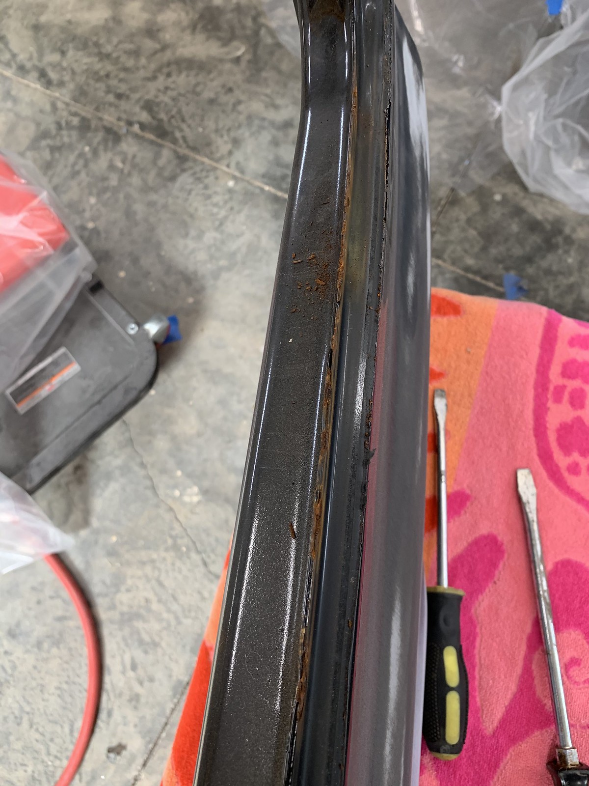

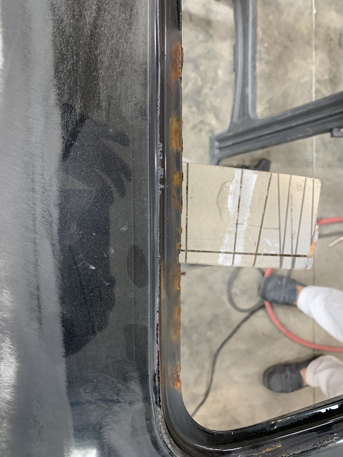

@LINUS , thank you so much - I took your advice and did in fact find rust... If anyone wants to point me in the right direction in terms of how to fix / prevent it I'd appreciate it. I wire wheeled it but now need to deal with rust that's in between the two pieces where they're pinch welded.

For the pinch weld I would dribble a few liberal coats of rust converter hoping it soaks in and neutralizes followed by some por15.
Same.
You can either use some rust converter of just thin down some POR-15 & pour some in. It likes biting into rust over clean metal. (The POR-15)
When you re-install the glass with RTV it’ll encapsulate that entire pinch-weld area the full glass perimeter.
Down the line when you are cured up, you could drip some ATF into the tailgate ala’ the Wagongear way, takes care of rust in the lower pinch by the hinges - but between rust converter or POR-15, your hatch will be great esp when you fill that gap with RTV.
