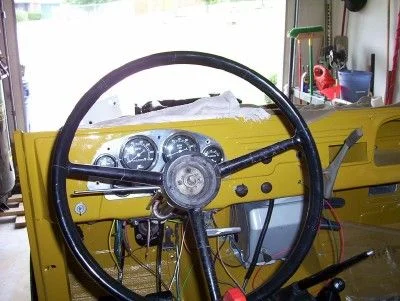

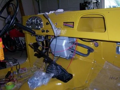

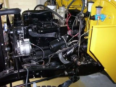

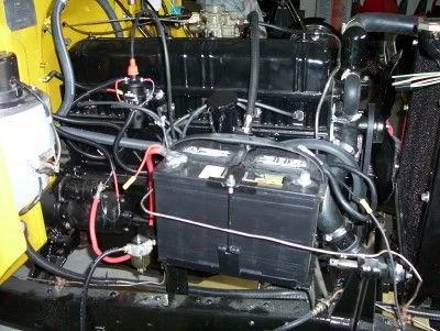

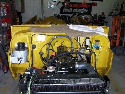

Got the engine broke in finally. Had to brak the new cam and stuff in. Runs really good with good oil pressure and good oiling up top.
Did a bunch of wiring stuff on this thing as far as the cluster goes. Got it all working. Going to call EZ here again shortly with some questions about the turn signal wires and back up light wires but after that should be pretty much done with the hard part of the wiring.Still have to hook up the front part of the truck and start running light wires but that should be pretty easy.

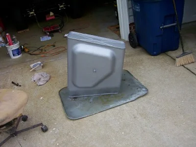

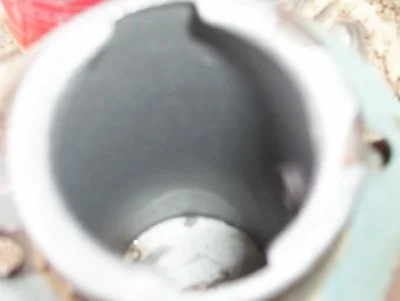

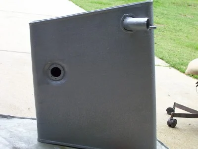

The fun part has been the fuel tank. Tried that POR 15 fuel tank treatment stuff and it seems it might accidently work. Looks good on the inside now. Even Rust bullited the outside of it so hopefully will not have any problems out of it for awhile.
Not too sure how many have worked on a tank before from one of these but i found out something new on it. Where the fuel outlet hooks into the side has a tube that runs a way into the tank. Mine was clogged solid with some nasty stuff. I ma not even sure why i tried to run something in it but i am glad now that i did. Would of put some fuel in it and been a little upset when i did not get anything out of it.
