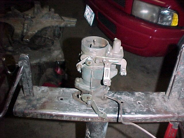

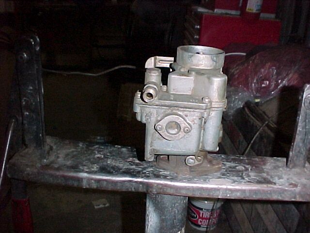

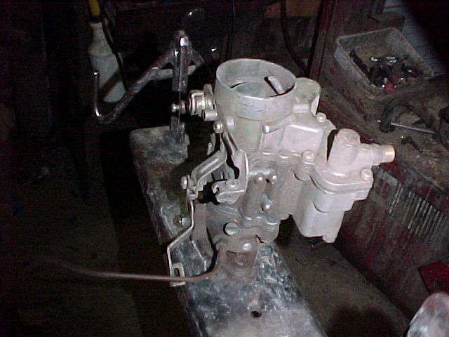

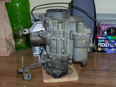

As promised here are a few shots of the carb.The side says its a D-40. Will this work on a 135 ? Also you can see where there is a part missing from the base part from above the air / fuel mixture screw is, anyone know what goes there ? I got this carb out of a garbage pile from a place around here so i am not even sure once i open it up all will be there.
My carb is not exactly like your's, I know for sure this is the one off my 65 FJ45......your missing fitting is the distributor advance cause I left the line in this one.......
Sad part is that i am missing the other end to the line also. The end that goes into the dizzy. I got to look for one of those also.:mad: :mad:

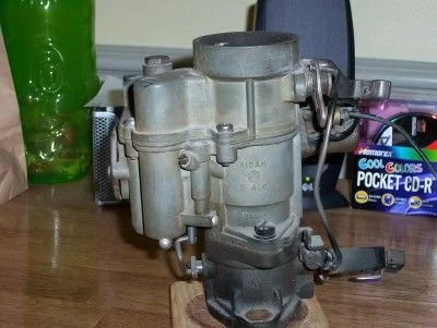

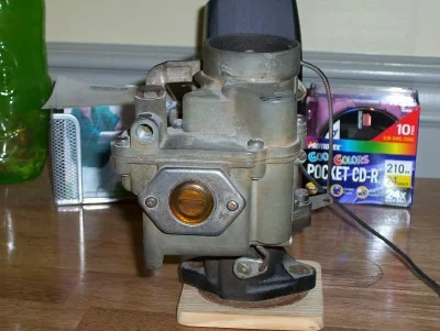

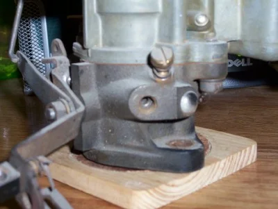

krzyabncanuck said:
And seeing as we are on this subject for now, is there a easy way of cleaning out the oil bath air filter housing where the screens are ? I got one from someone on here but it is pretty nasty in there. It has been soaking for about a week now in my parts washer but the screens are still nasty. Was wondering if it comes apart ?
Thanks
Hope this helps
...............JC ;)
Does the one part just pull apart so you can get under th screen element ? Thats what it looks like in the above pic. I just did not want to try and pull it apart and break it in the process.
