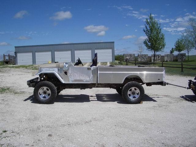

Darin, Just found this today and read it all! Awesome job! I am very impressed with everything you have done. As one of the PO's of this rig, I'm sorry I let her go. In my defense, I never did anything to the truck while I owned it. My PO had that pleasure. Sorry about the engine. That is one thing my PO told me, it did run good, so I passed that info along. Based on some of the other things he told me, I probably should have known better. :frown:
As far as you have gone with this, I think it is a good thing you decided to leave no stone unturned.
I will def be following your progress...
Wade

Wade, You messed me up man. I was going to wait till it was running and send you some pics. At least you know that it went to a good home. I am not upset with anything you told me at all. I knew you had done nothing with it, but knew someone previous had done some serious stuff to this thing.
I had hoped yours was running by now, is it ? It is looking sweet as heck.
The family still doing good over there ? They want to sell yet ?;) ;)
Also on your behalf, it did start and run. Ran pretty good also. The things i am still finding on this thing kill me though. Like today was messing with the choke cable, cleaned it all up and low and behold it is too short. Someone shorted it for the rochester.
Also now that you are on here you need to do a short write up on your beast.
