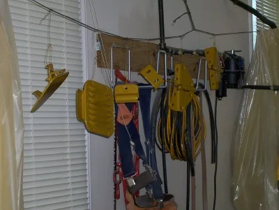

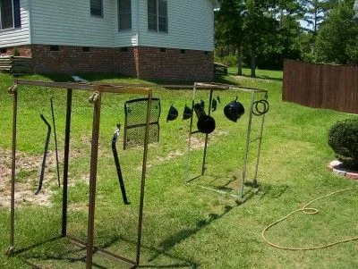

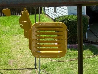

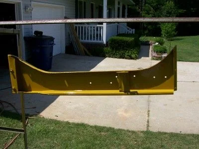

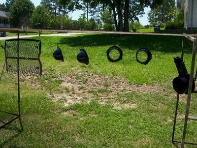

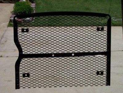

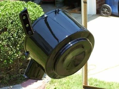

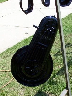

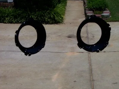

Some more progress pics. Just of my decent outside painting skills. Sprayed these parts outside, no wind and good sunshine. They were all black anyhow. I know alot of these things started their life out zinc coated but when you are on a super tight budget they get painted. Once i win the lotto then i will do it better.;) ;)
I have some bug fossils from doing outdoor painting :D!

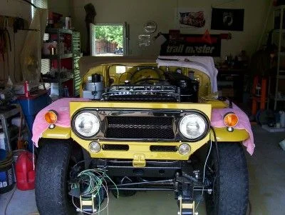

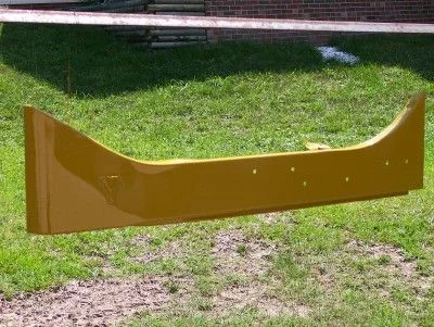

Here are some more pics from today. Was a good painting day today. Got alot of the small stuff painted today. The last major item i have to paint is the hood.:) :) :)

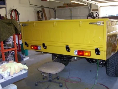

Got my rear tail lights mounted. Had to cut away some metal for that. That was not fun but i think they came out good.

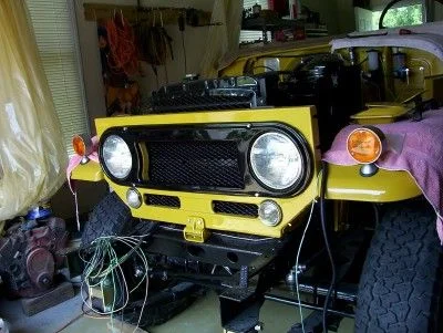

Got some headlights in the front mounted now. I ended up painting the bezel black. I did not have any white handy and i was painting black at the time already so black it went.

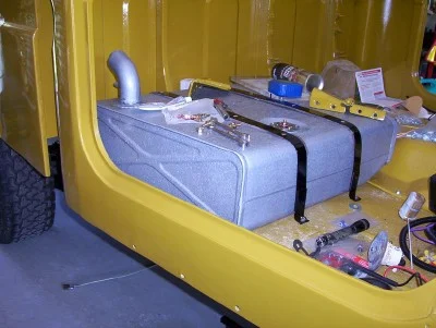

Got my tank in but i think like the seats it is not for the 45 either now. The fuel filler thing is way off and i think i am going to end up cutting both the filler neck and tank neck also. We shall see. I will get a pic up of that here in a bit.

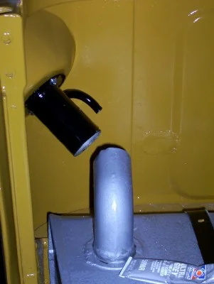

The 2 pics below are what i am talking about with the fuel filler neck. It is the right neck, i just think that the tank is from a 40 .I was thinking about cutting the neck just about 2 inches and seeing if that will help me some.
Also anyone out there know off hand what fuel hose i can use seeing as i think the one for this one is discontinued. I remember something from about a year ago or so, someone was talking about a different Toyota truck or something being close and having to be cut down.

I just did the POR15 to the tank in my '66 FJ45. It is not an orig. tank, but one out of a early 70's 40, I believe. My tank lined up EXACTLY like yours in the pic, i.e. my fuel filler neck and tank neck have a sharp angle and not much gap. I did not cut the tank, but I did consider it as I struggled to get the hose to connect...
It was a PITA because the you kinda have to install the hose AS you install the tank....getting the hose on AFTER THE tank is installed is almost impossible.

Just PMed SteveH about the fuel hose for the tank. He had done a write up on it about a year ago. Also seen it was a 2 inch ID and i guess about 5 -6 inches long i need.
Sound about right ?
I tried one from a later FJ40 about a year ago, but I just couldn't make it work. The rubber was too old to adjust. So I ended up supergluing the original hose. That's just how my filler tube and tank line up, Darin. I went out and mic'ed my filler tube, and it is 2 3/16 inches, not just 2. So you'll need a 2 1/4 inch ID hose, I'd say.
