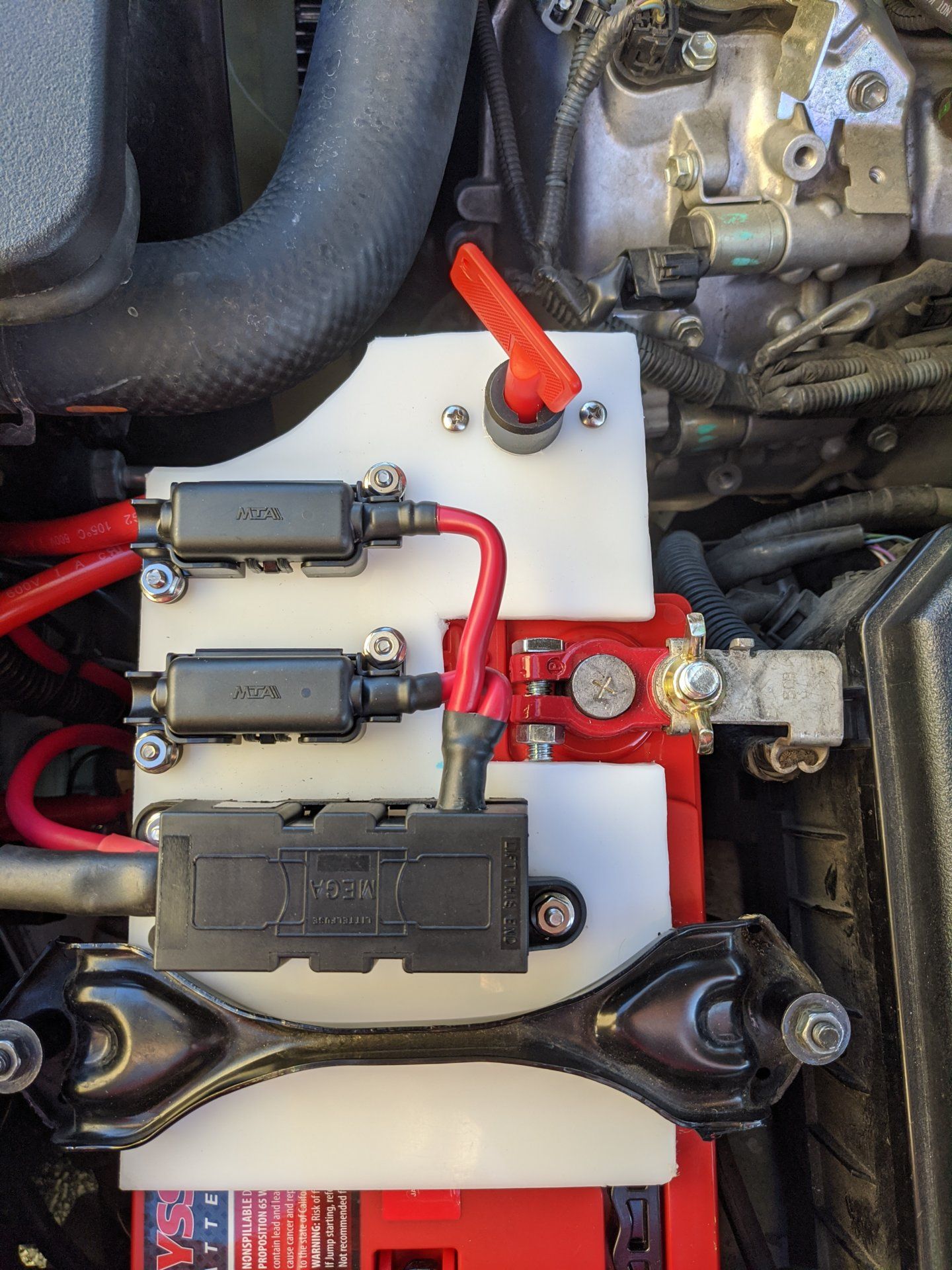

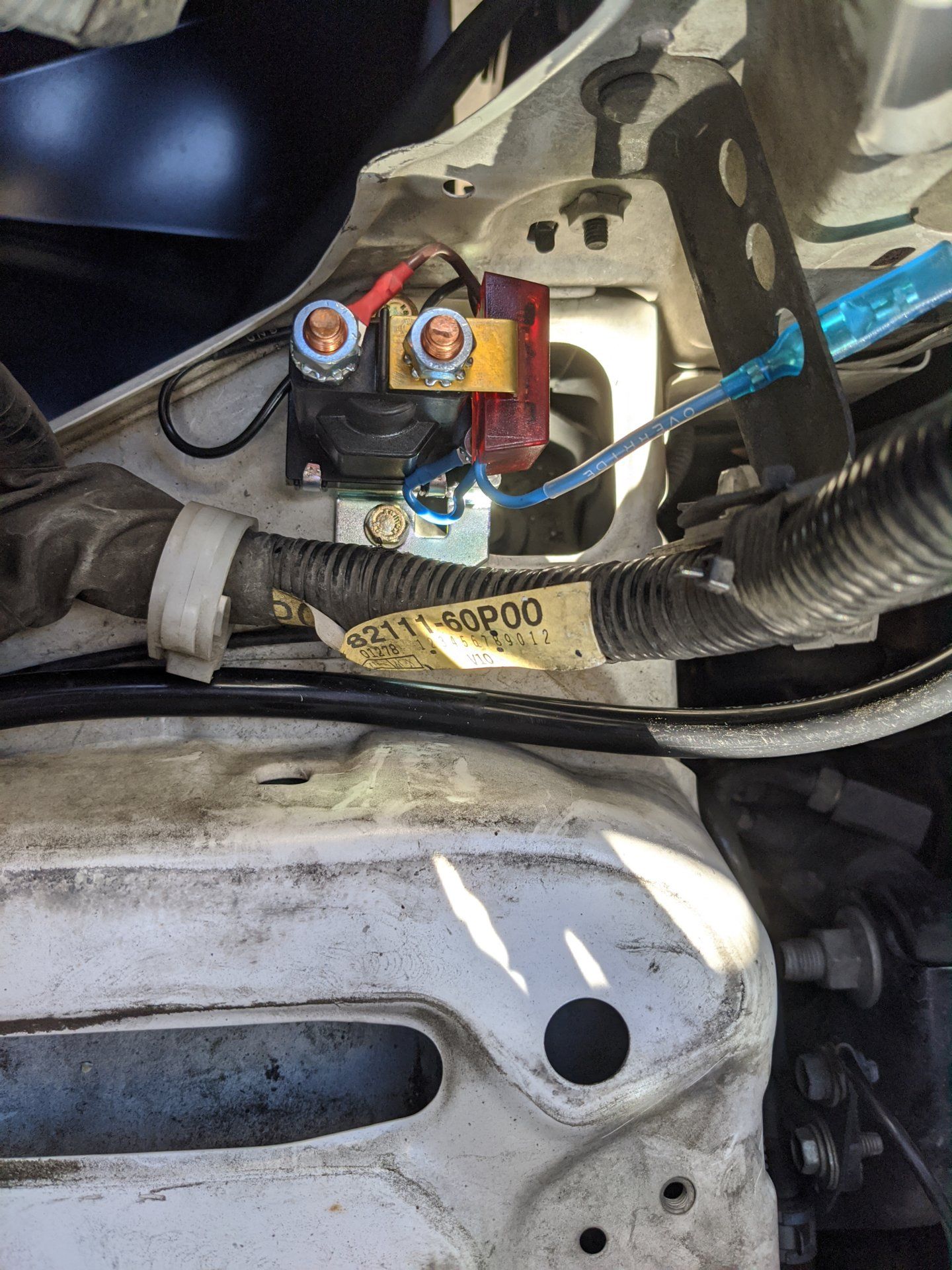

Started the dual battery setup today. Got the Redarc smart isolator mounted in front of the battery. I don't do self tapping screws into body sheet metal so it took a bit of time to get it drilled and nutserts put in.
I started making a power tray of sorts out of a 1/2" thick piece of HDPE that clamps down in top of the battery with factory hold down. Not sure if I'm 100% happy with it. I need to mount a 100 amp mega fuse holder (isolator/jump start), and two 40 amp mega fuse holders (Redarc BCDC/Trailer power) so space is a bit tight.
I've also got a Hella style manual battery cutoff switch mounted for the winch that I may swap out for a 200 amp relay that can be controlled by a switch panel.

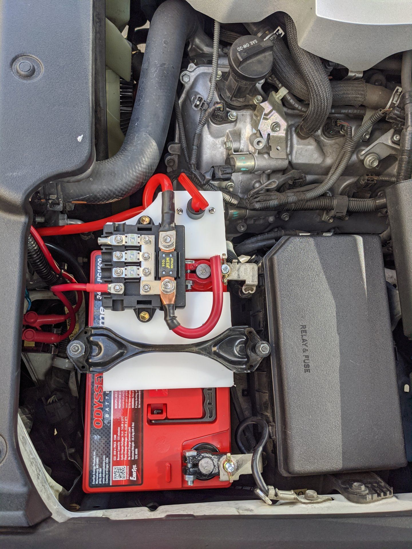

Can you take some photos of your entire engine bay to show the setup in relation to the rest of your engine compartment?
@r2m I've already disassembled it as I found a few other distribution blocks I want to try to cut down the clutter.

@r2m here is the second idea for the power distribution. Much cleaner and more compact
I think this will be the setup I am going to run. I need to finish up the cabling and trim up the HDPE mounting plate and it's good.

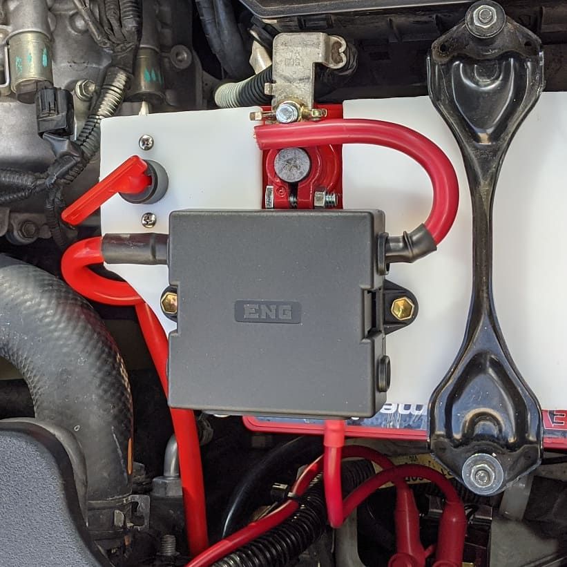

So as I'm looking at it, the small photo is your "house" battery, passenger, front and the "start" battery is the large photo on top?
When you get a chance, can you take a pic of the entire engine bay?
@r2m I don't have my aux battery in yet, this is on top of my main starting battery

I finally sat down and figured out how to keep my secondary air injection while installing my auxillary battery.
I used the Shrock works T4R battery tray because it had the bracket for the PS reservoir and a tab to mount the A/C line.
The tray bolts in without issue
I needed to take about an inch off both PS hoses so they didn't rub up against the upper hose/thermostat housing.
There's a pressed in stud for the A/C with a p-clip to hold the line. I tapped out the stud and and drilled out the hole to fit the factory rubber isolator off of the original line bracket. I did this to provide better vibration isolation and to raise the line up a little higher to keep it's lower section from rubbing on the lower radiator hose.
I had to bend the tab on the original line holder down to clear the battery.
I've also trimmed the plastic upper shield for a few reasons. I wanted easy access to the battery, the coolant overflow bottle, and the radiator cap. This makes it easier to maintain and service the truck.
