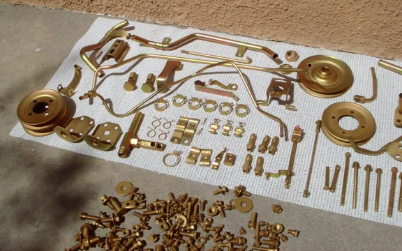

Did you zinc plate your metal spaghetti? Very nice!

When I had the engine apart a couple years ago I removed all the fasteners & hardware I could get at & took a Bucket-O-Parts to the metal plating shop. The spaghetti got re-plated too. Cadmium with yellow chromate (yellow cad).
It was a shock to drop of a Bucket-O-Rust and get back a Bucket-O-Gold.
