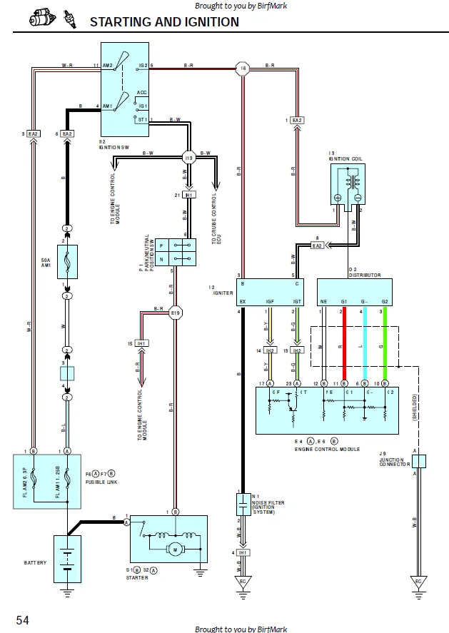

From the 1996 EWD:
If the starter cranks when jumping between the 2 terminals, then the starter logic side is faulty.
From the 1996 EWD:

There are only 2 connections to the starter. You can jump those together and the starter will crank, assuming the connection from the positive battery terminal to the starter is not faulty.
Or, if you want to run a wire from the positive battery terminal to the logic side of the starter (clip on terminal) that would be the same idea.

Those are certainly words, but they don't make sense to me.
The starter has a direct connection to the positive battery terminal. That is the one under the rubber insulating hood with a copper nut.
The smaller push on connector is the logic side of the starter from the starter circuit.
If you remove the push on connector, and momentarily short the 2 starter terminals together, you are applying +12 to the starter solenoid as if you have turned the key to the start position. This will cause the starter to crank.

These symptoms point to a bad connection somewhere. Just because you have good continuity with an ohmmeter or continuity checker does not mean the circuit can handle the high current of the starter.
To determine if the problem is on the ground side or the power side, I would suggest using half of a jumper cable set to bypass each connection. First, try connecting one of these cables between the engine block and battery ground terminal. If that helps, then you need to check EVERY ground cable between engine, body, and frame for looseness, melting, etc. If the symptoms continue with the ground bypassed as described, then you will need to try bypassing the positive cable to the starter. The worst part about this is that the battery cable lug on the starter might be kind of hard to get the large alligator clip onto, but once that is done you can connect the other end to the positive battery terminal and try again.
The only other things I can think of as a cause would be really bad, like the starter shorted internally or the engine seized. Going off a bump might have done that to the starter, but not likely to the engine.

I'm pretty sure the OP was thinking he needed to jump directly across the solenoid, from the battery terminal to the motor terminal. There are technically 3 connections at the solenoid, including the M terminal.
