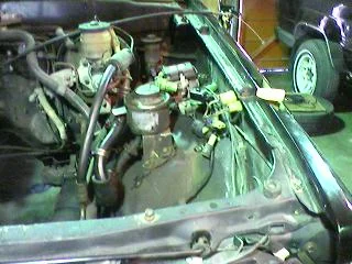

The one on the left is a 8?, RTE 4Runner... IFS.
The one on the right is a 86 RTE 4WD truck. IFS.
The port could be on the passenger side... It could have slid off the little clip that holds it to the side of the fuse box.

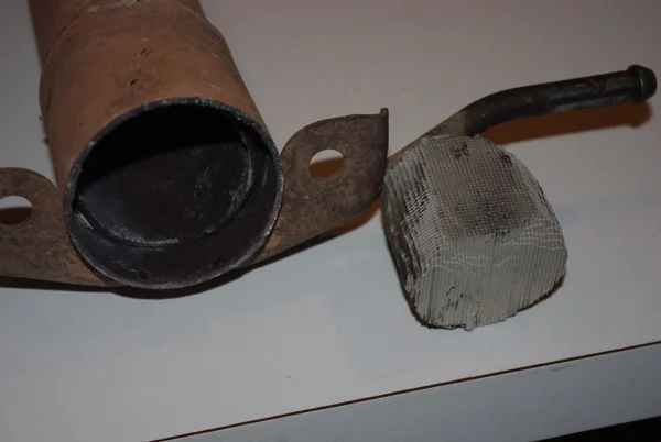

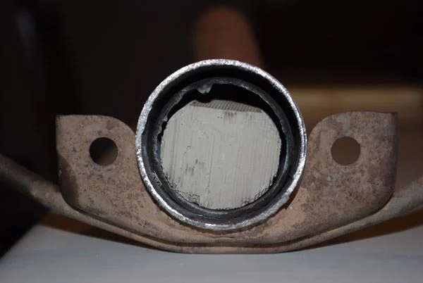

Dan, almost sounds like my when my cat came apart. Here is the thread and a couple of pics.
https://forum.ih8mud.com/nm-high-desert-cruisers/265775-no-powa.html
