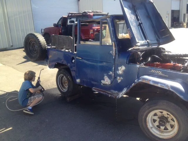

Grabbed this 63 FJ40. It's VIN 2FJ4018104. Has a really clean tub with not much rust. Has an odd looking PTO. Interior not bad. Steering column chevy of some kind. Need to redo that. Has a sweet Denso Clamshell heater and some other goodies. Not missing much. Under the hood it's got a chevy 6cyl. I'd like to eventually put a Toyota motor in there. Did about 3 hours of power washing with my 8yr old son today. Pulled all the seats out. Got rid of the Hillbilly roll bar. Think I can salvage the seat frames and have them redone. Not sure what I'm going to do with it yet. Would like to update the brakes and motor. Keep the rest stockish. My 8yr old already wants it........I see a 7 year resto coming. :crybaby:

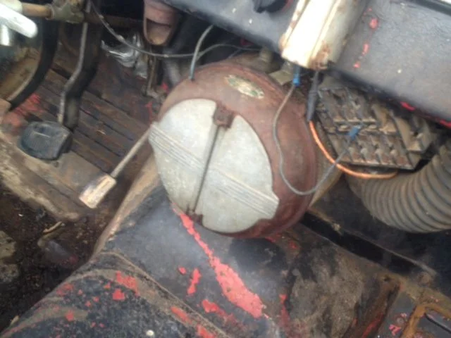

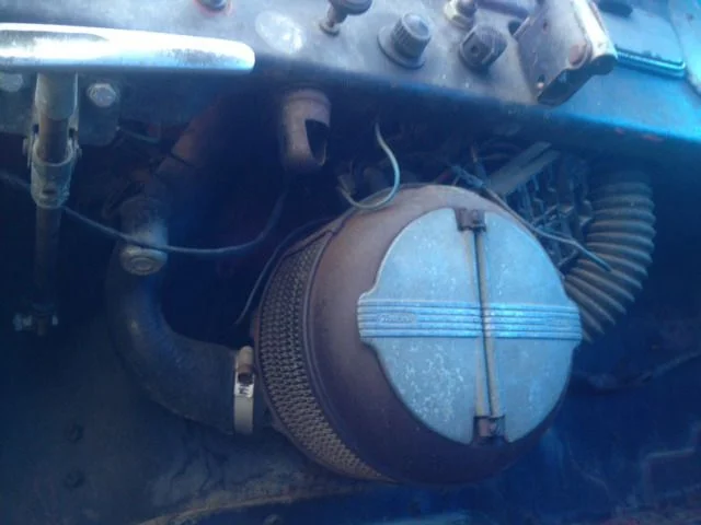

You got a rare stamped bezel! Don't let anybody steal that!
Oh, and that steering box is probably scary...I'd take a closer look at that before trusting it too much. Can you post up more information about it?
Looks like a centered rear diff too - super old school! Nice find!
Centered rear diff, VIN starts with a 2...I think the title is wrong on the year by one. My '64 is the same way, (made in '63).
That's a '62, my friend. The title isn't really wrong, they usually just sat on the lot for a year or two and were titled at the time of sale, in this case, 1963. Nice rare clam-shell heater! Looks like somebody chopped the high B-pillars to put a later top on at one point. You should sell it to me!

Does it have the 12V generator? Or has someone already upgraded to an alternator?

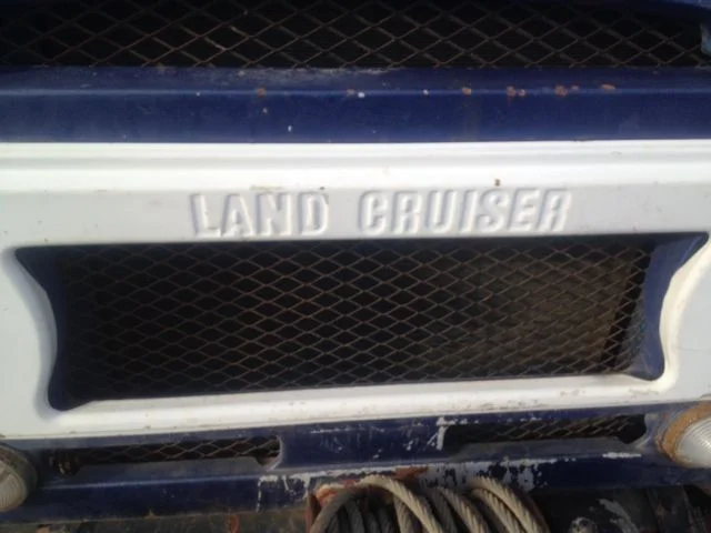

Clam Shell heater...stamped bezel...no Toyota emblem in the front grill...center diff...a 2 in front of the vin, and that is a rare, old 1962 Hardtop titled as a '63 for the exact reason Splangy and Psreno outlined...I've read that in the early years, some of these rigs sat on dealers lots for 1 to 2 years before being sold.
Do the doors have the slide up windows? Do you have no ashtray in the dash? Do you have the corrugated hardop for it with the rear bifold door? Too bad it doesn't have the original engine (the early models had the engine number stamped on the firewall vin tag...does the PO have it hidden somewhere? Are you sure it is a chevy 6?...the early F135 looked like a chevy engine...

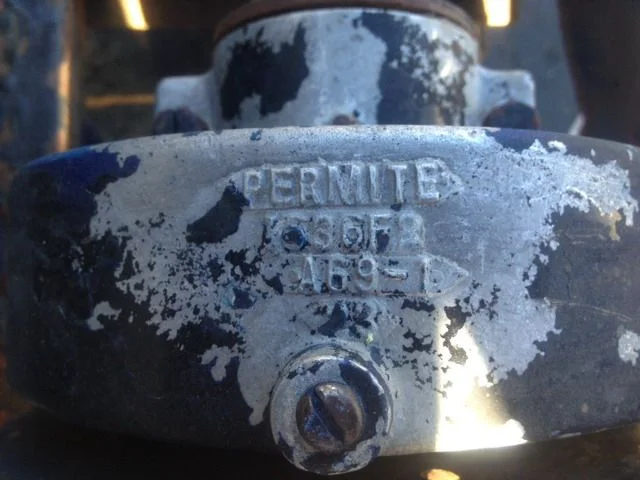

PTO....anyone seen one of these..
Looks like a Ramsey winch. Mounts behind TC and the winch says "PERMITE" on it. Is there only 1 ID tag on the firewall in these years and the VIN on the frame? I can't find a build date..

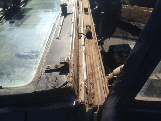

Ashtray and defrost vents in the windshield started mid 62. Those turn signal started with the 63s. So looks like a 63 But I guessing late 63. windshield latch in stead of bolting were 64. Lower B pillars were also 64. But the angle tool box under the the driver's seat and stamped bezel were 63.:hhmm:
Curious which transmission you have. Shifter rods attached to a top plate (later) or two post off the side (early)? Picture of the rear sill and tail lights?

I noticed the lower B pillars that Living In The Past noted...along with missing the windshield latches...Hmmm...went back to look at the pics some more...what are the chances the tub was changed for a '63 or '64 tub?
