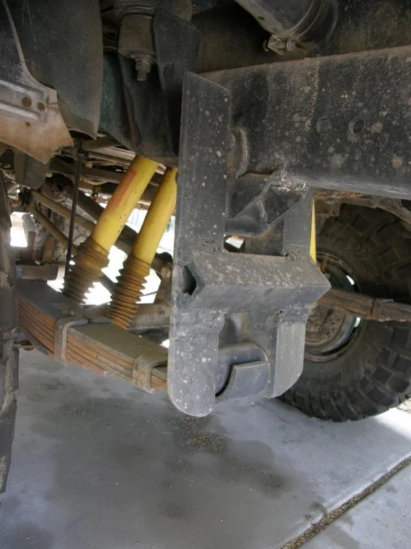

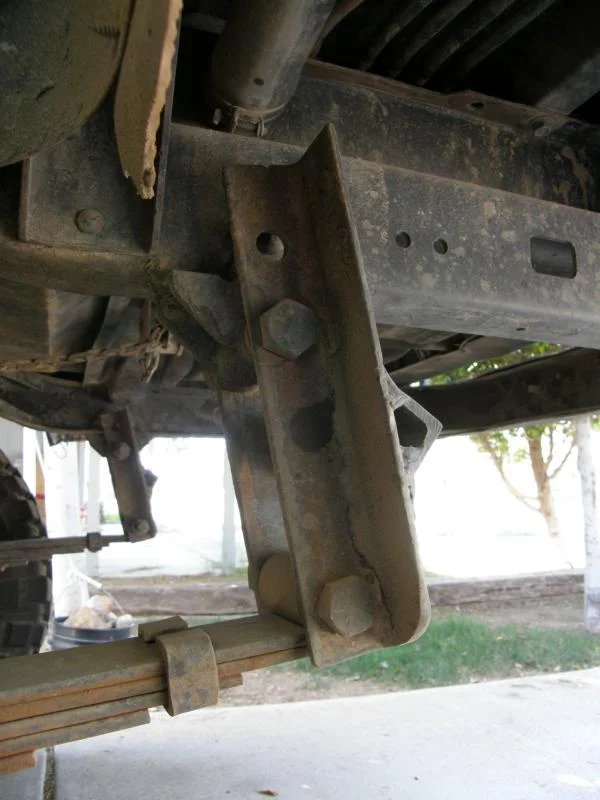

Howdy! I built mine from 2" angle iron. I rounded off the bottom corners so they won't snag on the rocks. I put a crossbar on mine at the center so they make an "H". Some guys leave that off so they can get a little more flex. John
hey John, you wouldn't by any chance have a picture of those would you? I have tons of that laying around. Did your pig get retired, i remember reading a bunch of stuff on your rig.
Howdy! No digital pix yet, but I might be able to snap a couple over the weekend. My Piggy is on extended Furlough right now. I cracked the frame under the Saginaw PS box, so I am building up a sub-frame to hang in there. It it taking way too long to finish up, just too many other things going on in life. No chance on retirement for this Piggy, as I have only had it for 23 years, and I plan on keeping it on the trail/road for at least that much longer. John

Howdy! OK, here goes. This shows two angles on them. Notice the extra hole at the top end. I can extend the shackle from 6" to 8", giving me 1" of lift if I am really loaded up. The bolts are grade 8, 7" x 3/4". I think, whatever the right size is for OEM spring bushings. John
