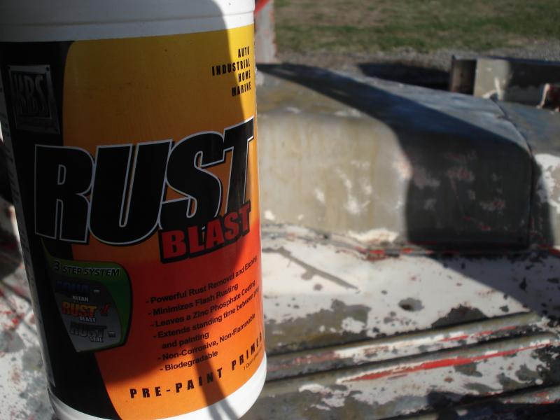

kbs coatings rust preventative process. A few steps but it turns out great.
