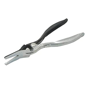

Fwiw, whenever I replace any vacuum hoses that are attached to a plastic or metal nipple, I always grab the hose with a pair if long needle nose pliers. Twist the hose first to crack it loose from the nipple and then slide it off. Works everytime and you won't break any more plastic nipples. plastic gets brittle after 20 years + of daily heat cycles ......
Georg
That's what I did :(
I use a razor and do a longitudeinal slice along the hose. No twisting turning or pulling. Those little fxxxers always break.
