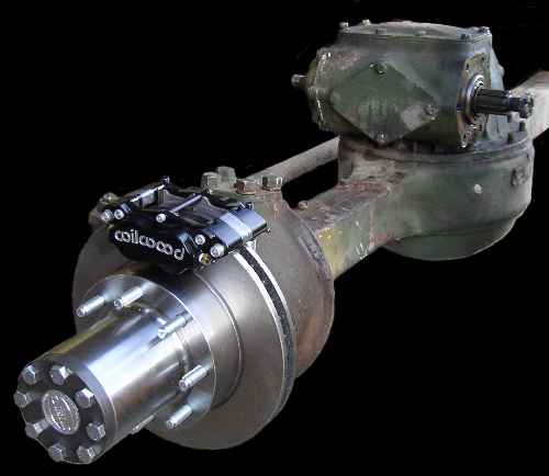

What we all really want:

I ran rockwells in my chevy 20 years ago. And I did break the FF rear axle shafts in them just the same! :flipoff2:
