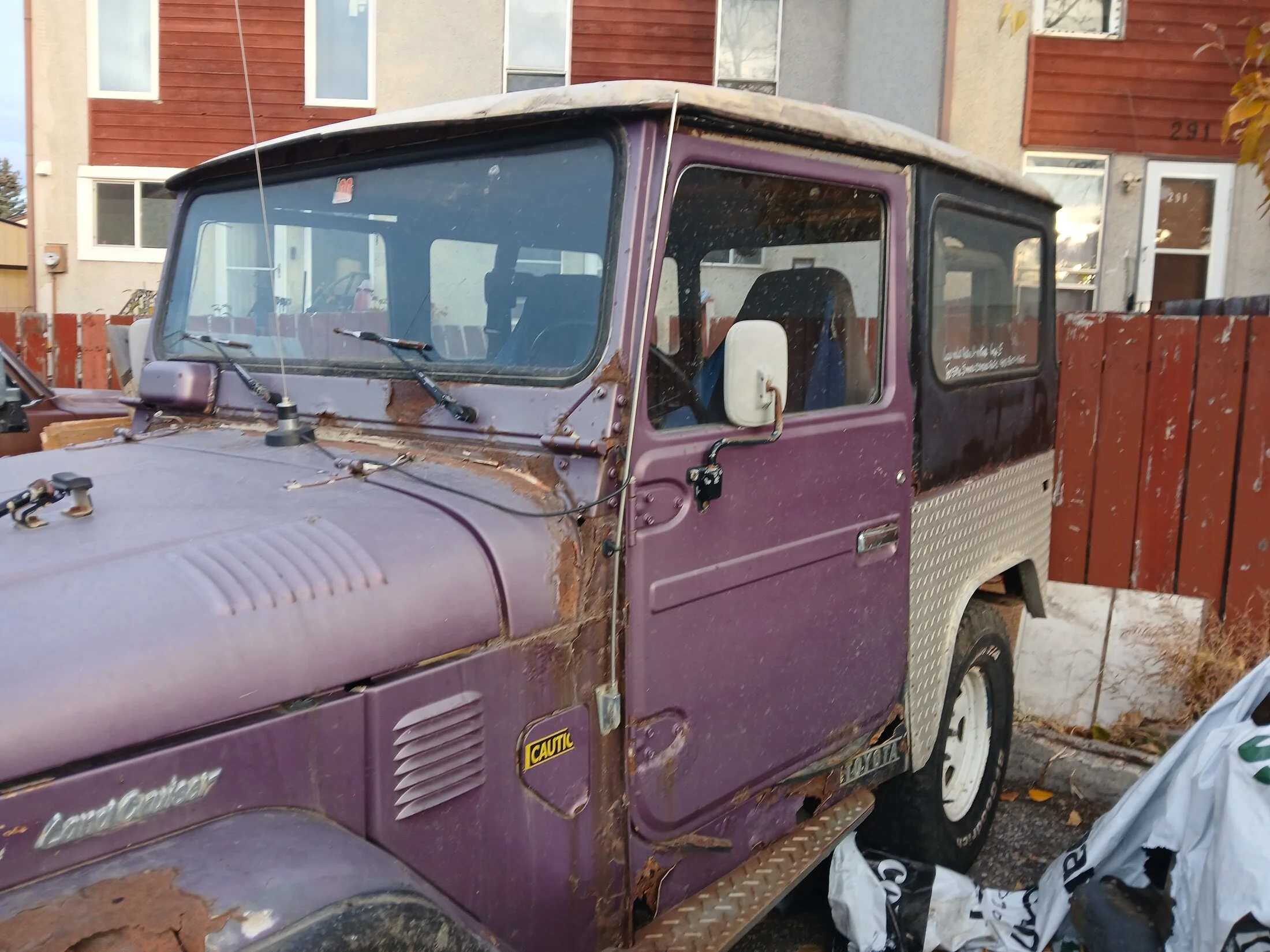

On a whim and completely impulsive I bought a 79 fj40.
The transaction was quick and the interaction was very agreeable, looks like the seller , a decent guy and I have mutual interests as he has another 40 he wants on the road asap.
Upon a little inspection she is a hurt'n and needing some luv'n !
1/4 panels I think and look to be pooched, inner fenders, no fender support and the front end well...
The good is the motor seems strong and idles nice, solid frame, so I have a decent platform to rebuild and save another Cruiser.

Did you buy that off Liam? He had it on a trailer at our Calgary meet-up in early October. You don’t see many purple Cruisers so it kind of stuck out haha.

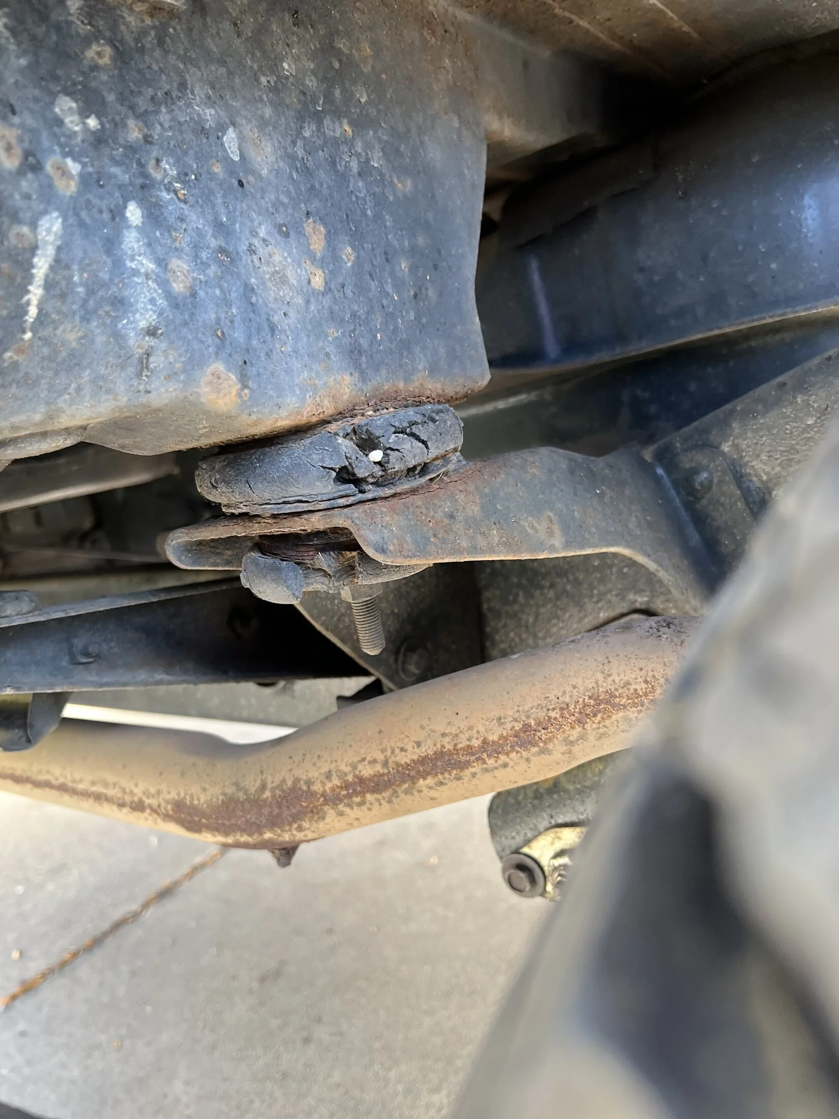

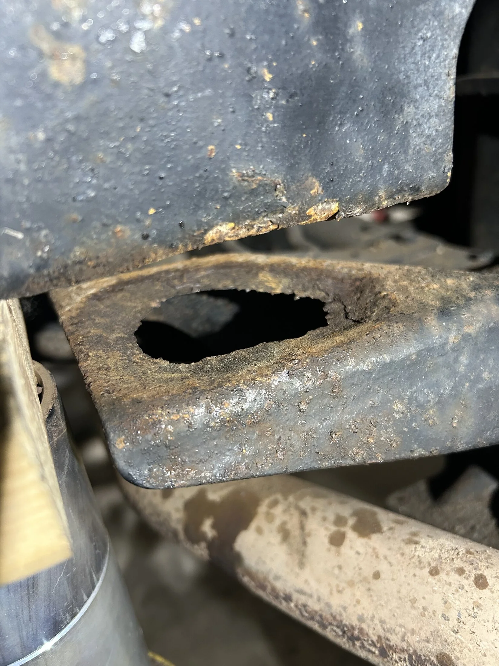

How are your body mounts ? located below driver and passenger seat. They can fill with mud when off roading and then rot out. I did replace mine in my 1983 bj42. I'm not sure if anyone makes a replacement but I guess anyone could just fab up a replacement.

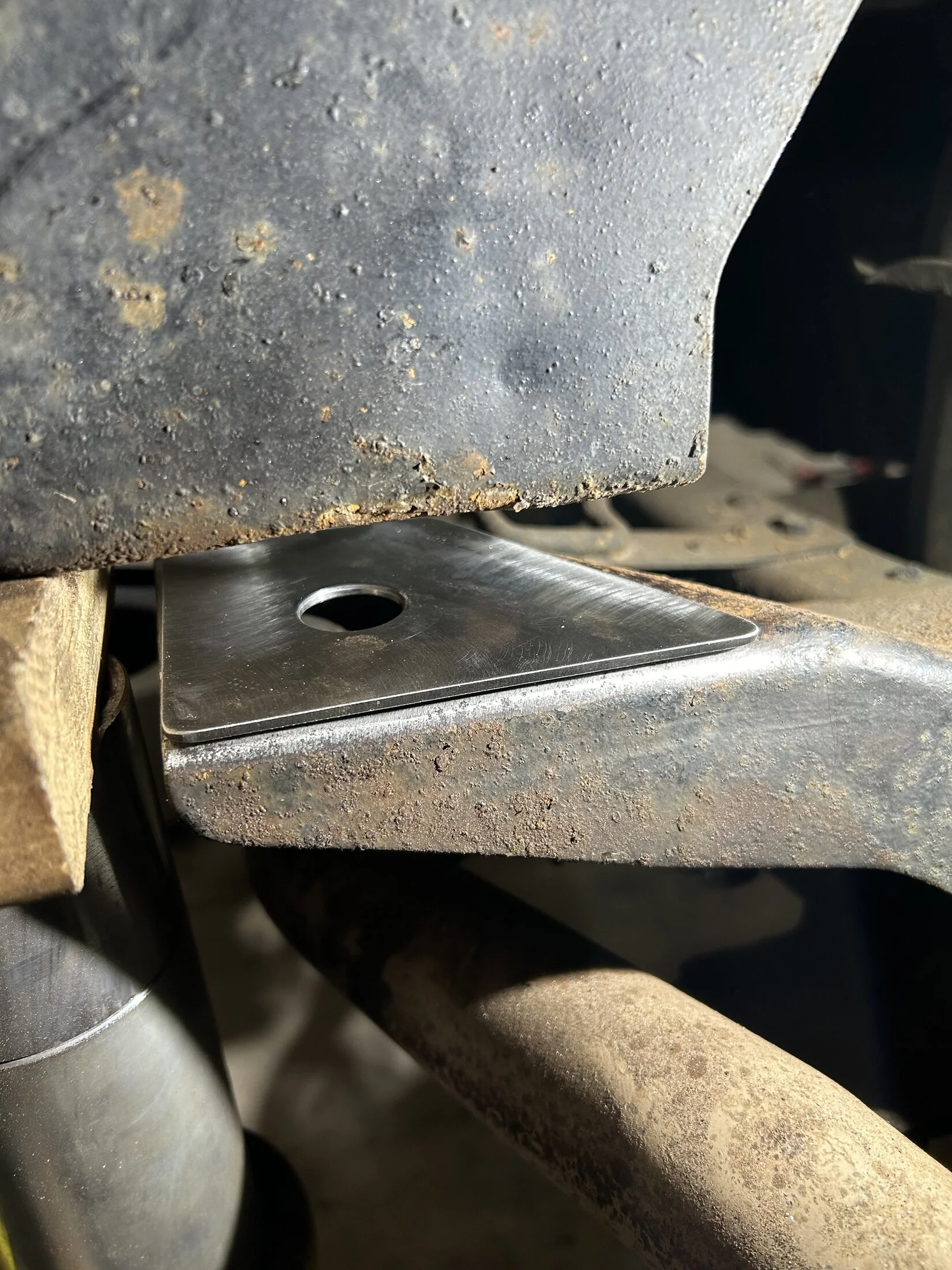

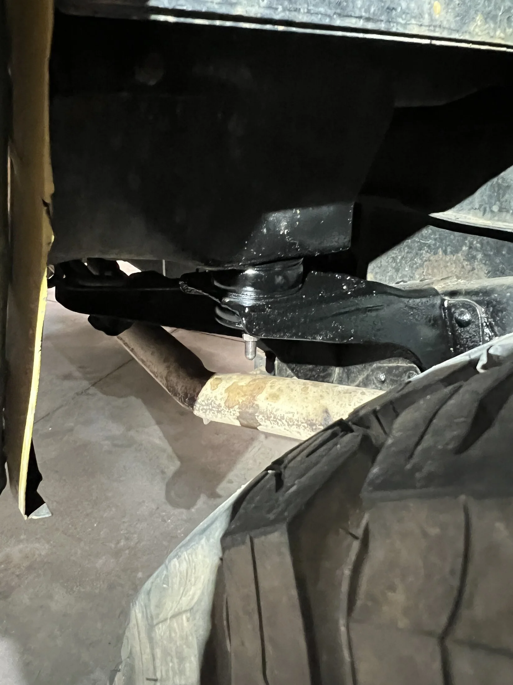

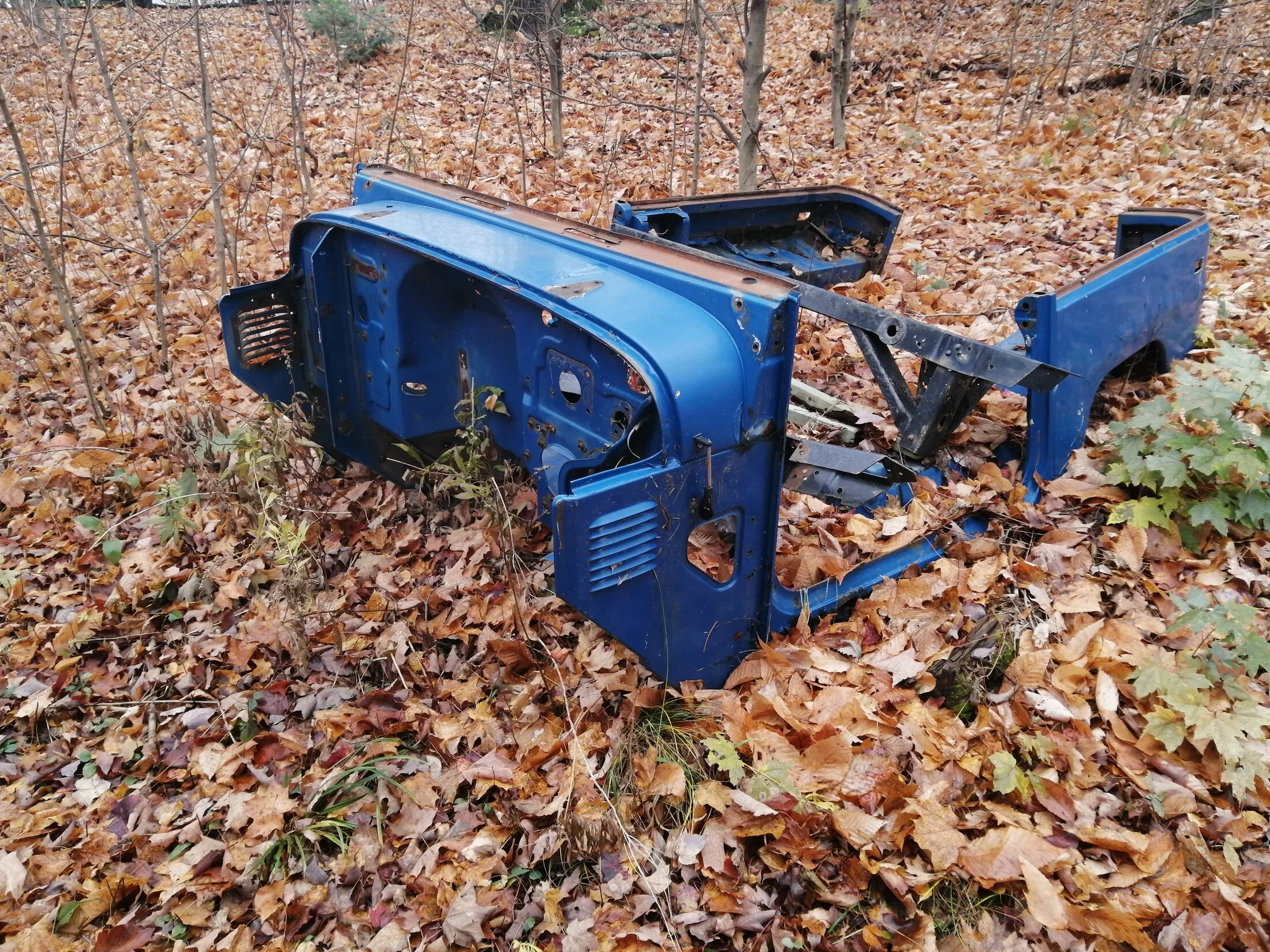

Tackled them this summer and a quick patch to the frame when doing my body mounts. Could not get to the #3 mounts easily so saving those for another day… (I went with OEM)
Sample starting point
And
And
And

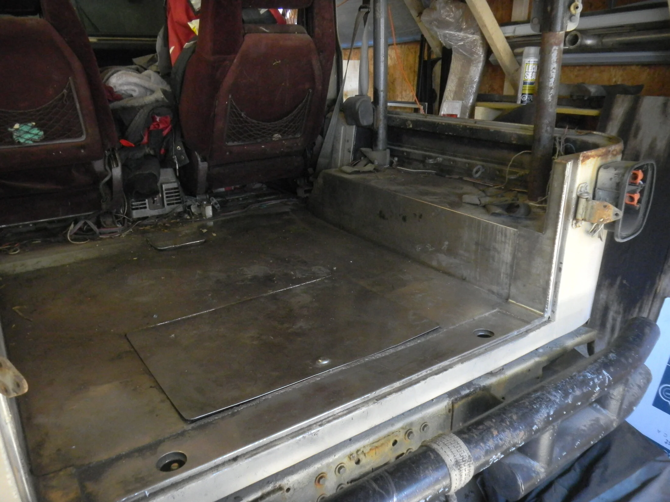

enclosed is a current pic of my stainless 42 that was fab'd in 1995.
Sample starting point:
And nice mount @OlYellr.
