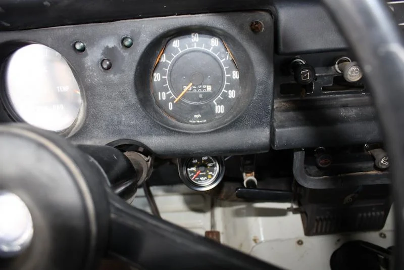

Final pics of the installed mechanical oil pressure gauge and the overdrive sticker on the dash that helps ID the overdrive as a Berens-Hone-O-Drive????

Manifold vacuum should be in the neighborhood of 20 (inches of mercury) ideally...the hiss from the brake booster is probably a bad diaphragm. Maybe disconnect the brake booster and plug it's vacuum source and re-check.
An oilpressure of 5 (PSI) is a little worrisome, but if the engine is hot may almost be normal. Oil generally just drips from the rockers... Wonder if maybe you could adjust that oilpressure relief valve and bump up the pressure a little? Make sure you didn't plumb it backwards too.
I realize you're an air-cooled guy, radiators traditionally overflow as the water heats up. Most Pigs did not come with an overflow bottle. Most owners buy a generic overflow bottle and fit it in near the radiator cap...

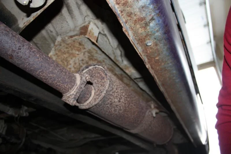

Muffler heat shield: I noticed on my short drives around the block that the driver's side floorboard above the muffler/exhaust heats up - a lot. A friend had mentioned this happens on his FJ55. Is there a common set-up to help w/this? I don't want to melt the sole of my shoes!

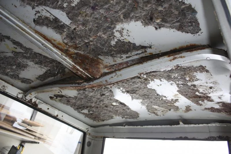

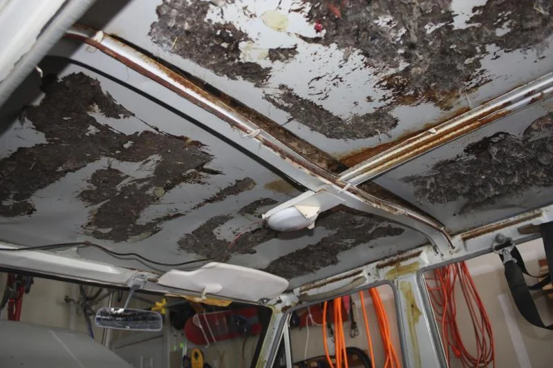

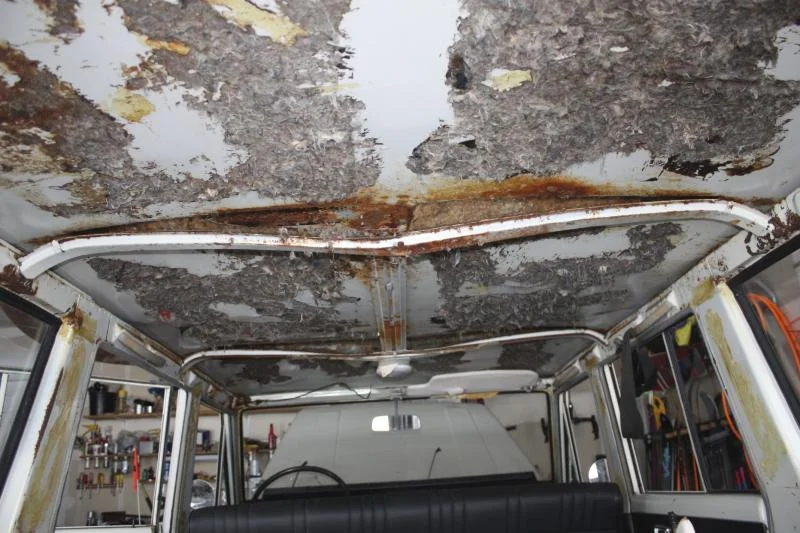

Roof: I need to pop the roof back out/up. Also the 2 main roof supports are sagging. Is it common to add some sort of reinforcements to these supports or the roof in general to help it keep its shape?

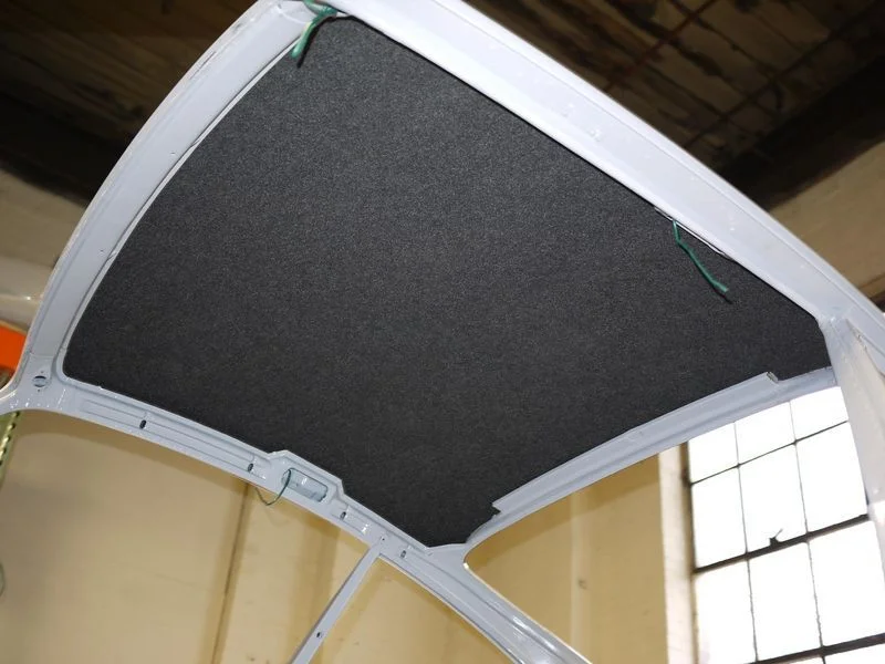

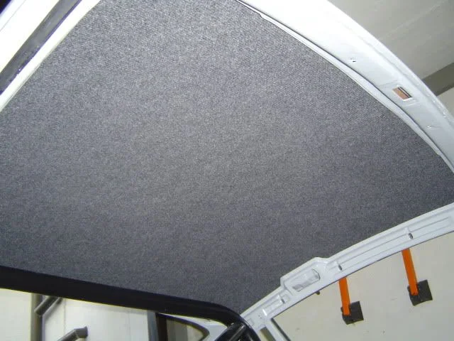

Pics of perlon carpet type headliner:
Couple comments on some of your questions-
-I would not use carpet on the dash pad. The PO of my FJ40 did this and it traps dust etc. and is nasty. Personally I would rather deal with a cracked dash pad than one with carpet on it.
-If those wiper arms are the same or similar to FJ40s, you shouldn't any trouble finding wiper blades for them. The NAPA local to me happens to have a bin of wiper blade connectors, and the guy was able to dig through and find one that was the right width/thickness to fit on my arm. No problem.
-Electrical. Start with pulling all the fuses out, one by one, checking their amperage and that they're not blown, and clean the fuses and the fuse block with some scotch-brite or similar. And then see what happens. If you still have no luck then move to your grounds.
-Headlights - IPF/ARB makes a harness upgrade that you can purchase through Kurt at Cruiser Outfitters and other places. The tech links page also has a writeup if you'd rather buy the parts and assemble the package yourself.
-Checking the fresh air vent is probably a good idea - the mouse will probably disappear with time and more cleaning...

Is your muffler in the stock location? Mine was between the DS frame and rocker...and did have a heat shield.

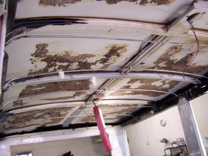

Here's a pic of the extra roof support I added. Also added an additional stock dome light in the rear.
are you planning on a stock barrel muffler? if so, i'm pretty sure i still have the stock heat shield on the pickle. i'm not going to run the barrel muffler, so it won't do me any good, you're welcome to it.

roof: I need to pop the roof back out/up. Also the 2 main roof supports are sagging. Is it common to add some sort of reinforcements to these supports or the roof in general to help it keep its shape?
it's not a true pig if the roof isn't caved in. i'm doing the same thing as many and adding extra stock braces.
Headliner: I don't think I want to endure reinstalling a stock headliner right now, but I do want to put something up there. I was thinking about some heavy felt or perlon carpet. I've seen it done on vintage race cars and I think it looks good. . . see pics below.
didn't like the idea until i saw your pics. that actually looks pretty good. good luck cleaning all the old crap off the roof tho :eek:

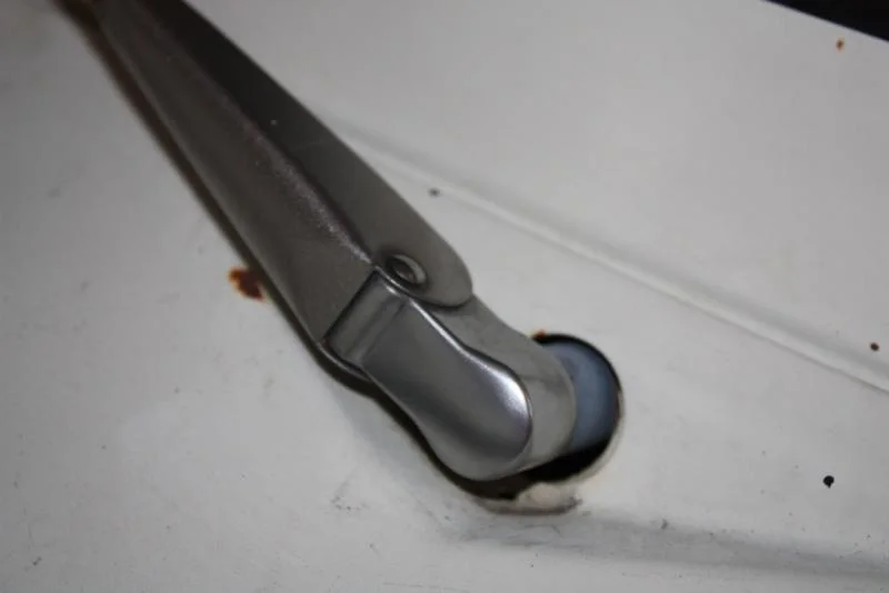

Wipers: turn on and work fine, but the arms are broken and have no blades. I did some searching and am not exactly clear on the path to having an arm that accepts non-specialized blades. Is there one? I'd like to end up w/an all-season wiper that's easy to find replacements for.
most anco (crap) winter blades come with an assortment of adapters, i know i found a set that fit the 55. from there, you can use a decent blade with the anco adapter

And nuclearlemon - It looks as though I may actually already have a muffler heatshield - see pic below. Is it common to add heat reflective material underneath to help w/heat transfer through the floorboards? I hate to add a dirt/water catch underneath, but I don't want to melt my shoes either!

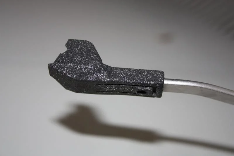

Also have a quick wiper question. In the pics below, is the plastic end piece replaceable or do I need an entirely new arm? Is this the adapter part that comes w/some wiper blades? Also, How do the arms come off the wiper studs? There are no visible nuts - do I need to be more forceful w/the cover?
As I can only post 3 pics at a time, see next post for more. . .

Roof supports.
Trying to get a game plan for the roof. My supports are sagging in the middle after years of being loaded w/snow etc... Some solutions I've thought about:
Having a sheet metal shop friend create some straight sections that I can splice into the existing supports - maybe the middle 30"-36"? I don't know if the supports have any kind of continuous curve or not. Replicating straight sections would be pretty easy, as would welding them in. If they are curved however, fabricating becomes less straightforward. I really like the idea of adding an additional support or two. I've made a few inquires about sourcing extra supports, we'll see how easy they are to come by.
Are these supports supposed to be welded to the roof panel itself, or do they simply sit below the roof? I can't tell from mine if they were ever actually attached.
I also like the idea of adding an additional dome light in the rear. . .
Here's what I'm starting with. It's kind of hard to tell from the pics, but the roof still needs to be popped back out - hopefully it'll remember its original shape when I get to that.

the plastic is an adapter from an aftermarket blade
the back of the wiper arm is a small cover that rotates up (towards the arm). there will be a nut under there
Re: your roof, mine looked much the same, caved in three different places and cross braces bent down, though not quite as severely. Roof was popped out as much as possible, then finished using conventional body shop techniques and minimum filler. The braces were straightened using porta-power pressure. Mine had what appeared to be a stock carpet-like strip between the brace and the roof skin to prevent "oil canning" and the upholstery shop put in new insulation before installing the SOR headliner. Turned out great.
If you install a second stock dome light, you'll need to place it on the front side of the rear brace. Otherwise it'll interfere with the headliner suppport rod. Nice to have the additional illumination over the cargo area.
