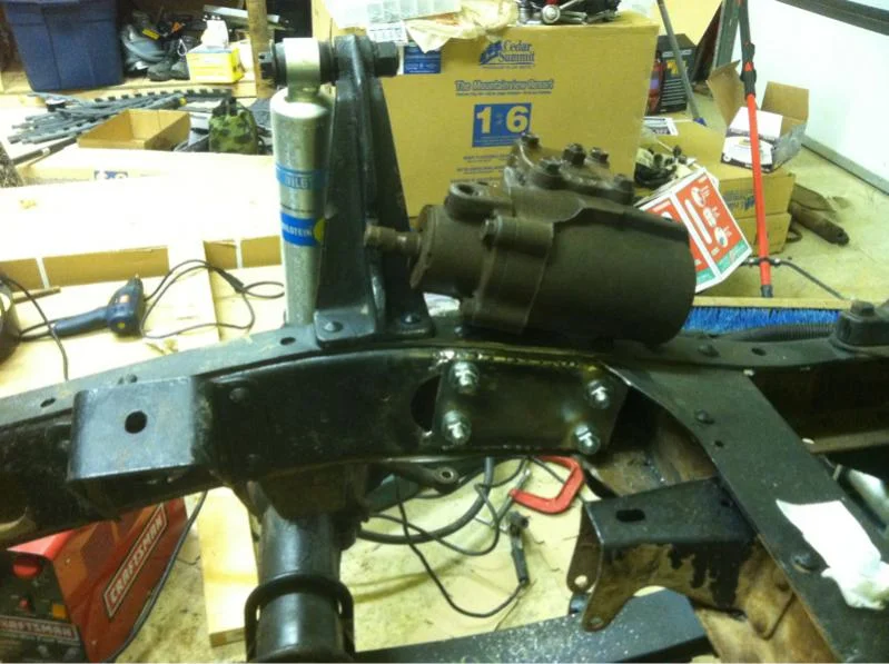

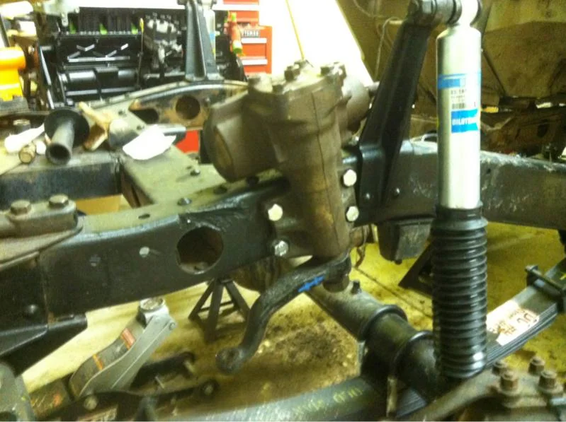

You need to mount the FJ6X box in front of the shock tower, and will need grind out the inside rib of the shock tower (or use a Ford shock tower) You also need to weld a plate to box in the frame on the inside. You will need a 70 series relay rod end 45044-60H03 (Cruiser Dan can get this for you) to tie into the tie rod. I am using a 3FE which came with a power steering pump. Not sure what engine you are running but that will determine your pump path forward.
image-1835621345-jpg.621118
image-1590159366-jpg.621119
