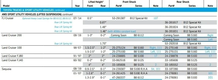

fronts Part Number: 25-275100 , Part Number: 25-275124
rears Part Number: 25-275131 , Part Number: 25-275148
Who was the source?
Google any of these part numbers and the bilstein catalog website will pop up. Download the pdf. These are definitely for 98-07 Land Cruiser.Who was the source?

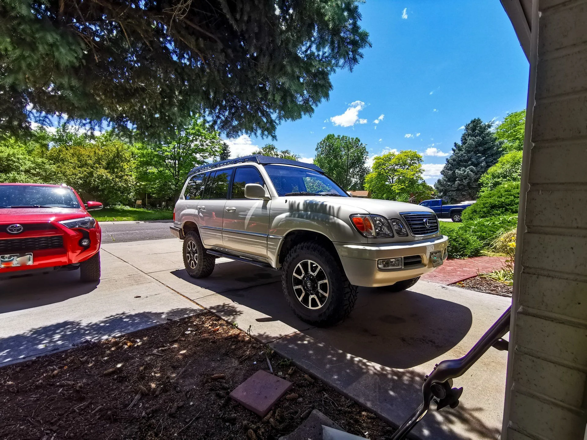

installed some bilstein 5160's with ome springs and over all I'm pleased I have yet to get any trail time but on the street with E load duratracs not bad, shocks are semi soft but handling is fine with some rake . Coming from AHC im disappointed to say the least but budget played a big role here.
Rear shocks are slightly longer than AHC and fronts are the same.
Poser shot with unnecessarily cranked torsion bars
ALL in are you happy going away from AHC? was your AHC working perfect?
how much did you spend all in for the suspension?
looks SWEET!!
