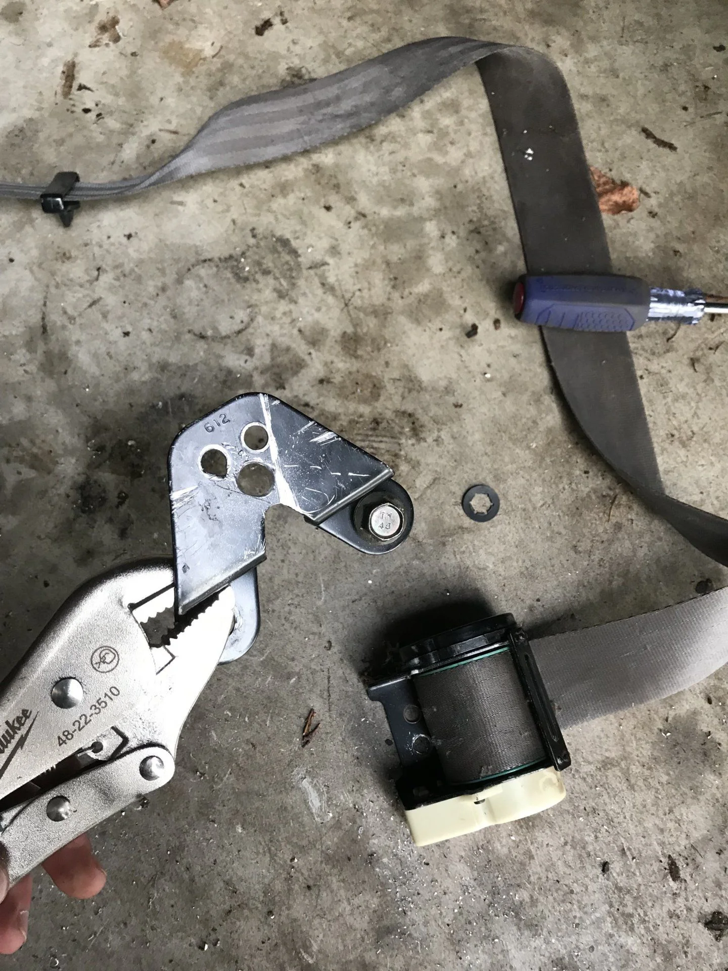

Needed new belts so I came up with this.
Belts from SeltBeltsPlus.com
1st picture White arrow is OEM braket mounted on new belt after cutting off tab on top, see old belt... Red shows what part of old I used cut off blade to remove from old belt so I could use OEM screws...blue shows where I changed angle of old mount to a true 90 so belt would clear the door frame

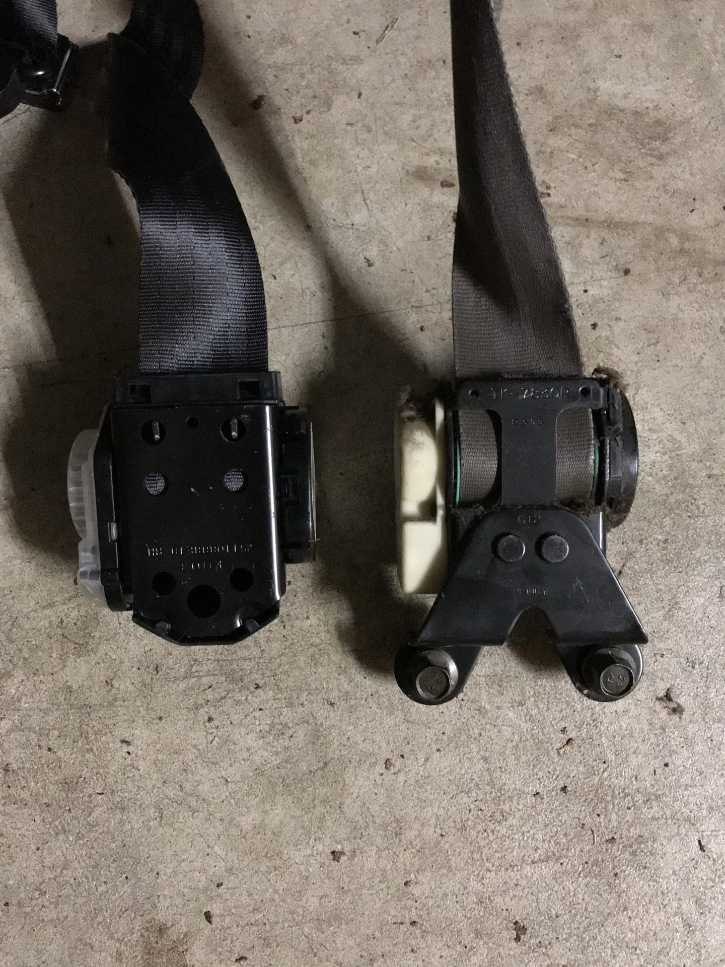

Hey Guys,
This thread and a few others seem helpful for 60 owners, but has anyone with a 62 tried this? I have a 1989 62 and bought some replacement belts from seatbeltsplus.com for the rear, without looking at the stock mounts...
Ive attached 2 pictures of the stock and new mounts, and as you can see the stock mounts have a 2 bolt extensions piece. Has anyone figured out how to mount new aftermarket belts?? HELP PLEASE
Drill those divots on the OEM retractor and swap to the new one.
Or, build a bracket to bolt them to the quarter panel.
You may be also able to return the retractor and have seatbelt planet re-web the OEM retractor. I went this route when adding rear shoulder retractors to my 83 FJ60

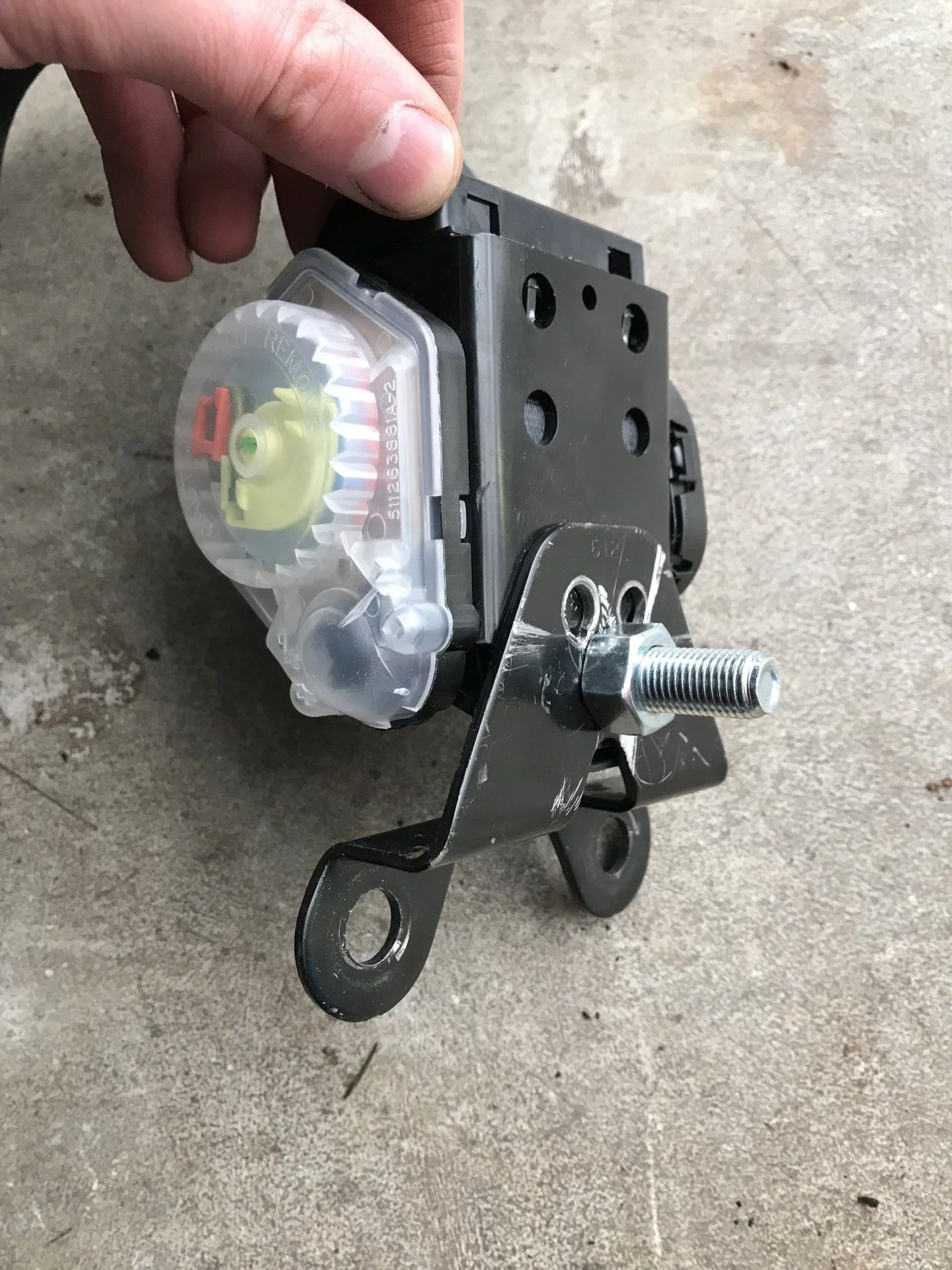

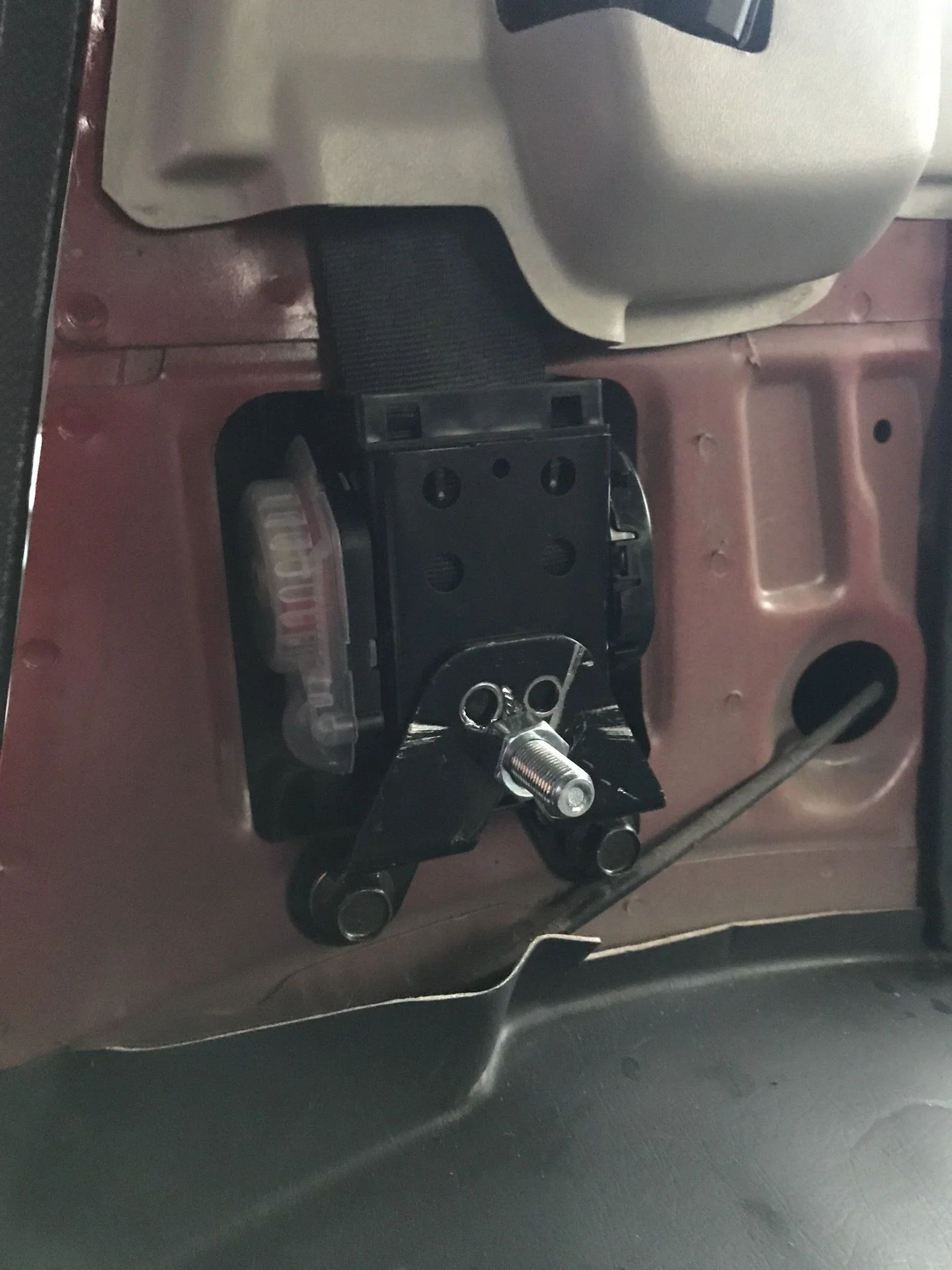

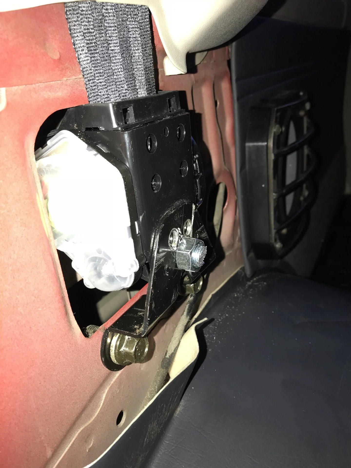

Hey Guys,
Figured I'd share my solution for fitting the universal rear seatbelts into the FJ62. I followed @NookShneer advice and drilled out the divots on the stock bracket, and then drilled a new larger whole for the new bolt (had barely enough room).
The new seatbelt just barely fit, and then had to saw off the excess bolt so the plastic cover could fit over top.

Nice! If you flip the bolt around will you get better clearance on the cover? Might add a fat washer to spread out the force since you have (looks like 4-5 mm) only a little metal before the rivet holes?
The reality is that the top anchor point is taking much more force than the bottom but still, would be nice to not ever think about it again.
