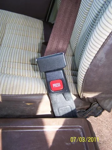

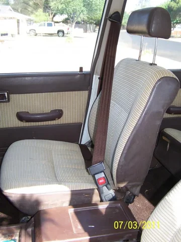

Needed new belts so I came up with this.
Belts from SeltBeltsPlus.com
1st picture White arrow is OEM braket mounted on new belt after cutting off tab on top, see old belt... Red shows what part of old I used cut off blade to remove from old belt so I could use OEM screws...blue shows where I changed angle of old mount to a true 90 so belt would clear the door frame
2nd picture shows the braket I got from site to mount to bottom of belt to floor
3rd shows pin I ground off to use OEM braket on the short section of belt that has the releasr button. I will have more pictures if I can figure out how to upload more then 3 and BTW they work great and fit perfect. Now I will build up some covers to replace my old cracked ones to cover the lower belt on door frame, dont know if I with texture them or cover with something. Going to make some molds to make them out of filberglass so it it works might sell some here if people need any? :cheers:
Thanks for posting the detailed picks, my front seat belts are ready for replacement also. How smooth is the operation of the new belts?
Peter
It's SeatBeltsPlus.com...sorry haven't figured out how to add links:hhmm: They have different styles..the 3 points ones for 60 something is the ones I used..you will need one of the assy kits also because they say they don't come with the belts so I ordered 2 and got 4 so maybe they threw in a couple with the belts anyway:confused: the kits have the L brackets and bolts.

Well I finally got around to doing this, too. Mine was a little different since I have a 5/85, but it still works fine.
1st pic is OE seat belt vs New aftermarket from seatbeltsplus.com ... Same as EW.
You can see the bracket is a different. Just grind off the small rivet in the center and the thing pops out.
Drill a hole in the bracket to accommodate the bolt that comes with the seat belt hold down kit and bolt to re-tractor mechanism.
I could have cut off the top of the bracket, but I just bent it out a bit and it clears the belt so I just left it alone.
More.
Overall, this is easy to do, but I have to say the quality of the OE Toyota belt seems a bit better than these aftermarket ones. I suppose they have to meet DOT specs, and they're USA made, so I'm not worrying about it. But were I to do it again, the cost of the OE belt is about $50 more than the aftrmkt, so I might think about just spending the extra for the Toyo belt.
