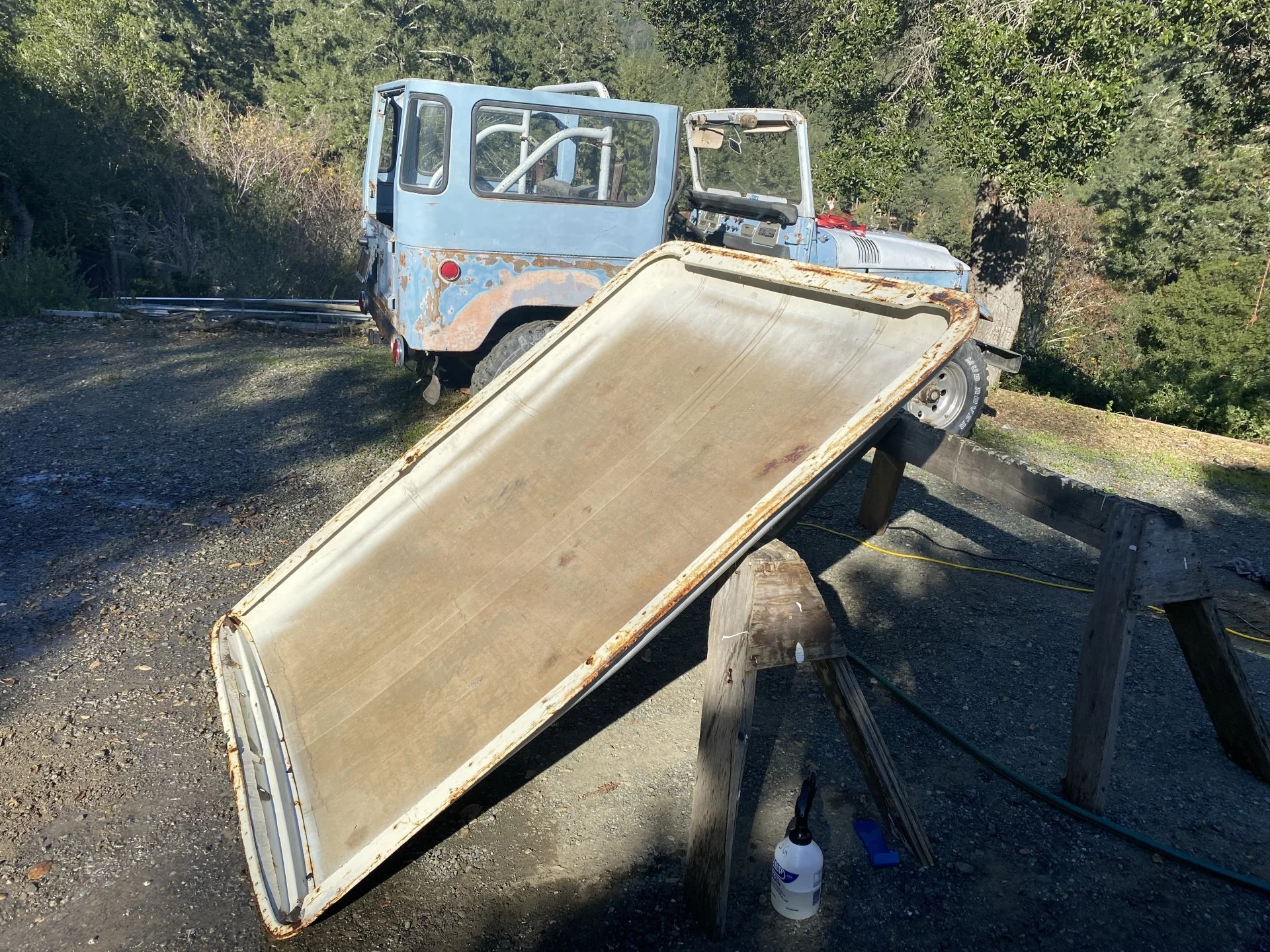

I pulled the top cap off and scrubbed the ‘headliner’. I chased all the threads and reinstalled it, along with the door spreader bars.
One issue I’m having is that the more I get the top on, I can’t get the angle brackets on the windshield (for the door bars to attach to) to fit right. The top seems too narrow.
I also put the doors and hatch back on and vacuumed out all the oak leafs.

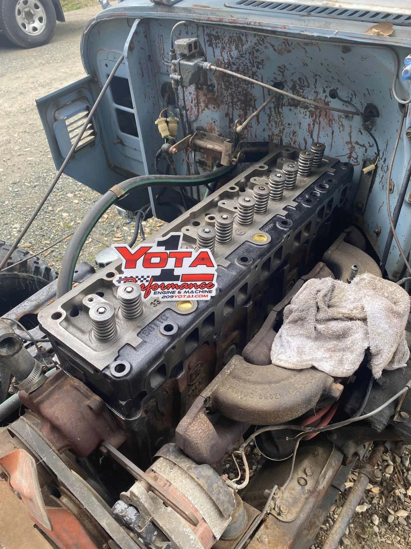

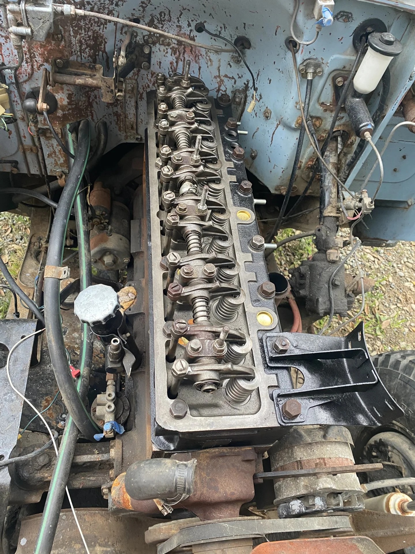

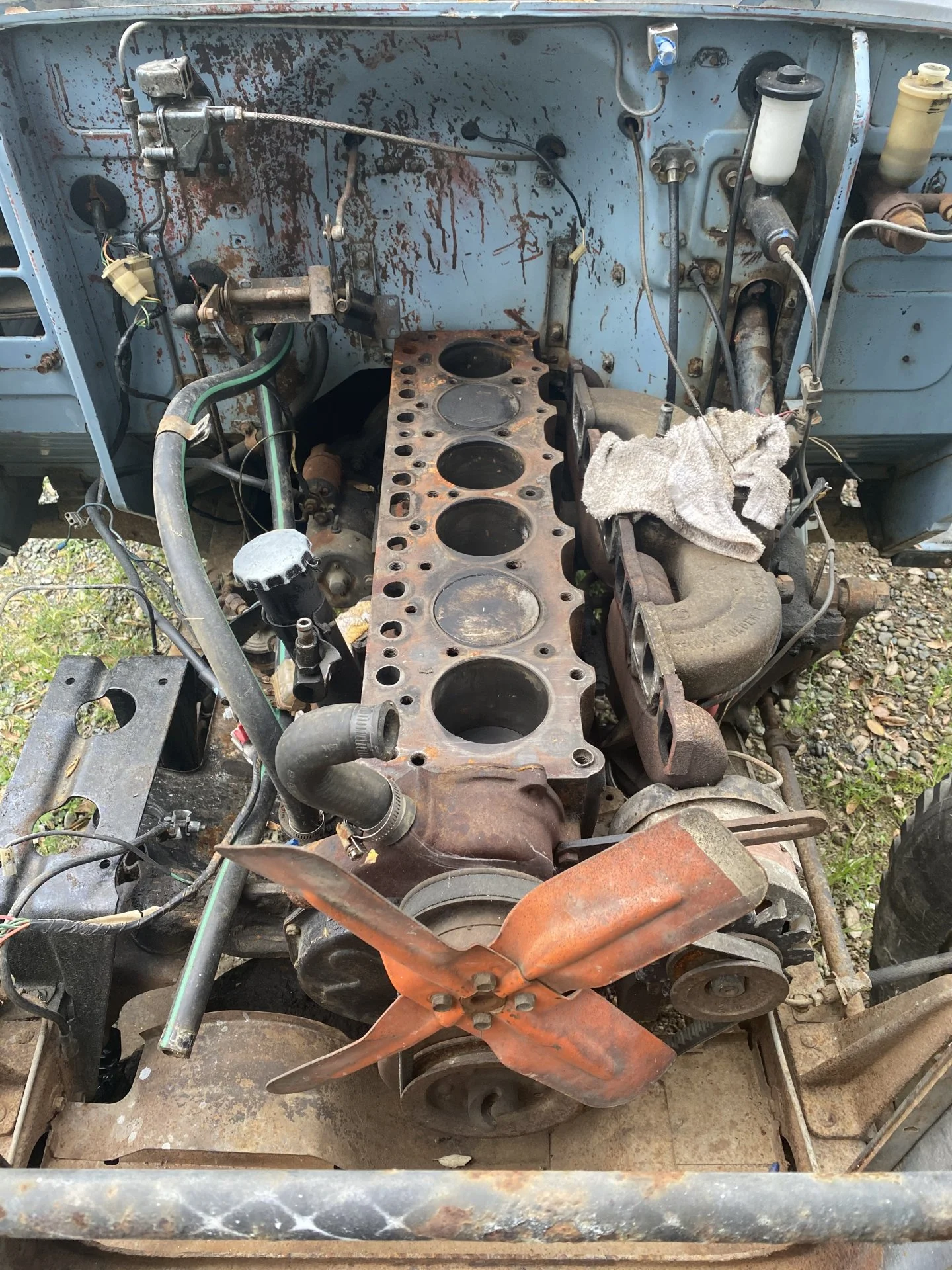

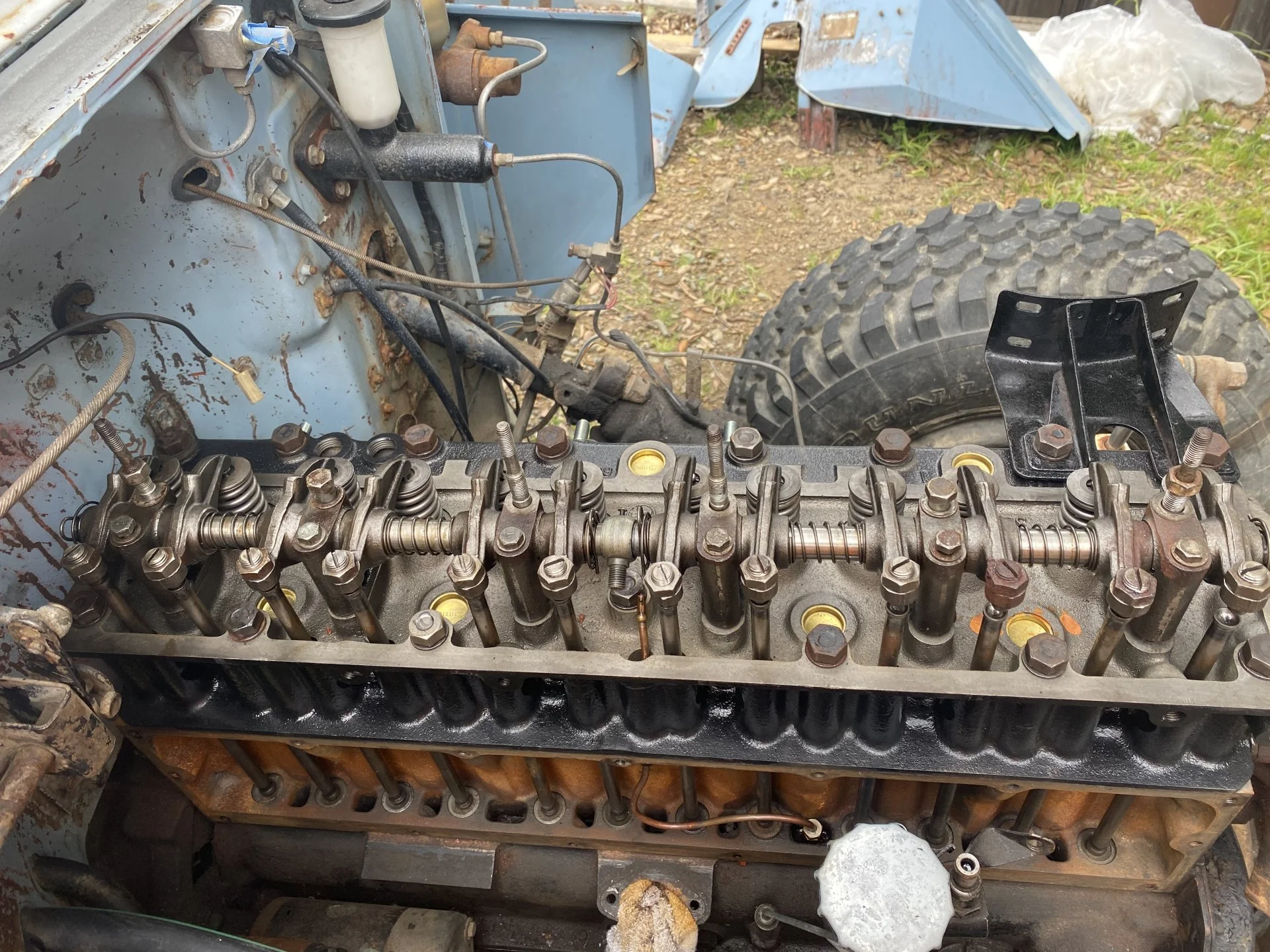

My headgasket was blown. I think I cracked my old head trying to remove it, I tried prying up from the ports and cracked one inside. The shop had re done the whole thing before realizing it because it was in an odd spot.
This is a refurbished head. I’m sure I did something wrong along the way to mess up the threads somehow. I’m just kind of bumbling my way through this...

No white smoke, it ran pretty good. Then it started stumbling.
I had seen the milkshake earlier and was hoping mine was condensation as well, but it wasn’t.
Did you see any milkshake on the top of the head, on the rocker arm or valves when you took valve cover off? Was the blown part of the head gasket obvious (clear pathway for coolant to get to the oil pan)? Did you see coolant in the oil in the oil pan? Were you consuming coolant somehow? Thanks. Paul
I didn’t run it long enough to lose coolant but it was low. The rockers were milky and rusty. The gasket was noticeable where it failed, somewhere up front.
