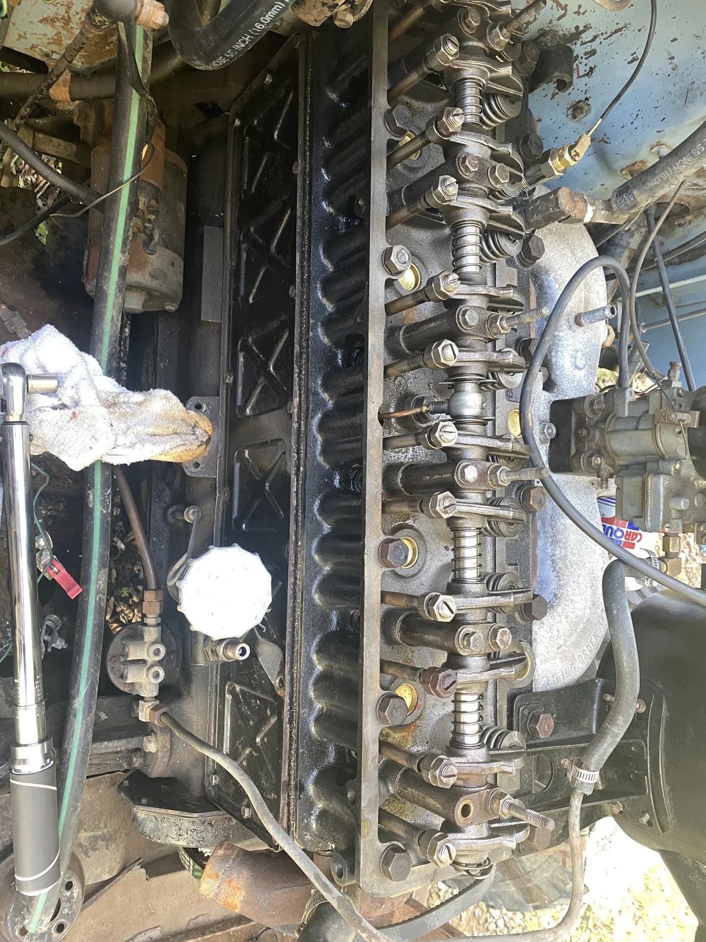

Pulled the rocker arms off. Retapped the bad 8mm hole.
Didn’t work.
Wondering what the best solution for the 8mm bolt hole is, and hoping there’s not more bad ones.

Is it one of the holes in the head for the rocker assembly? Might need to add a helicoil.
Yes. I’ve been advised to use a tine sert. Just bugs me that I somehow screwed up a freshly rebuilt head. Exactly why I didn’t want to do this in the first place.
Popped the rocker arms off again to prep for time-serts for the stripped threads.

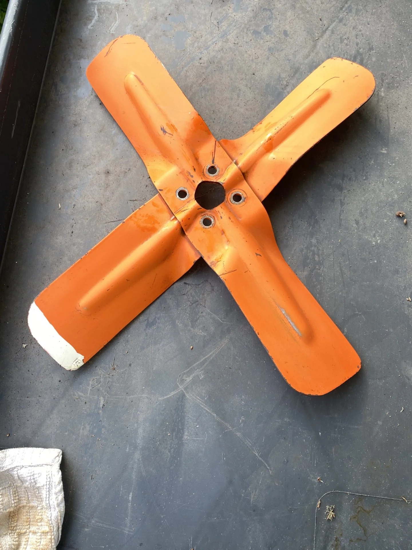

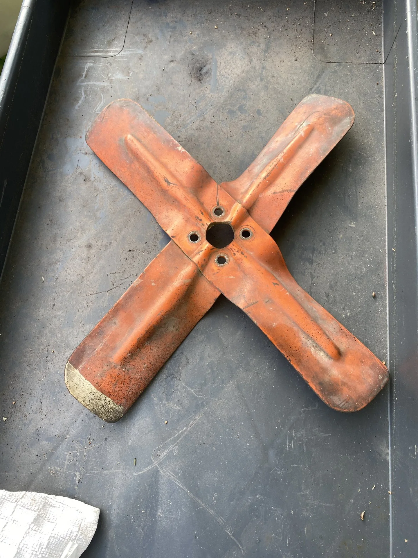

Cleaned the fan since that actually gets results versus my poor mechanic skills.

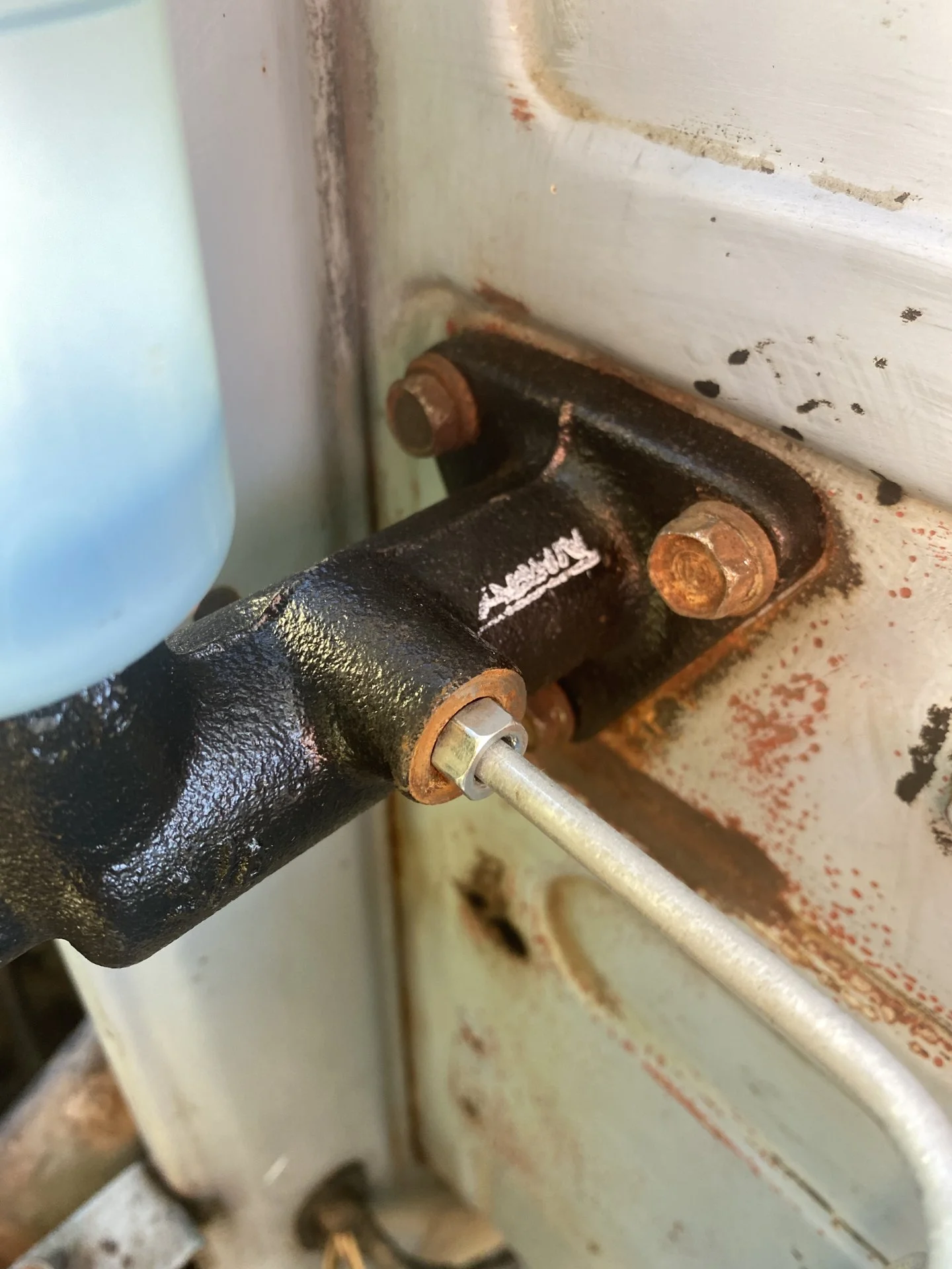

I can’t get the number 9 valve to adjust before the screw falls out, and the clutch master cylinder setup from ccot has me scratching my head. Do the hoses really just hang out loose like this? The pipe to cylinder connection seems wrong as well.
I think you are missing a "copper" 90 degree fitting from the clutch master. Also the lines go to the tab sticking out to the left in the pic. You can see the soft line open where they marry.
This was supposed to be a complete ‘upgrade’ kit that didn’t need anything else. The old T doesn’t fit in the new master.
I just looked at their complete kit, and just think you will have to bend the line to fit. BTW their kit seems different from most other vendors. But I don't think hanging in the air will harm anything either.

I just looked at their complete kit, and just think you will have to bend the line to fit. BTW their kit is different from most other vendors. On others, the hard line only has 2 angled bends in them not curves. But I don't think hanging in the air will harm anything either.

That’s pretty stupid of them if so. Thanks for the tip though.
Also, maybe Mr. T used later 7/70 components in your build making it different/difficult to buy the right parts. Our 6/70 build has a lot of later stuff that was installed in later years (6/70 was a transition month) so I am constantly re-verifying stuff with vendors. I am constantly told "I shouldn't have that..." but I do! It's an all original 36k mileage vehicle. 🤷‍♂️
I know my motor has been gone through before. Mismatched bolts, etc. the truck as a whole seems to be stock 02/69 except for the wheels (and bodywork lol).
