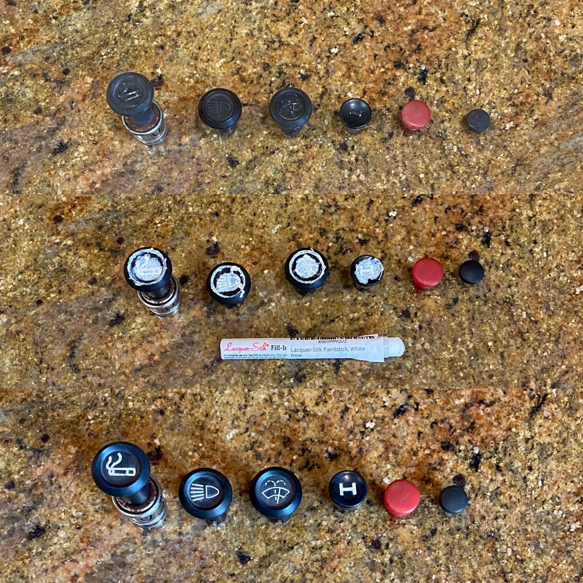

Did you just use palmolive and water to clean up the white on the faces of each gauge? Looks good! Im always afraid to clean those as I have a history of using a cleaner that removes the paint too :(

I tried that and purple power on a q tip.
I was worried about the same thing.
thanks!
Be careful on the easy off oven cleaner! Took more than the top layer of paint off mine.... went all the way down to metal.

I plan to be very cautious. I think the passenger rear quarter is bondo’d like the driver side. I’m going to experiment there first.

ok so purple power wont damage them then? is yours dilluted? I wanna do this right.

I don’t think I diluted it, I normally don’t. It might be simple green purple stuff from Home Depot.
I was kind of winging it because they were so bad anyway I figured if I screwed one up I’d need a replacement regardless.
For $1.00, I have a speedometer needle I can see again. I did the rest to match even though they weren’t bad. A bit more red than the originals, but I’m not concerned.
