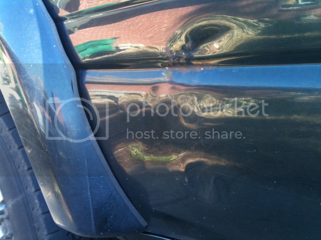

I'm about to start prepping my 80 for paint and I want to pound out a couple dents the best I can.
What's the best way to prep the car?

The rear dent I think I can pop out alright but the door is going to be some work.

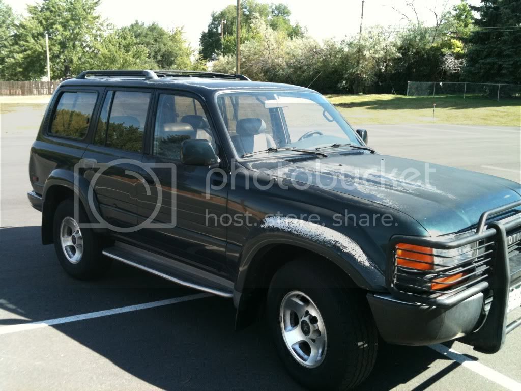

Noticed in your picture of your LC that most of the paint damage in on your hood.
I noticed that my LC is very hot under the hood (even after complete coolant system replacement) and mentioned something to Lance at Iron Pig. He told me that LCs are very hot under the hood hence the black insulation hood liner. Apparently its not to keep the engine warm in winter but to protect the paint job of the hood! He also noted that is why there is an insultation box for the battery!
So check to see if you still have that liner under your hood. If not, you might want to replace it prior to painting the LC.

I don't have any insulation on the hood. I've actually been looking into that. I'm going to insulate and install hood vents.
I do have a new temp gun to play with. I should take some temps.

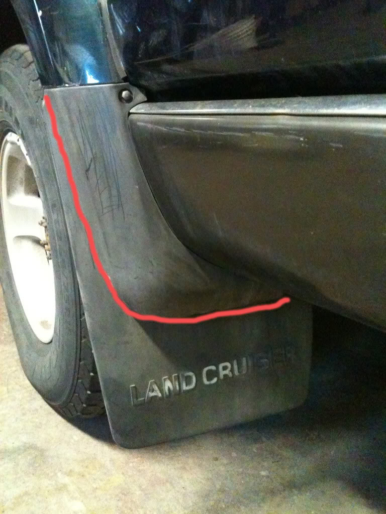

I'm thinking about trimming the mud flaps along the red line in the photo which would turn them into mud 'nubs. The flares, flaps and bumpers are going to get lined black.
Any opinions about trimming the flaps? I'm not sure if I'll like the look or not although, either way, they'll be covered with liner.

I trimmed the flaps before I removed my flares. I liked how it looked. Still got hung up and popped a flare off though .
Backing against rocks can cause the flap to get sandwiched with the tire applying pressure downward. That causes the flap and flare to pull away. I think that is probably one of the most common ways that flares get damaged.
I trimmed my flaps by 2" and never had that problem again. Trimming at the red line should work dealing with that problem, but I am sure that it is possible to cause damage in other ways...
