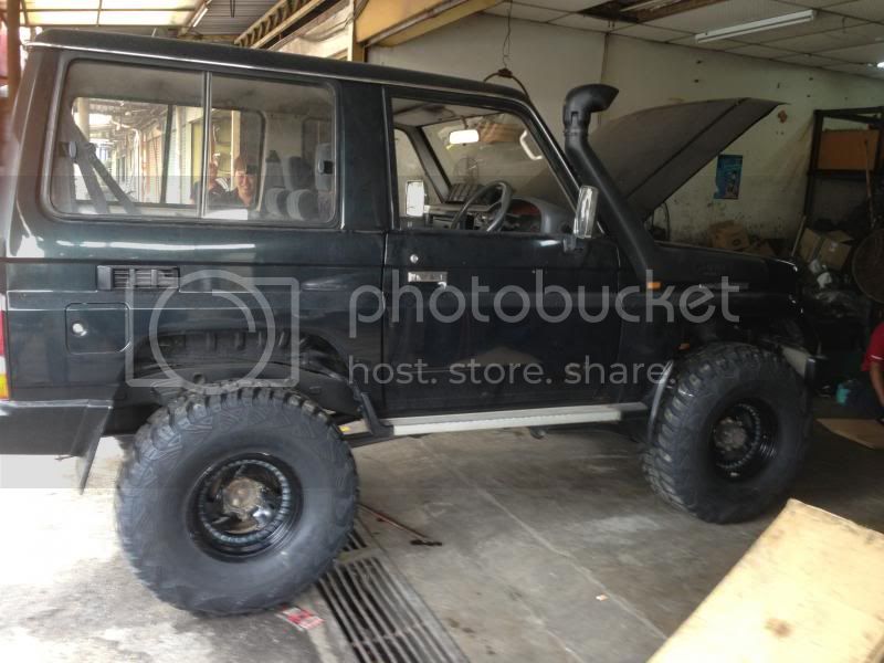

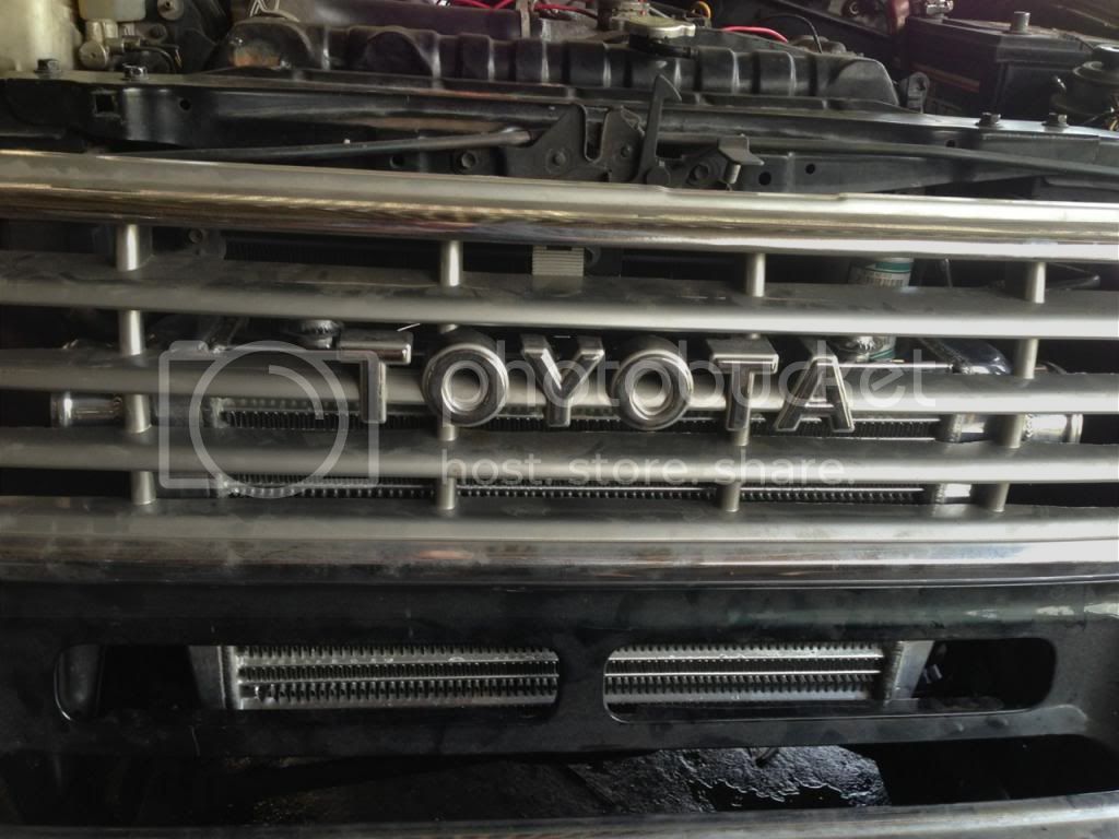

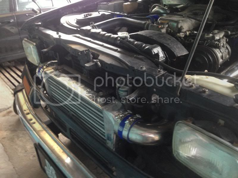

Suspension installed and intercooler.
Intercooler:

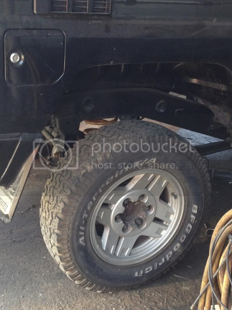

Original tyres and rims look a little small now:

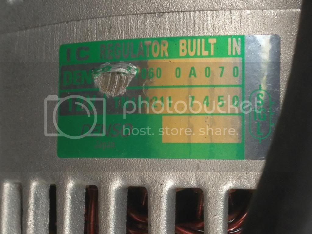

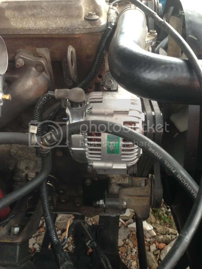

Alternator installed, 120A:

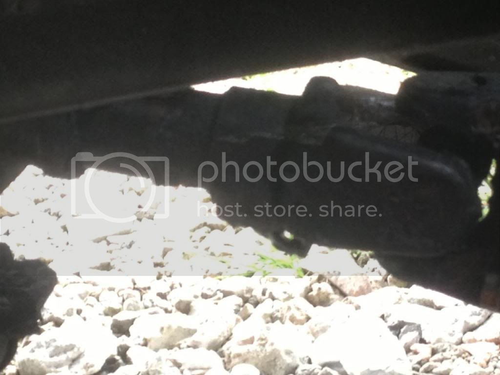

Front and rear drive shafts fitted:

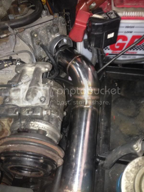

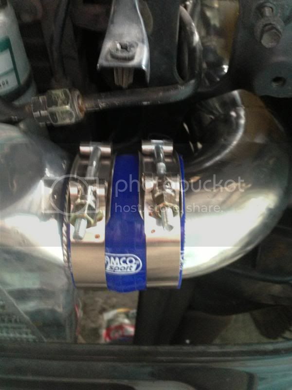

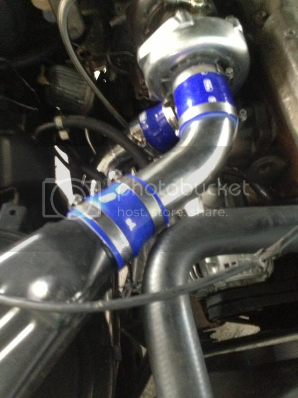

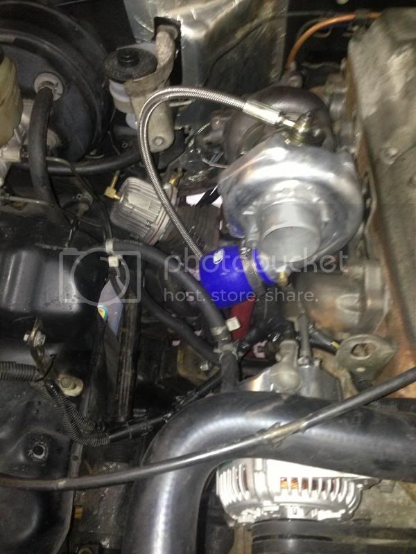

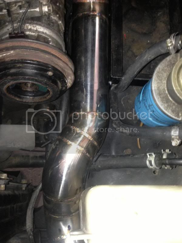

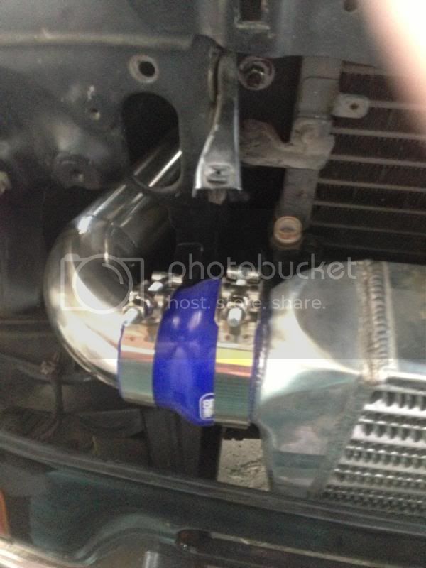

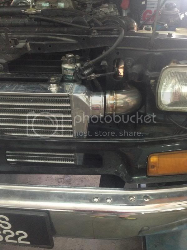

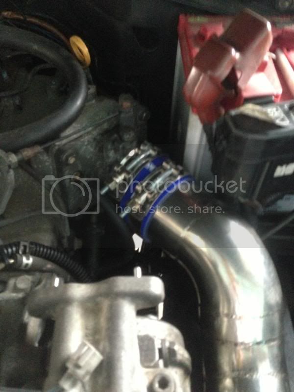

Few piccies of the in progress intercooler piping:
Intercooler and piping completed:

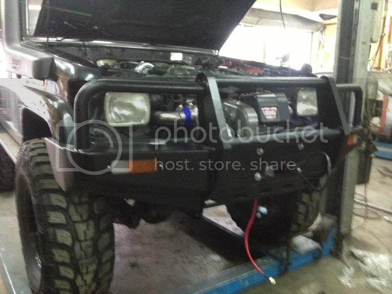

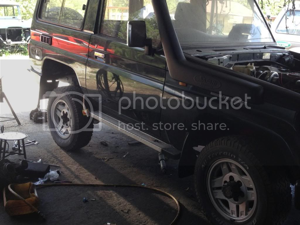

Fitted 35" MT's:

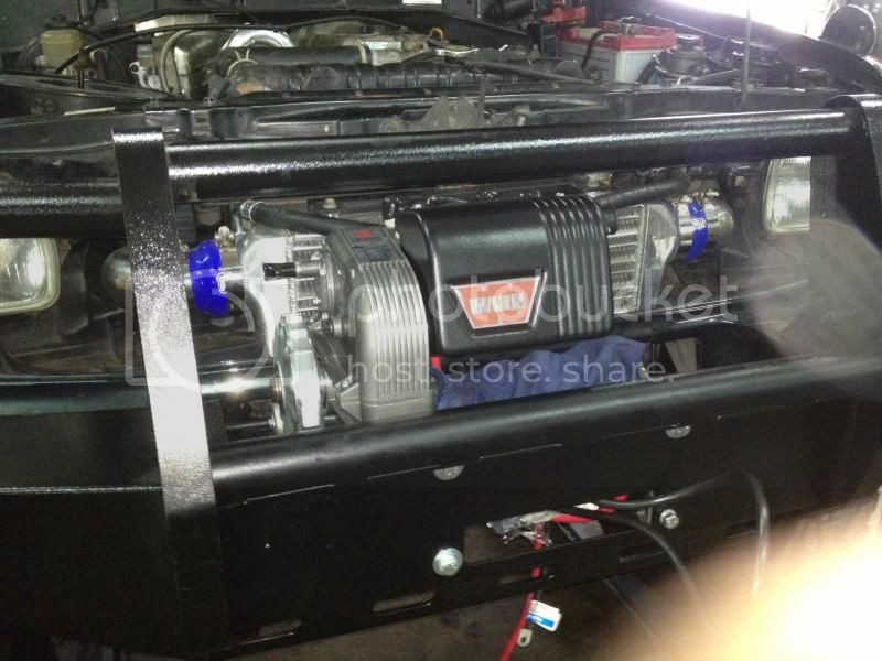

Finally decided to go Warn 8274. Ordered.
8274 Installed:
