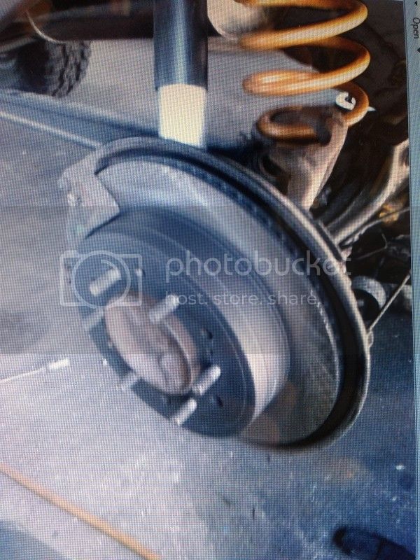

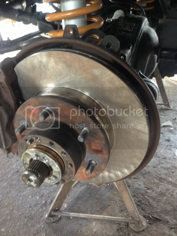

Fitting new original discs all round:
Another test drive today for a few km down the back roads.
New discs and brakes are working well and now have stopping power!

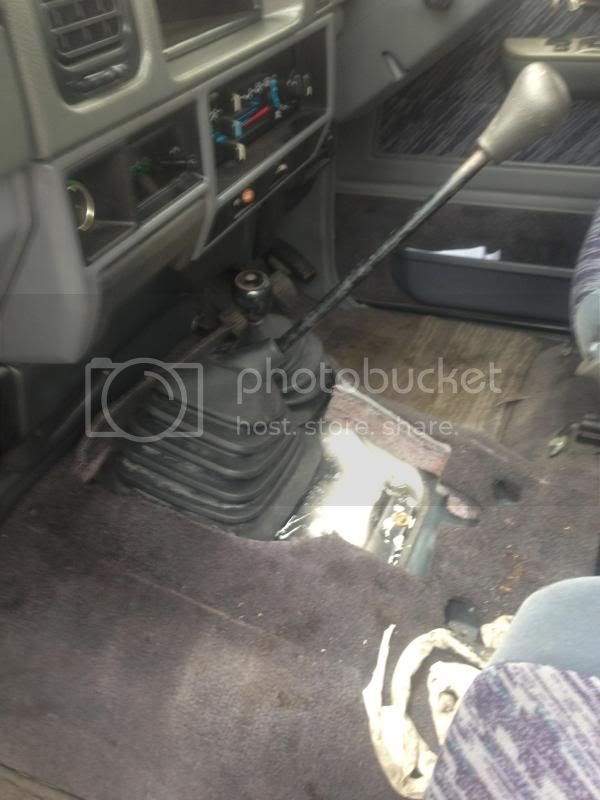

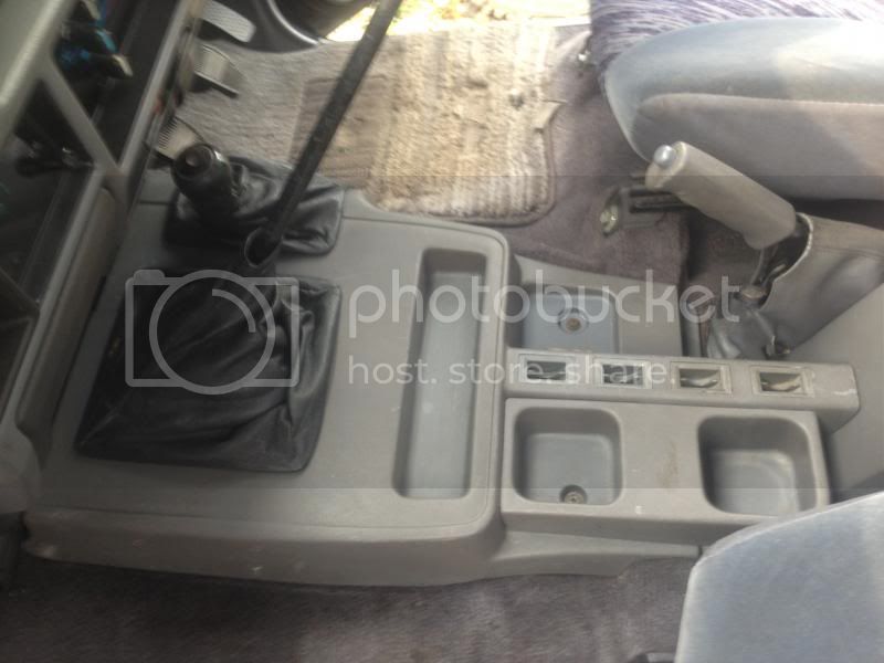

Fitted 75 series centre. Before and after:

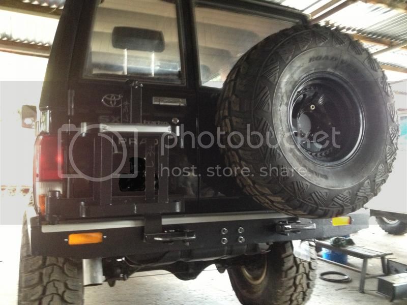

The standard issue tyre carrier was not up to the mark for a big 35" MT spare tyre.
Good excuse to install one of the famous Malaysian 'ah Lau' rear bars...
That does not happen in a shortie hahaha.
