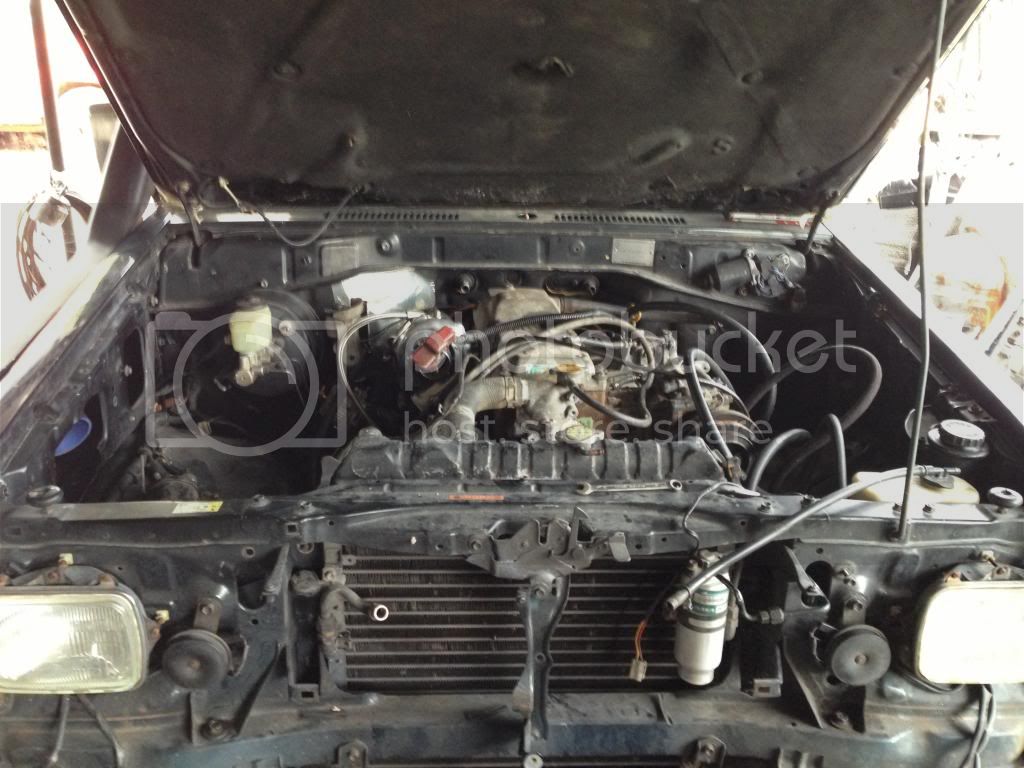

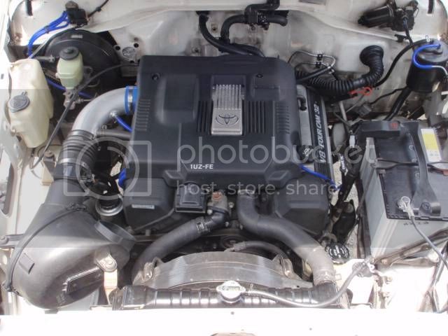

Proves the 1uz can fit into the lj without needing to change the front end.
hzj79lee, you are making me cringe;)
Did LJjuz made u interested in chopping rear end? It looks so adorable and agile like a deer! :p
Radiator is from a 22r engined lc.

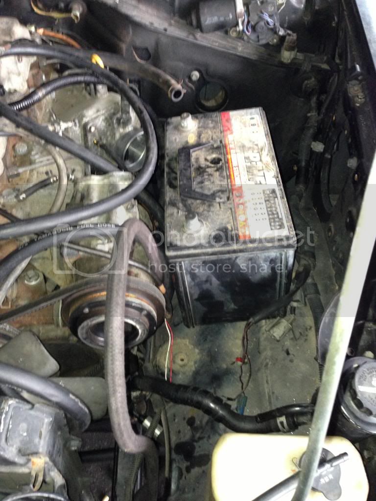

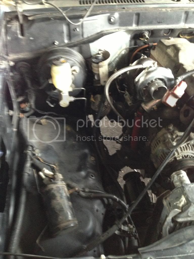

One little problem is how to mount 2 batteries?
Options are:
1. Move air con compressor...
2. Mount 2 batteries and bash the wing panel..
3. Just mount 1 battery
The other side does not have anyroom as the air filter will be mounted there:

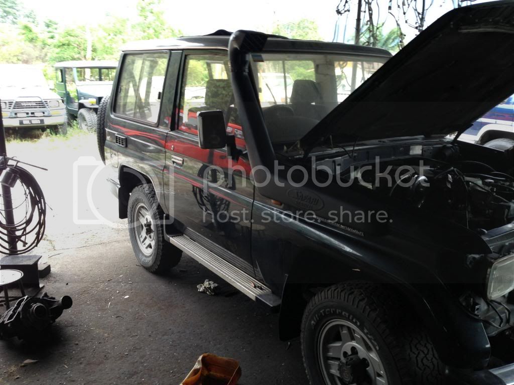

With the wings and bonnet back on looks like a lc again:
Major jobs left to do:
1. Exhaust
2. Drive shafts
3. Install the 4" suspension
Options are:
1. Move alternator...
Is there room under the floor somewhere to mount a battery? I'm thinking I'll have to do this with my bj73 when I put the 12ht in there, turbo is on the same side as the battery and I want to put a bigger air filter in that side
Only way I can forsee is to use a shaped gell type battery like an optima.
Yeah that would be the most likely way around it, is there any room under the floor to make a recessed cavity for it? I think ive seen someone do that on the forum in a bj73/74. If i can fit it i wouldnt mind having a single battery for the whole car but have one of those big truck batteries.

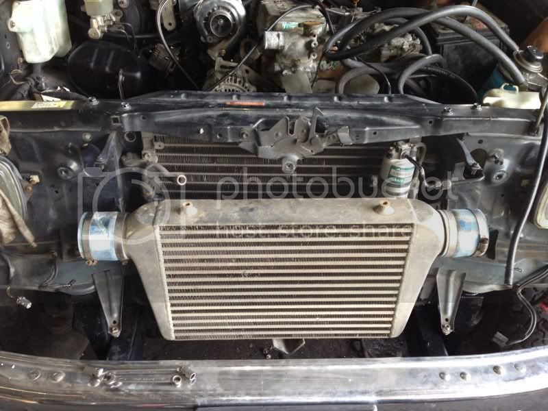

Intercooler being positioned;
