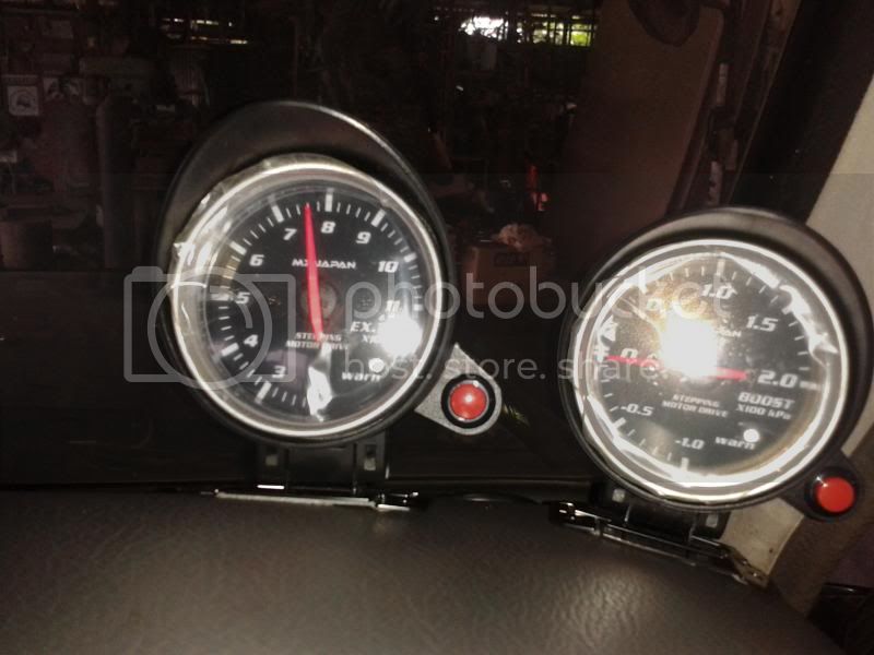

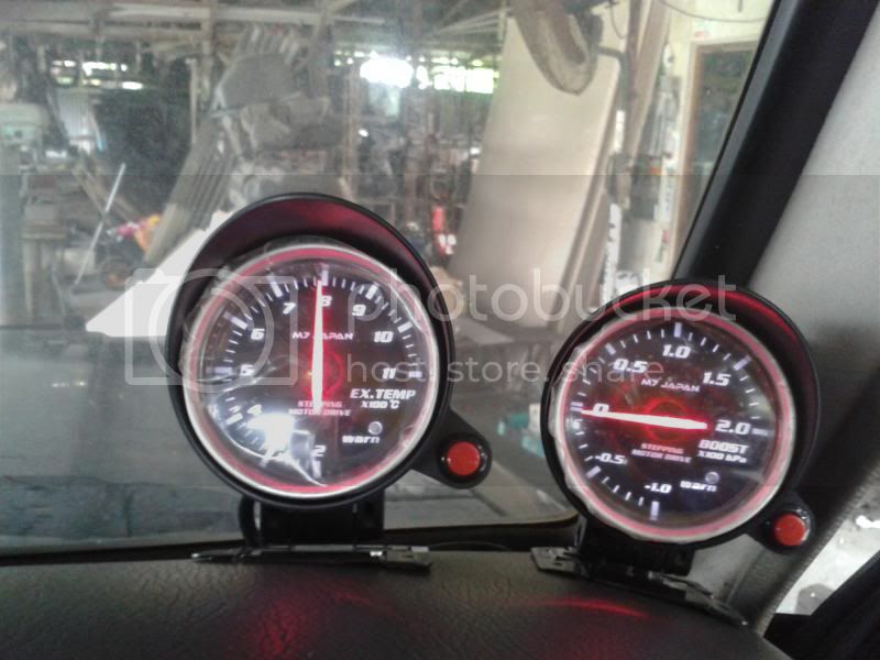

EGT and boost gauges installed.
The EGT running at 750DegC on start up and 800DegC after a little easy revving:
The probe is mounted before the turbo, on the manifold.
Sounds very very wrong
Don't know.
However I do know from my work enviroment, where there are big desiel generators, the temperature at the inlet of the turbo can be around 1100degC, output around 550degC. During normal running operations at 70% load.
Any one else??
I have a infra red heat gun sensor at work. Will try read the temp with it.
I was just reading an article on google. The table at the bottom of the page is very interesting. Sort of tmperatures I am use to.
http://www.dieselpowermag.com/features/0607dp_exhaust_gas_temperature_basics/viewall.html
