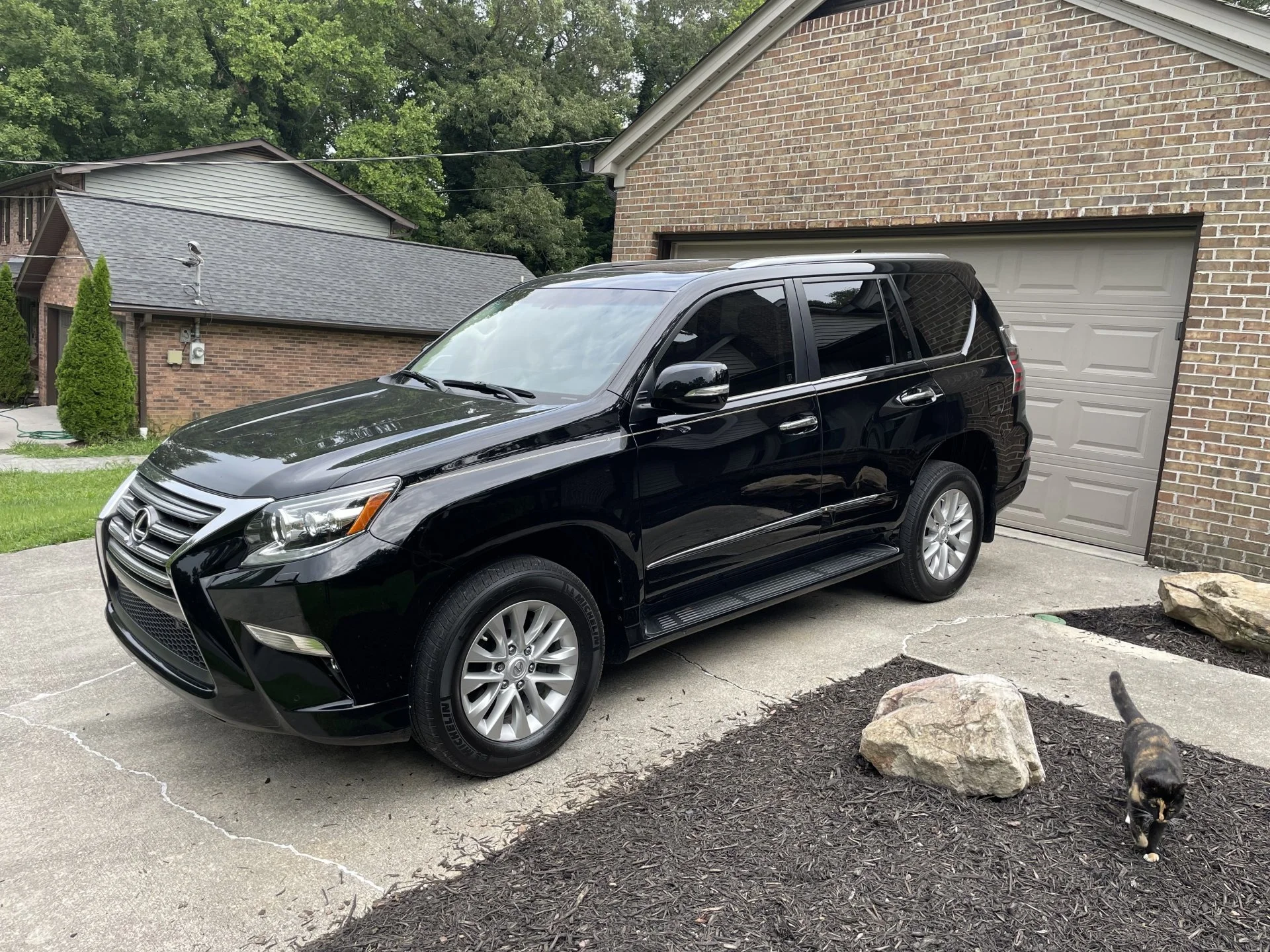

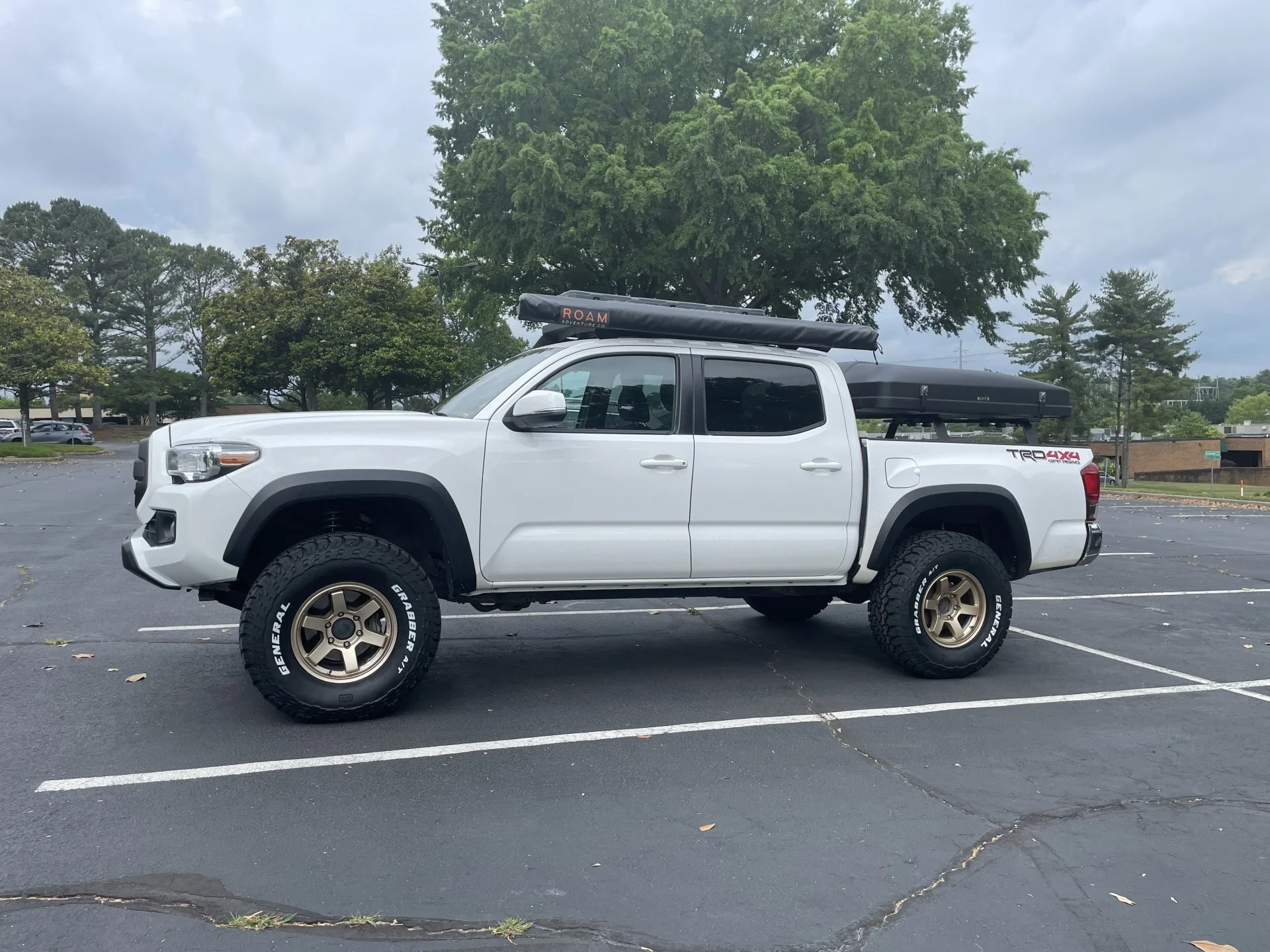

Kids. They make you trade in your beloved Taco for a GX460 because there's no room in the back. Honestly, after a week I wish I had made the move sooner.
Here is what I had:
And now I've got:
Here's my question: can I fit a true 33" tire with stock suspension if I do a BMC, front / rear bumper trim and remove running boards? Want to go with a 17" wheel and whatever offset will help the most. I will be upgrading the suspension but I need tires very soon and with a Prinsu rack and Dometic fridge / slide on the way it will be a couple months till I can order a kit.

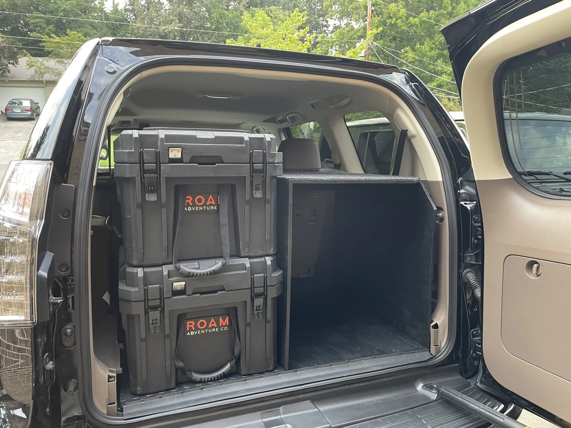

Doing some test fitting of my “storage” solution for the rear. The Roam cases fit like a glove! We are ordering a Dometic CFX3 55 w/ slide for the boxed area. I’ve got a 6 gallon water tank w/ powered pump going behind the fridge and I’ll be running the power switch and hose connector to front of fridge area for easy access.
That's looking pretty good! Do you have slide rails yet for your refrigerator? You'll need long rails and a heafty base securely attached to your floor board if you plan on sliding your fridge out for access.
I was close to just doing a DYI slide but the Dometic one wasn't going to be much more than some full extension locking drawer slides.

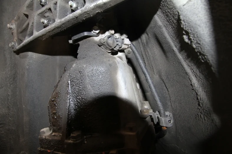

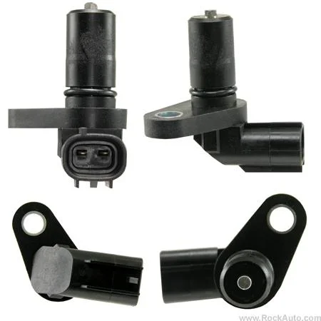

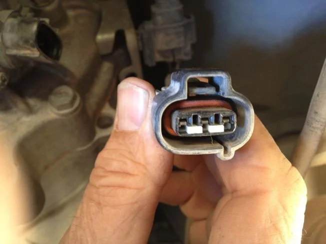

Back on 13 August 2019 Yellow box replied to an email I sent them (note: I have not purchased and do not know if it works):
Hello Richard,
I am so very sorry, I missed your email.
Yellow Box is likely compatible with your Lexus, first we would need to confirm the type of speed sensor used.
Attached are some photos if your Lexus has this same 3-pin plug set at the Output Speed Sensor, then Plug-n-play Harness is available. The Output Speed Sensor is typically located on the transaxle/bell area of the transmission.
If your Lexus has a "2-wire/2-pin" Output Speed Sensor then it will require "2-wire" unit and Splice Harness only.
Thank you.
Best regards,
jennifer
Yellow Box Speedo Recalibrator - Correcting speedometers worldwide since 1999.
website: www.YellR.com
email: staff@YellR.com
These are the photos they attached to the email:
